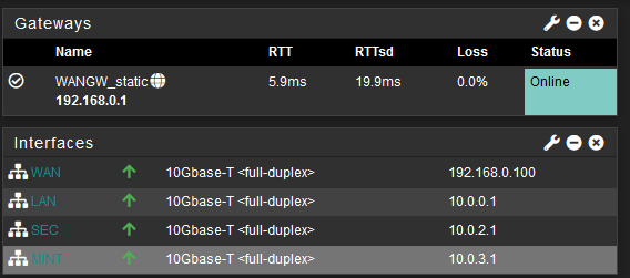

      The interfaces:
      It's not a 10G network, only 1 PC has that capability so I don't know why it's showing it for everything.
      I have no idea what to look for, is it the invalid arguments? Anyone have any ideas? It would be greatly appreciated.

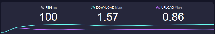

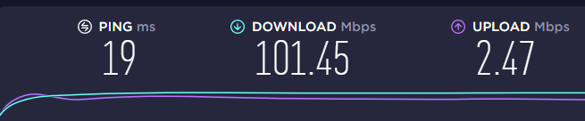

                  I also can't get any better than about 17Mbps through pfsense, it's been like that for some while. My connection is 100Mbps and I can get that through the cable modem. The PC I'm running virtualbox is about 6 years old but it's an Intel® Core™ i7-5960X 8-core beast for its time. Previously had a similar setup, with the same Intel quad-NIC on a really old, like 2007 or so, Intel Core i5-2400 4 Core Processor, with pfsense on one of two VMs and it had no problem keeping up with 100Mbps. I have no idea if these problems might be related. Any idea what could be limiting the bandwidth on the newer faster machine?
                  “The greatest enemy of knowledge is not ignorance, it is the illusion of knowledge.”
                    A bandwidth throttle that bad is usually something at layer 1, like a bad cable or a mismatched speed/duplex. Check Status > Interfaces for errors/collisions.
                    You should be able to pass 100Mbps with like 1% CPU use on that beast!

                      I checked everything I knew to check and don't see problems, there are no indications of errors on the interface status page. Unfortunately, pfsense has gotten completely screwed up. The web configurator started not completely loading, the version and cpu usage on the dashboard never finished loading and the right of 3 columns just wasn't there. After that went on for a few hours, not the web page isn't coming up at all. If I ssh in, everything looks OK, but if I try to see the log, it never finished loading, it gets to about 6 hours ago and stops, but after a while, the connection dies. I can see the log on the terminal in the VM terminal for pfsense and it says the client timed out. For some time, the system has just seemed slow, more than just the bandwidth, the web pages started getting really slow to appear. Just now, when I was trying to get see the system log on SSH, it was getting sent ridiculously slowly, like 20 or so lines would show, then a pause and some more, and it continued like that until it just gave up. If I run top, the machine is almost always showing 98+ and usually 99+% idle.
                      I restored to about 2 weeks ago and all this new crap went away. Don't have any idea what might have happened, the only change I think could have screwed things up that bad was I unchecked the 3 disable hardware checksum, TCP segmentation , and large receive offloads in advanced setup, but it ran OK for some time after doing that. And, I'm still stuck at 18-19Mbps.
                      I'm just more confused. All of this BS and nothing fixed except stuff that wasn't broken when I started.
                      Well, this is where my reserve will-to-live starts to deplete to scary levels. I hadn't checked the cable from the cable modem to the NIC on the PC running pfsense VM so I unplugged it from the WAN and plugged it into the LAN NIC and it worked, got 105Mbps, so I switched the cables back and now the LAN isn't working. Aaaarrrggghhhh. It's like it isn't there on the network. A network scanner doesn't see it, but it sees the PC running the VM, but that PC isn't seeing it. The pfsense console says it's up, ifconfig says it's up and active and OK, the switch it's connected to says it's up and has the right speed, but I can't get to the web pages, can't SSH. I've rebooted pfsense 3 times now and still nothing. I'm at a loss, can only think of a hardware issue in the Intel quad NIC at his point.

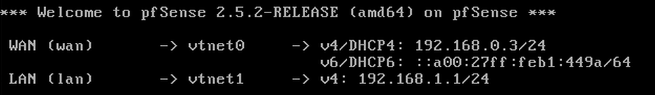

                          That was just testing the cable, that it wasn't causing the throttled bandwidth somehow, so it was like you said, I just unplugged LAN to switch cable, took cable from WAN to cable modem and connected it to the LAN port, which was now connected directly to the cable modem and could act like a normal connection, the pfsense VM would be out of the picture. Then did a quick ookla speedtest and it went to over 100Mbps so I just reconnected everything to what it had been before.
                          That's when pfsense and the rest of the network stopped communicating or whatever it was doing. I can see the PC running the VM, it's on 10.0.0.88. I can run NIRSoft Tools Wireless Network Watcher, they have a lot of great tools for windows, and it sees 10.0.0.88 but not the pfsense VM which is on 10.0.0.1, which is supposed to be bridged to the LAN, I should see both IPs in the scanner. So, I can't SSH or use the web page because the rest of the LAN can't see 10.0.0.1. BUT, at the console, ifconfig says everything is up and running just fine. I did nothing to pfsense, I only switched the cables and switched them back. I rebooted pfsense a few times, rebooted the PC running the VM, and no change.
                          I'm not savvy enough to do much troubleshooting with only the console, I wouldn't even know where to begin when it's saying the interface is up and running but everything else isn't seeing that at all. So I got disgusted and just threw one of my routers in and said screw it for now, I had a lot of things to do and needed my network to be functioning. I hate it when I'm not connected through pfsense. it makes me feel naked, vulnerable, and blind.
                          I really appreciate your trying to help. I'm thinking maybe it's a hardware issue but I will need to dick with it some more, just haven't had the time.

                                mechtheist @stephenw10
                                @stephenw10 It's a little late, I've been distracted. I decided to just do a fresh install, hoping maybe some setting was off. After installing and almost no configuring at all and only WAN and LAN, I fired it up and it made a huge difference, instead of getting only about 17Mbps on a 100Mbps bandwidth internet connection, I was now getting a whopping 1.6 to 1.8 Mbps! I've checked as well as I know how to find some mismatch in the settings and can find nothing. I got disgusted and swapped my router back in. Using the NIC directly on the PC that was running pfsense with pfsense not running, I can get the full bandwidth, so it's not some problem with the NIC. If you or anyone else has any ideas I can swap pfsense back in easily enough to try them out but otherwise, I'm going to put it aside for now and when I have more time I can try it again, maybe start a new thread if the problem persists. Thanks for you help, it's been appreciated.

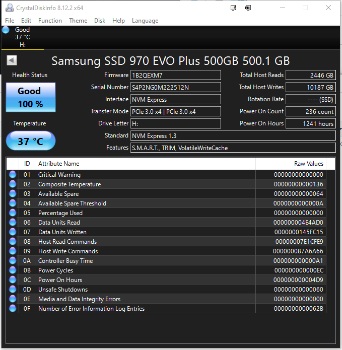

                                      This looks like a hardware issue to me. Check the storage device on the system that hosts your VM. Check the system RAM as well. The fact that you reinstalled pfSense, and you had those issues where CPU load status indicator is not loading, is leading me to belieive there might be something wrong with your hardware. We already know that NIC is fine, thats one thing ruled out, check everything else. Verify your VM settings as well. There could be an update that reverted your CPU/RAM/Storage settings for your VM. Its pointless looking for an issue in pfSense until the host system is not checked.
                                        Hmm, this seems more like VBox issue to me.
                                        Can you try running in Hyper-V instead?
                                        Or, better, running bare metal as a test?
                                          mechtheist @nimrod
                                          @nimrod said in Some hosts aren't connecting to the internet but others are:
                                          @mechtheist
                                          @stephenw10 said in Some hosts aren't connecting to the internet but others are:
                                          I've had this problem for many months and looked but have never found anything that I could determine to be a possible cause in pfsense or the PC. It's weird that doing a fresh install and little configuration dropped the already low bandwidth by a factor of almost 10, from about 17Mbps to about 1.7 Mbps. I have v v little experience with Hyper-V and none with any other VM software but I was starting to think about trying Hyper-V . For about 6 years at least I've done this with VirtualBox and had no real problems, pfsense just worked, it's always kinda amazed and really impressed me.
                                          That said, a couple of hours ago it crashed, below is the report copied off the web page, I don't even remember getting one of these before and definitely don't have the knowledge to understand what it's telling me, anything stick out to you guys? I don't know how to fix the nonprinting characters, sorry.
                                          Had to cut a lot out, too long, so attached file. Thanks for all the help!

                                            1. Did you check VirtualBox VM settings ?
                                            2. Did you test system RAM on the machine that hosts your VM?
                                            3. Did you check the storage on the machine that hosts your VM/VM Images and OS ?
