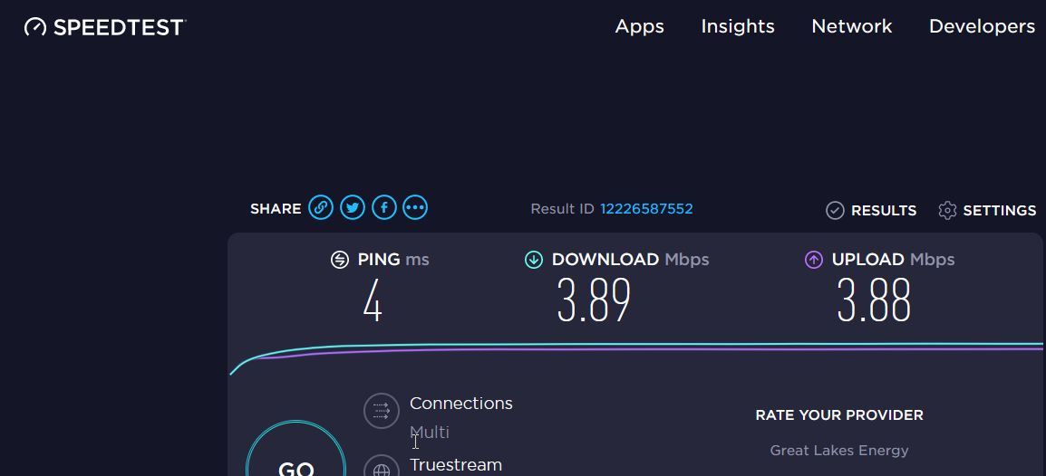

                  I'm sorry my previous comment of 200Mbps on the DMZ port was incorrect. I've recently upgraded from cable to fiber and my LAN connection is 200Mbps (and WAN). I guess I didn't specifically check the DMZ port. But it the past it has been the max speed of the cable which was ~100Mbps. I could stream video off the DMZ but I can't any longer. This is what I get with speettest.
                  What does the port at the other end show?
                  At the other end of the DMZ portCAT5 cable? If I plug my laptop directly into the DMZ port on the back of the pfSense box or at the end of the DMZ cable that is plugged into the ASUS router I get the results shown above.
                  This is what I'm getting out of the LAN port. Nice ping huh! Ran it again and got a 1ms.82c3194e-e3e8-4abd-bec1-d523ad9ffb22-image.png

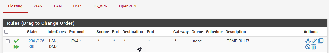

                              I've added the following floating temporary rule and I can ping from the DMZ (192.168.31.196) to my desktop (192.168.30.204), but I can't ping from my desktop back to the notebook computer on the DMZ.
                                The notebook in the DMZ may be blocking it.
                                Really though the only things that can be causing this in pfSense are a low level network issue, but that looks OK, or traffic shaping. So do you have any shaping configured? Either Limiters or AltQ?
                                If not then I'd be looking at the other equipment in the path, so the AP or any switches. Try connecting the notebook directly to em2.
                                TAC57T 1 Reply Last reply Reply Quote 0

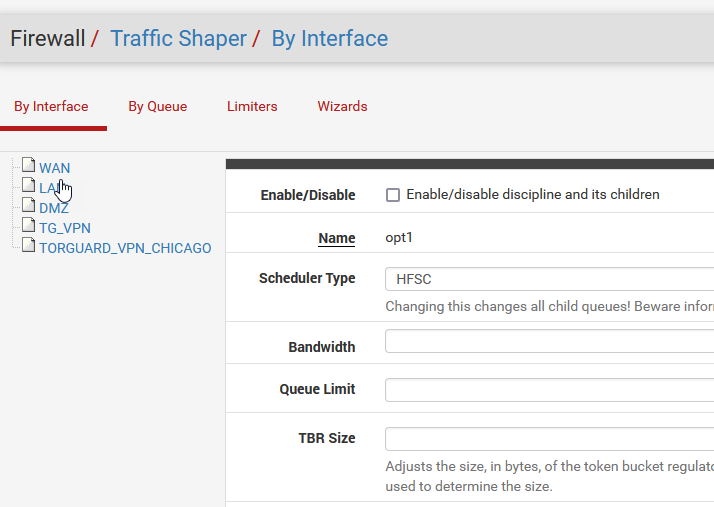

                                      I've never messed with shaping, but where should I double check that?
                                      • TAC57T Offline
                                        TAC57 @TAC57
                                        This looks good, this is the DMZ interface.

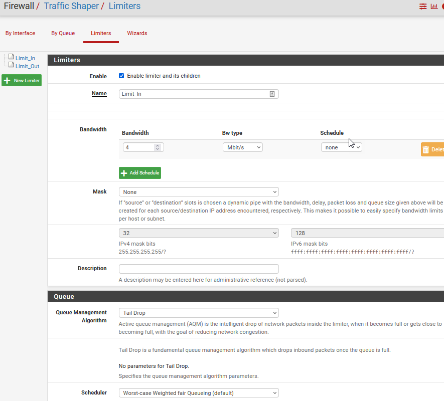

                                          Check the 'By Queue' tab and make sure there are none. Then check the Limiters tab and make sure none show there either.
                                          Next test I'd do would be running iperf on pfSense itself so you're only testing one NIC. There is an iperf3 package you can install to do that.
                                          However this all points to some hardware commonality.
                                          TAC57T 2 Replies Last reply Reply Quote 0
                                          • TAC57T Offline
                                            TAC57 @stephenw10
                                            By Queue was blank
                                            Limiters | Limit_in and Limit Out were both enabled. I have no idea why. I'll uncheck the Enable button on both and see what happens. Where would these settings be tied to the DMZ interface?
