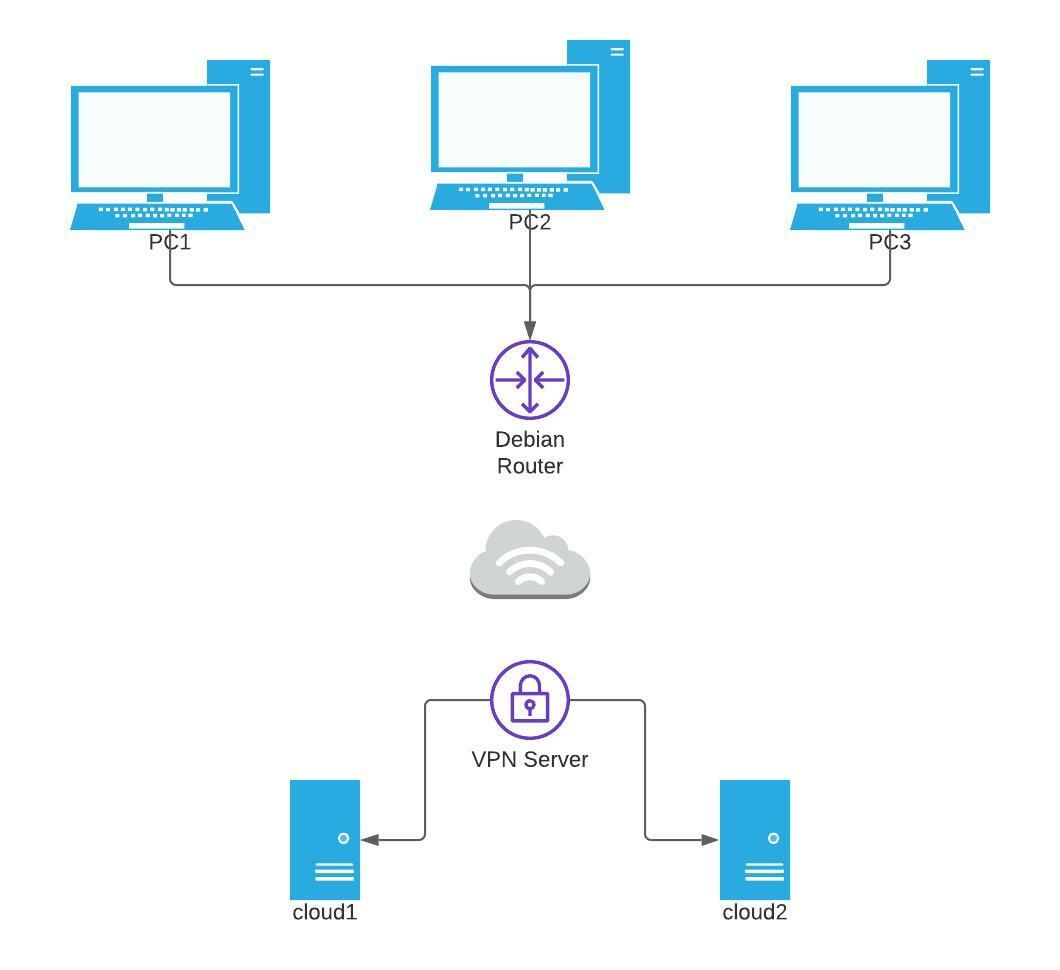

          conejero @viragomann
          @viragomann as far as I can tell, the Debian openvpn server is working properly. I have another Debian server setup in a different remote office. This Debian server (debian2) connects to the Debian VPN server, once connection is established, all PCs on the LAN side of debian2 can access the servers on the LAN side of the Debian VPN server.
          This works fine with the debian2 server. PC1 can connect to cloud1 and to cloud2. The same setup with a pfsense router does not work.
          With a pfsense router, the router itself is able to connect to the vpnserver, cloud1 and to cloud 2. However, PC1, PC2 and PC3, whose gateway is the pfsense router, are not able to connect to either the vpnserver, cloud1 or cloud2.
          Are there any instructions as to how to setup this connection? Openvpn Client to route traffic to the VPN network for LAN devices. I am most likely missing something. This is what I have done.
          1. Setup the VPN client connection. VPN/OpenVPN/Clients.
            Server mode: Peer to peer (SSH/TLS)
            Protocol: UDP
            Device mode: tun
            Interface: WAN
            IPv4 Remote network(s) 10.8.44.0/24
          It might be noted, there is no VPN interface asssignment setup. I do not know if this is important or if it has to be manually created.
              @viragomann answering your questions:
              Are both VPN endpoints the default gateway in their local networks? Yes.
              Did you configure the iroute for the client properly on the Debian server? Yes.
              I do believe NAT is needed though.
              LAN PC on network 192.168.23.0/24 --> gateway pfsense router.
              cloud PC on network 10.8.44.0/24 --> gateway debian vpn server.
                conejero @conejero
                Solved.
                We informed the openVPN server running on Debian about the LAN behind the pfsense with iroute stanza in /etc/openvpn/ccd/ and it can access the cloud pcs now.
                Thank you
