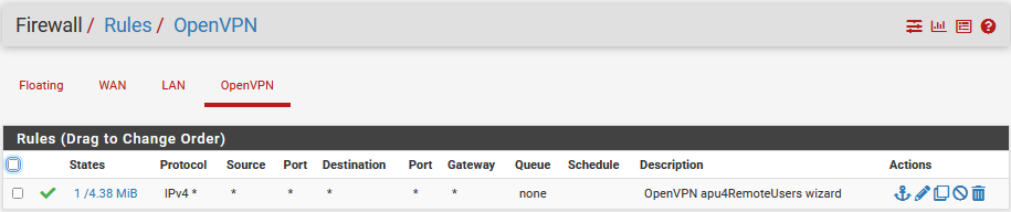

      I auto-generated the firewall rules when setting up the VPN server. Here is what they show.

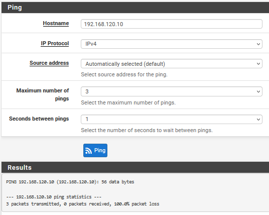

              This is getting weird now. Using the default diagnostic ping settings (source address automatically selected) to ping the host 192.168.120.10 (the TrueNAS box), I get a response of 0 packets received.

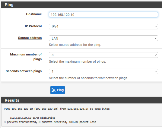

              Changed the source address setting to LAN, and I get a similar response.
              Not sure what is going on now. Pinging from .2 to .10 in the same subnet is not getting any response. Now I am stumped. Where should I look next.

                By default pfSense chooses automatically the interface IP which is facing to the destination device as source IP.
                Since your NAS is in your LAN subnet this should work at least with LAN, when it responses to ping generally. If not check the network settings on all involved devices.

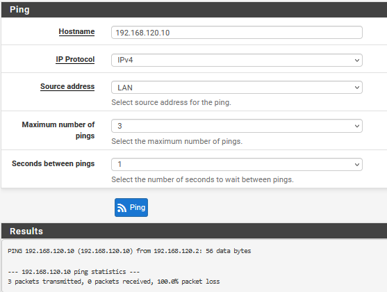

                  @viragomann Ok, I figure I had to have made an networking error somewhere between these two boxes, but I can't seem to find it looking at all the GUI's. I just powered down both boxes for a few minutes, then first powered on the gateway box (PCEngines APU4). After connecting my laptop to it to make sure it was fully up and functional, then I powered on the TrueNAS box.
                  Now from the gateway box (192.168.120.2) I get this :
                  Changing the source address to LAN, I get this :
                  Trying to ping back to the gateway from the TrueNAS box (192.168.120.10), I get this :
                  There is something messed up in the networking, but I can't seem to find it to be able to fix it.

                    Again, check the network settings on all involved interfaces for correct IP, mask and gateway.
                    On pfSense check Status > Interfaces. Possibly there are errors or collisions. Remember there must not be a gateway set on LAN.
                    Also check the settings on the NAS.
                    Do you see the NAS IP in Diagnostic > ARP on pfSense?

                      @viragomann I think I may have solved it. Initial tests are positive, but want to do further diagnostics to be sure. Wanted to post what I found now so I don't forget.
                      I compared the ARP cache tables between the gateway and the TrueNAS box. Both tables showed the correct respective IP addresses for everything. However, in the gateway ARP table the MAC address for the TrueNAS box was incorrect (the IP address was correct). As soon as I deleted the listing in the gateway for the TrueNAS box that had the incorrect MAC address, I was able to ping both directions between the gateway and the TrueNAS box.
                      Thanks for your guidance. I figured it had to be something like this, it was just unfamiliar territory for me.
