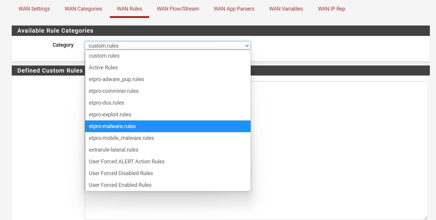

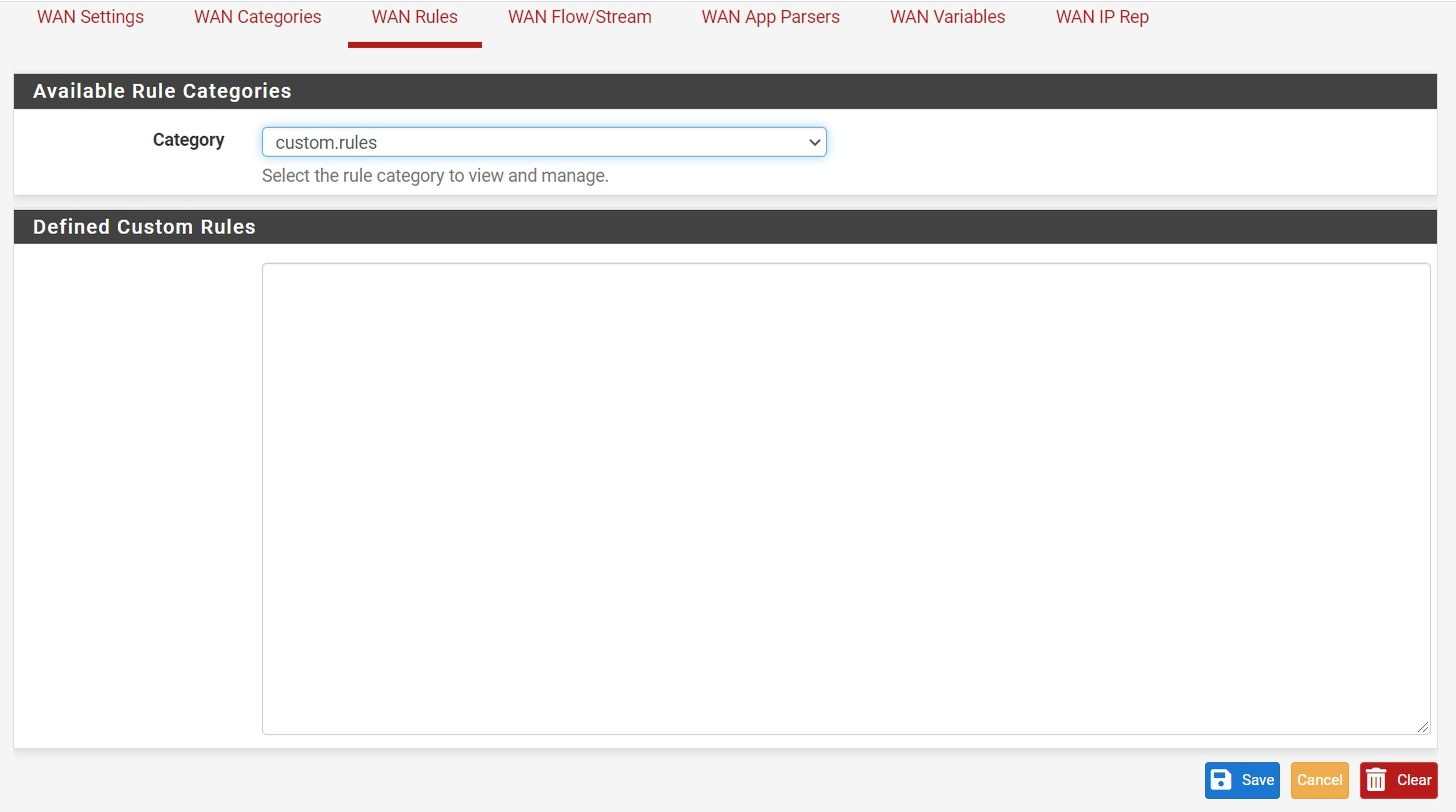

      Hi
      WAN Rules->Available Rule Categories->EX:select et-mlware.rules->it redirect custom.rules
      When I select any rules, It is always back to custrom.rules
      2.5.2-RELEASE and Suricata 6.0.3_3

          The RULES tab when you select category in the listing it , select any rules, it redirect Custom Rules. EX: i select etpro-mlware.rules
          it redirect custom rules, do not show etpro-mlware.rules

                          @bmeeks
                          I find something. My disable.conf have
                          app-layer-events,decoder-events,dnp3-events,dns-events,files,http-events,ipsec-events,kerberos-events,modbus-events,nfs-events,ntp-events,smb-events,smtp-events,stream-events,tls-events
                          remove that
                          It Works. It do not redirect to custom.rules

                            That file is telling the SID Managment code to remove those categories from the list, so that's what it is doing. Those are the built-in rules shipped with Suricata.
                            Check all of your other files carefully. I think you have something non-standard going on in your conf files for SID Management. I still am unable to reproduce the problem on my test virtual machine.
                            And just to be clear, it is not "redirecting" anything. It simply is showing Custom Rules because your SID Management conf file (or files) is telling the code to remove categories, so the only one left to load into the drop-down selector is Custom Rules as that one is a default that cannot be removed.
