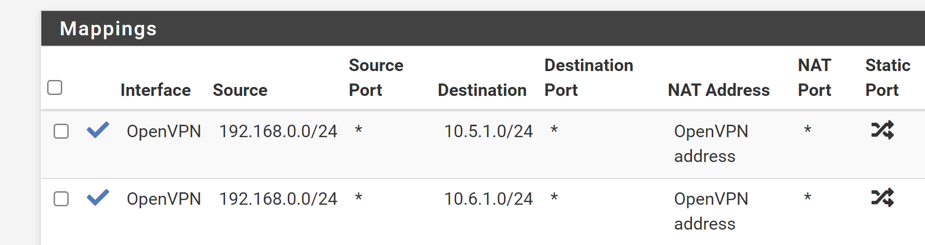

        Do you have defined interface groups?
        What are your outbound NAT rules?
        digininja99D 1 Reply Last reply Reply Quote 1
        • digininja99D Offline
          digininja99 @viragomann
          @viragomann I think that might be it. When I added the second VPN I added a rule matching the first, but they are both on the OpenVPN interface. Do I need to create two new interfaces in the interface assignments tab and then use those instead?
          If I do need to do that, do I need to change anything else when I do it? I remember messing with this a while ago and things broke so I rolled back to just having OpenVPN.
          There are no interface groups defined.

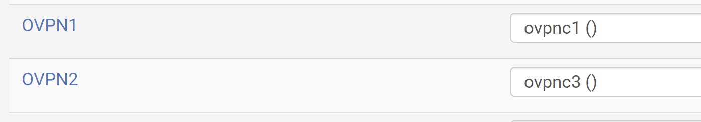

              I just tried assigning two new interfaces and now I have OPT2 and OPT3 pointing at ovpnc1 and 3 but I don't know what to do with them now.
              • V Offline
                viragomann @digininja99
                @digininja99

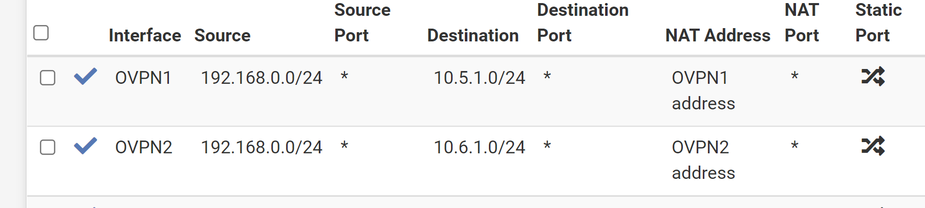

                You to outbound NAT know (masquerading), that means that IPs of request packets is translated when it is going to the remote site.
                However "OpenVPN" is indeed an interface group containing all OpenVPN instances. It is created automatically, when you set up an OpenVPN instance.
                Since it's an interface group, you cannot use it for NAT.
                In an routing environment, the remote OpenVPN server also needs a route to your LAN. If that is given, there is no need for NAT and you can remove these rules.
                If you don't want to touch the OpenVPN server, do NAT and use separate interfaces for both instances.
                After assigning the network ports (ovpnc1,..) open the interfaces and enable them. You may also enter a friendly name, but no IP settings.
                Then go back to Outbound NAT and edit the rules to change the interface to the proper value.

                  @viragomann Things are now broken, but I think they are closer to what they should be.
                  I created the interfaces (forgot to enable them before), renamed them, and enabled them.
                  Set up the NAT rules

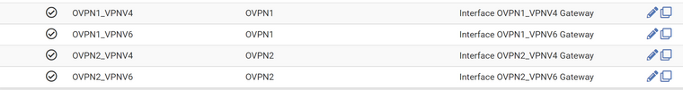

                    If the error persists, check if you have IPv4 gateway for the VPNs in System > Routing.
                    How did you set the routes?
                    digininja99D 1 Reply Last reply Reply Quote 0
                      @viragomann I was told by the interface to restart things, which I did, I haven't rebooted.
                      I didn't setup any routing, what was there was setup automatically.

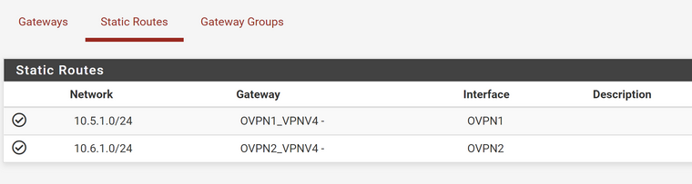

                      In System > Routing, there is no option to set the IP for the gateway, it just says Dynamic on the gateway IP.
                      There was nothing in static routes, so I tried adding one, but that hasn't changed anything, even with this config, the console still says the default gateway for the server IPs.
                      • V Offline
                        @digininja99 said in routing bounces between vpn tunnels:
                        Yes, that is okay. But you should disable IPv6 in the interface settings if you don't need it.
                        No, there must not be added static routes for OpenVPN endpoints.
                        You have to enter the remote networks in the client settings in CIDR notation.

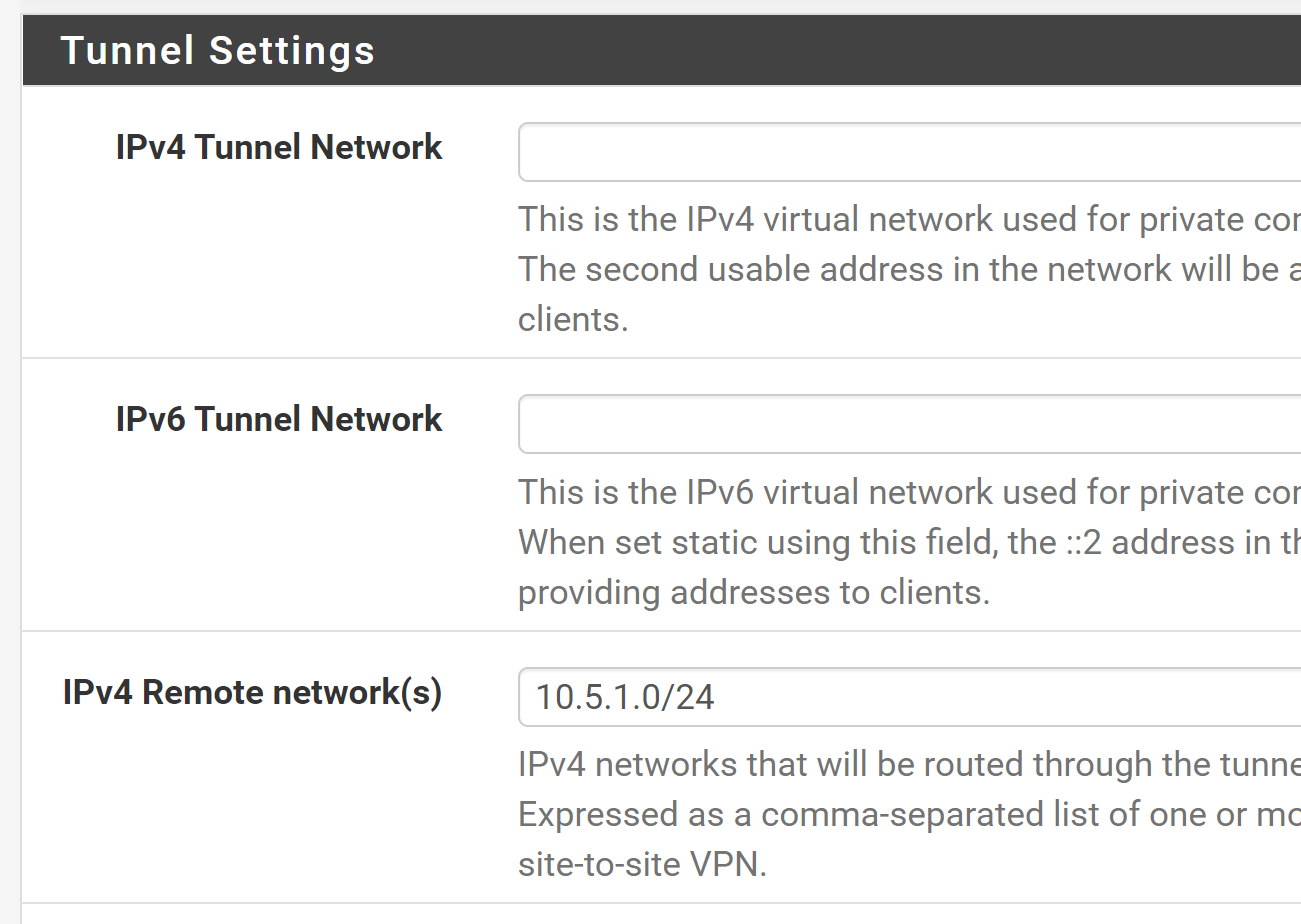

                          @viragomann I've removed the static routes and restarted things.
                          I have this setup in the OpenVPN config for both interfaces.
                          The bit I was missing was the IPv4 Tunnel Network IP, I just put that in and everything seems to be working!
                          I'm now going to back all this up and then grab a copy of this session as notes for if I ever need to add a third VPN.
                          Thanks very much for the help debugging this, it was more complex than I thought, but in the end it all makes sense I think. I'll re-read it all in the morning, it will probably have sunk in by then.
