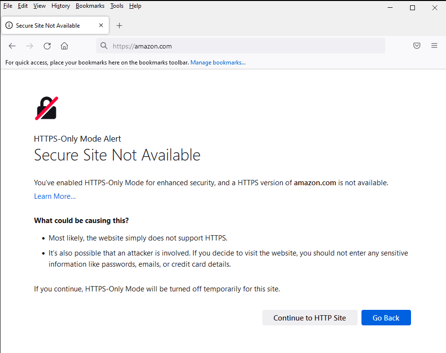

                                  neither are running at the moment because i can't get through to any sites. ddg.com will come up (sorta, but that's also problematic).
                                  i also uninstalled firefox to it's entirety and reinstalled in it's default state.
                                  I used Edge, my gf uses her mac with chrome, it's just really crappy.. if i go to speedtest.net, assuming the page even resolves, i get my full allotted speed. ping times are normal, around 12ms.
                                  i'm wondering if it's comcast... there was an outtage a couple weeks ago when this all started happening.. they got it up and running obviously, but i wonder if there's a config issue on their end with their routing?
                                  what do you all think? this just doesn't make any sense.. i've NEVER had pfsense be so unreliable and problematic. even with all my screwing around, it always JUST WORKS... now its basically unusable..

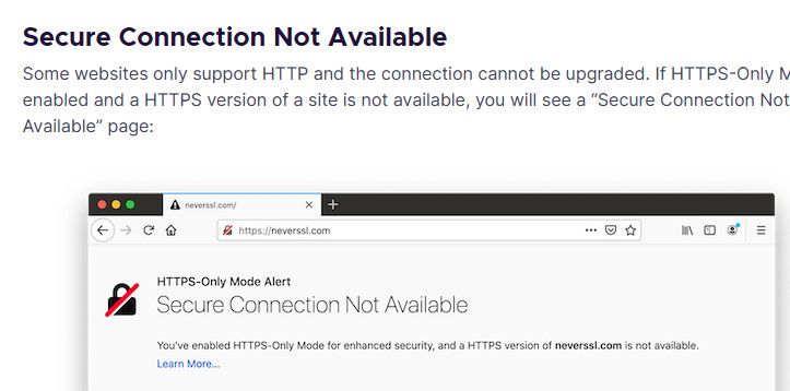

                                    @jc1976 says right there was the problem is
                                    That isn't a pfsense thing.
                                    Firefox setting
                                    https://support.mozilla.org/en-US/kb/https-only-prefs
                                      jc1976
                                      up until lately, i've never had a problem with it. ive had mozilla in https only mode ever since i knew the mode existed. on my pc at work, i have the same settings enabled and it works fine. also, that's just an initial screen. if i put www.amazon.com, the site resolves as it should. and this goes on for almost all sites.
