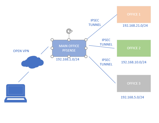

      I have a pfsense firewall and i created many ipsec tunnels with other offices. These connections are work ok. And i created a openvpn server to allow me to access all this equipment from anywhere. Example:
      I give the openvpn address 10.20.50.0/24. When i connect my notebook in network i can ping only devices in 192.168.1.0/24. How i access other devices?

          @steveits so i'm new to pfsense, what rules should i add to the firewall?
          By the model of the network shown in the image, could you give me an example of a rule that I should add?

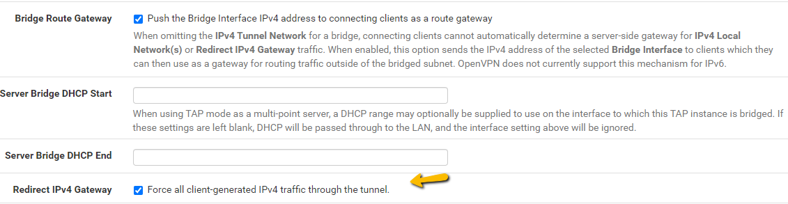

            • F Offline
              felipefonsecabh @felipefonsecabh
              @felipefonsecabh the bridge between OpenVPN and Local Network works after i enabled these options:
              I try to keep the "Redirect IPv4 Gateway" disabled (the address configured as 192.168.1.0/24), but doesn't work.
              It's possible to make it works without pass all traffic throught the tunnel?
