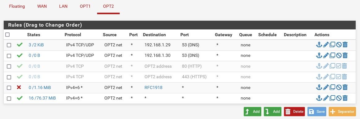

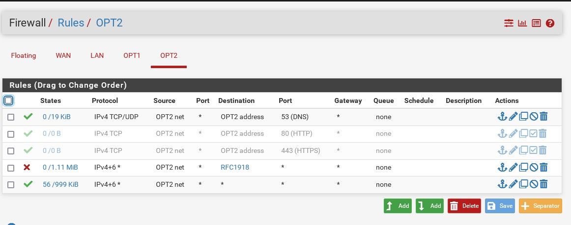

      However, I also have a physical interface, OPT2 and currently, the OPT2 DHCP server has 8.8.8.8 as a DNS solution.
      I have two DNS servers on the LAN which OPT2 devices could use but I've not figured out how to give OPT2 access to port 53 TCP/UDP for resolve.
      I need to add a rule that allows OPT2 devices to access port 53 TCP/UDP for DNS resolve only.
      How do I accomplish this?
      BTW, that last rule, I don't know if it's needed or not. I got that from some other post that said it was needed to allow after blocking. I have it on the OPT1 network too.
        johnpoz LAYER 8 Global Moderator @lewis
        @lewis well if you want to get to the internet - then yeah you would need that last rule ;)
        As to getting to lan address for dns, just like your top rule there. Create a rule before your block rfc1918 rule that allows access to your lan address for dns.. Not sure why you would need that if your already allowing access to opt2 address for dns.
        But if you mean some other address on lan, or then pfsense lan address - then yeah just put that rule above your block rfc1918 rule.
        • L Offline
          lewis @johnpoz
          @johnpoz
          I must have been testing while having another rule wrong because doing as you said works. I replaced the opt2 dhcp dns servers with the lan ones, added two rules, restarted devices on opt2 and it all works now.
          Here's how it looks.
