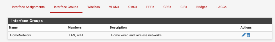

        • Interfaces: WAN, LAN
        • VLANS: WIFI, IOT
        • Interface Groups: HomeLAN (LAN, WIFI)

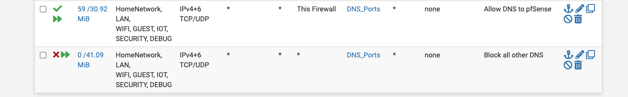

        I am running pfBlockerNg (devel, which is configured for all interfaces. Here are some images of my rules:
        Floating
        Debug Rule (same for both HomeNetwork and IOT)

                  What is the order of firewall rule execution? Floating then interface-specific? The 2 debug rule I posted (specific to each interface) are the first rules in those lists.
                  The DNS_Ports in the floating rules are: 53 and 853.

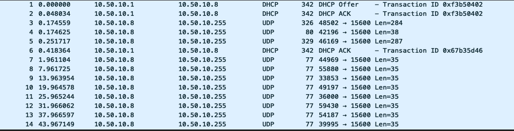

                              The Packets Captured window shows:
                              12:23:07.112290 IP 10.50.10.1.67 > 10.50.10.8.68: UDP, length 300
                              12:23:07.160324 IP 10.50.10.1.67 > 10.50.10.8.68: UDP, length 300
                              12:23:07.286849 IP 10.50.10.8.48502 > 10.50.10.255.15600: UDP, length 284
                              12:23:07.286915 IP 10.50.10.8.42196 > 10.50.10.255.15600: UDP, length 38
                              12:23:07.364007 IP 10.50.10.8.46169 > 10.50.10.255.15600: UDP, length 287
                              12:23:07.530654 IP 10.50.10.1.67 > 10.50.10.8.68: UDP, length 300
                              12:23:09.073394 IP 10.50.10.8.44969 > 10.50.10.255.15600: UDP, length 35
                              12:23:15.074015 IP 10.50.10.8.55880 > 10.50.10.255.15600: UDP, length 35
                              12:23:21.076244 IP 10.50.10.8.33853 > 10.50.10.255.15600: UDP, length 35
                              12:23:27.076868 IP 10.50.10.8.49197 > 10.50.10.255.15600: UDP, length 35
                              12:23:33.077534 IP 10.50.10.8.36000 > 10.50.10.255.15600: UDP, length 35
                              12:23:39.078352 IP 10.50.10.8.59430 > 10.50.10.255.15600: UDP, length 35
                              12:23:45.078887 IP 10.50.10.8.54187 > 10.50.10.255.15600: UDP, length 35
                              12:23:51.079439 IP 10.50.10.8.39995 > 10.50.10.255.15600: UDP, length 35
                              This is from WireShark:

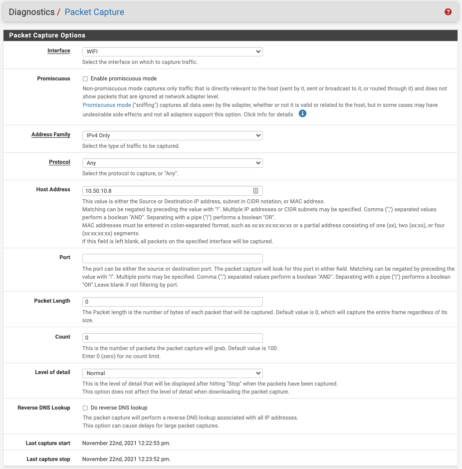

                                  I was running pcap from the pfSense.Screen Shot 2021-11-22 at 1.49.30 PM.png
                                  I performed the following:
                                  • Launched pcap using config above
                                  • Turned TV on
                                  • Ran connectivity test
                                  • Waited for connectivity test to conclude
                                  • Turned TV off
                                  • Stopped pcapping.
                                  This is the output with full level of detail:

                                      • stephenw10S
                                        Your screenshot above shows the pcap on the "WIFI" interface. It that correct? That's confusing me if so.
                                        • D
                                          dimaj @stephenw10
                                          yes, as of now it is correct.
                                          WIFI = VLAN ID 10.
