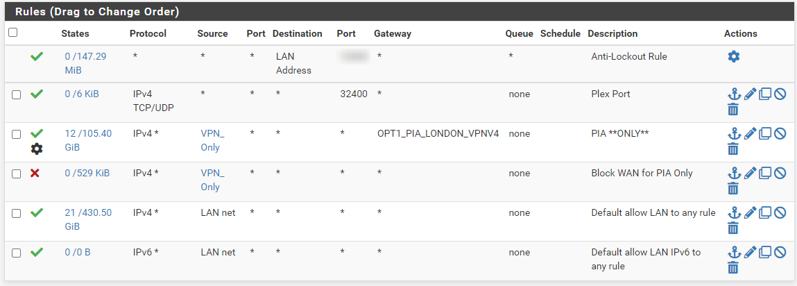

      Now I thought this could be achieve with another LAN rule above the VPN rule set which simply contains the port (in this case Aliases Port). To show you what I mean here is my setup:
      But, this doesn't appear to work. Could someone help me understand if this is possible and also how it can be done?

        Presumably you should leave the source port at "any", since they are almost dynamic.
        • L Offline
          Lockie @viragomann
          @viragomann I've changed it to the below but it doesn't appear to make a difference in terms of working.

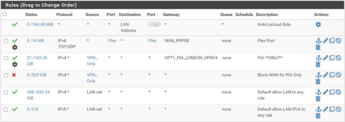

            L 2 Replies Last reply Reply Quote 0
            • L Offline
              Lockie @viragomann
              @viragomann No, the ports in that alias are:

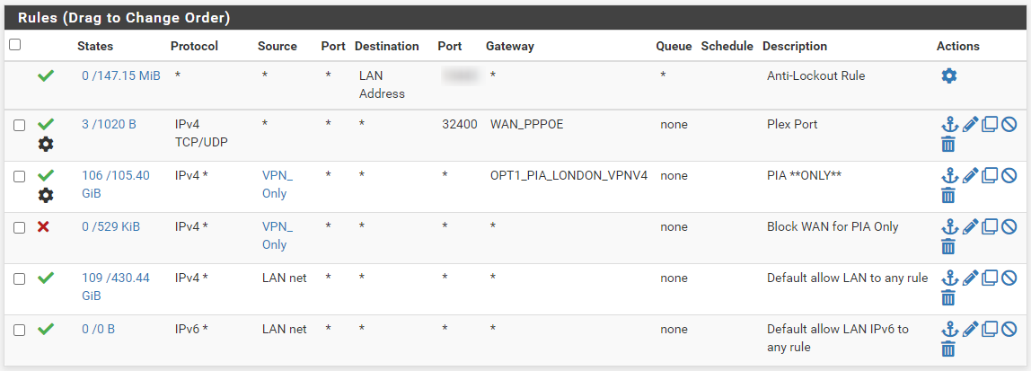

              • L Offline
                Lockie @viragomann
                @viragomann I have also tried a single port like so with the same result:

                  I'm in doubt that these all ports are meant to be directed out to the WAN gateway. You might need some of theme for internal communications relating to Plex. So you must not state a gateway in the rule.
                  Since you do policy routing for the VPN, I assume, WAN is still your default gateway anyway. So there is no need to state a gateway in this rule. Just set the rule above the VPN policy routing rule.
                  • L Offline
                    Lockie @viragomann
                    @viragomann do you mean like this?
                    • V Offline
                      viragomann @Lockie
                      @lockie
                      Exactly.
                      • L Offline
                        Lockie @viragomann
                        @viragomann K, because that doesn't appear to work.

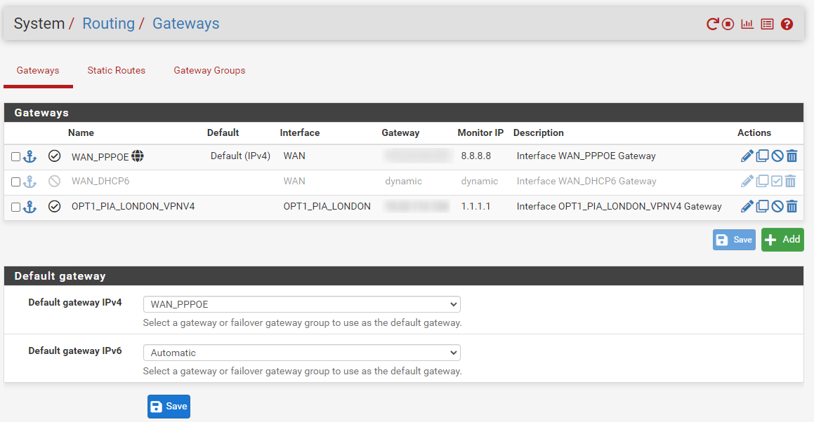

                                        Particularly I'd like to check the route pointing to the VPN gateway.
