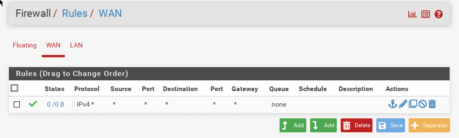

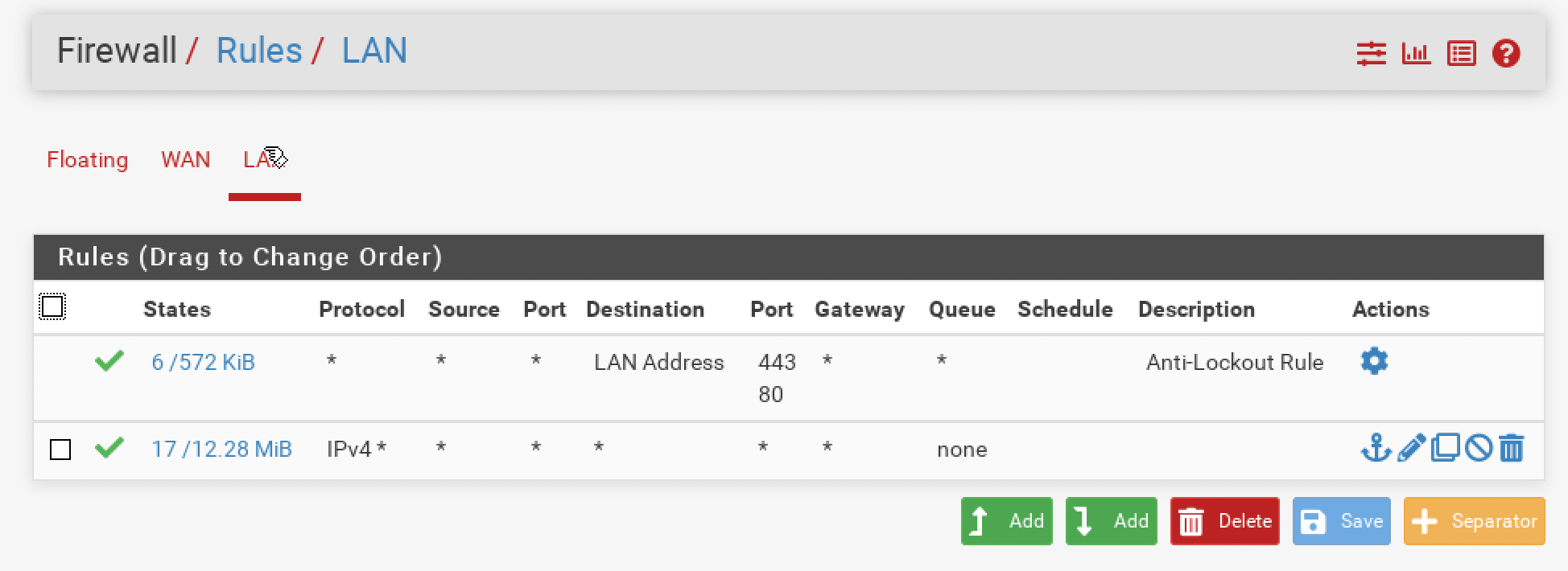

          mauro.tridici @viragomann
          @viragomann thank you very much for your reply.
          I'm a newbie and, unfortunately, I don't understand the meaning of asymmetric routing problem or how to solve it.
          Anyway, you can find in attachment the screenshots of firewall rules related to WAN and LAN.
          Is this the right way (the simplest at this testing moment) to say that the LAN client should be able to reach anything is on the internet?
          • V Offline
            viragomann @mauro.tridici
            @mauro-tridici
            These screens are showing the firewall rules. But as mentioned, we are talking about a hidden rule. So naturally you will not be able to see it there. But you can possibly find respective blocks in the logs though.
            So check in Status > System Logs > Settings if the option "Log firewall default blocks" is enabled. If it isn't, check it, save the setting and initiate some traffic.
            Then go to Status > System Logs > Firewall and look if there are block entries:
