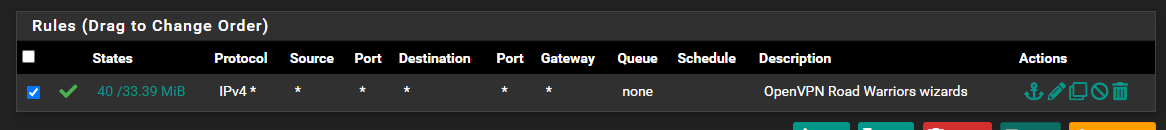

Instead I can still launch a web application on the server.The OpenVPN rules are those created with the Wizard and therefore everything should be allowed to everywhere.
