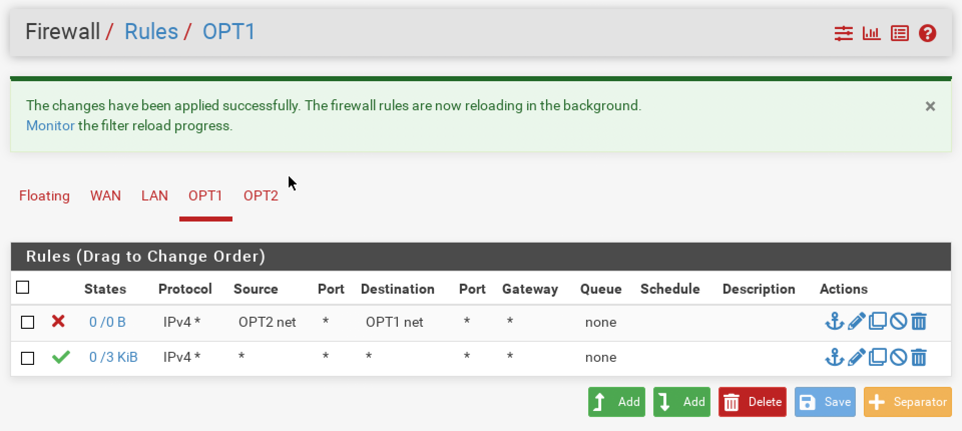

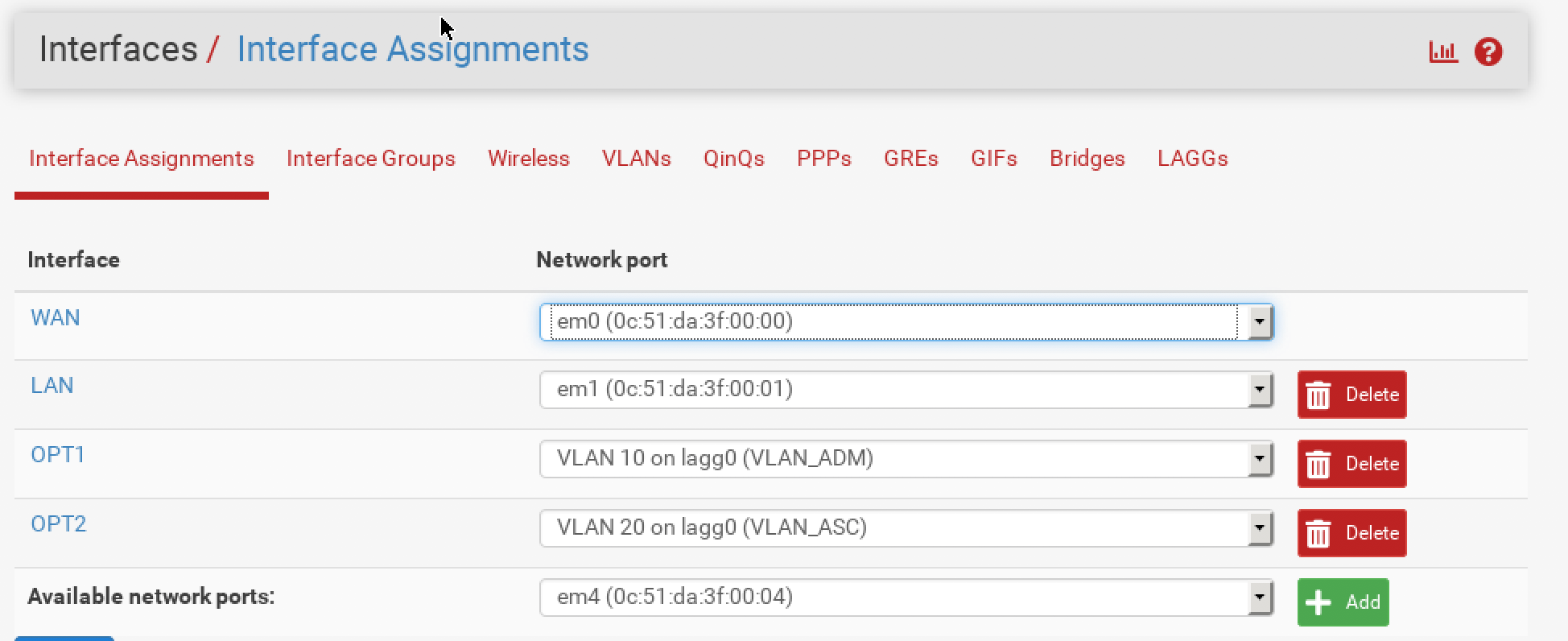

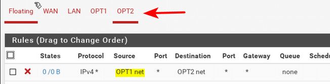

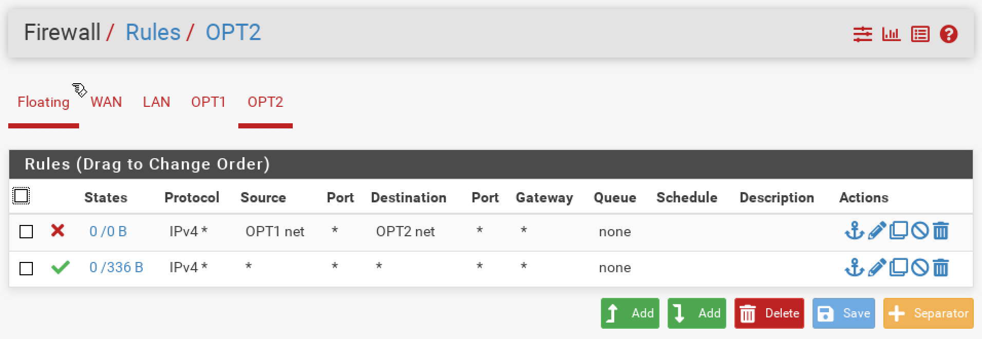

          I added the block rule to each OPT interface and I reset the states, but nothing changed. Any hosts on OPT1 can ping the hosts on the OPT2.
          Please, take a look at the attached screenshots.

            No, you misunderstood, what @johnpoz tried to suggest.
            You have to put the rule on the incoming interface.
            I.e. on OPT1:
            source: OPT1 net
            dest: OPT2 net
            and on OPT2
            source: OPT2 net
            dest: OPT1 net
