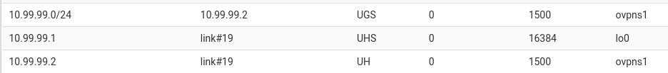

      The primary issue here is that PfSense is routing the entire tunnel subnet (10.99.99.0/24) to the first client address (10.99.99.2), regardless of topology (subnet/net30). If a client is connected at 10.99.99.6, it is unroutable from the Pf box. This limits only a single pingable client at a time on 10.99.99.2, which is not desired for my use case. I'm using client specific overrides to allocate the tunnel IPs to each client.
      Please find below the relevant entries in the routing table.
      Both the server and client override configs only specify the tunnel IP range (as well as the local accessible range for the server, with deny rules in the firewall for the backup server clients).
        Normally there shouldn't be any issue. Since all the OpenVPN clients are within an L2 which is connected to pfSense, there is no need for any route at all.
        If pfSense is the default gateway and you have a proper firewall rule on the LAN, LAN devices direct traffic for 10.99.99.0/24 to pfSense LAN interface. pfSense passes it to OpenVPN and OpenVPN will know, how to forward the packets to the clients.
