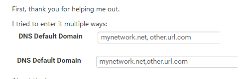

      Hello,
      I am running multiple OpenVPN-Servers on my pfSense (2.5.2-RELEASE), which does work flawlessly with a more or less standard configuration.
      However, once I try adding an additional DNS-name under "DNS Default Domain", The service of that OpenVPN-server breaks down and cannot be restarted.

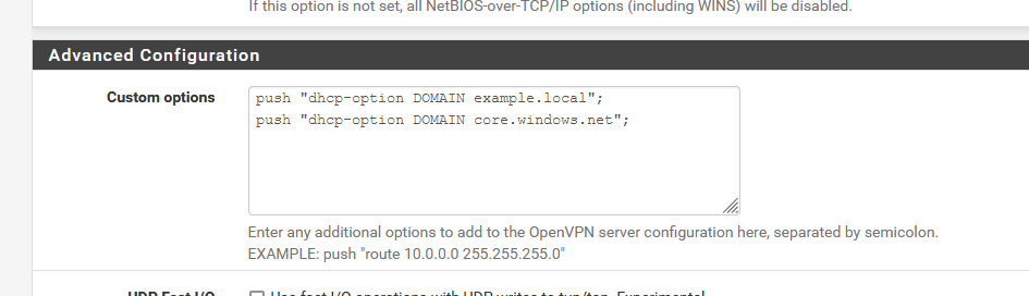

      I also tried to push the domains via:
      push "dhcp-option DOMAIN example.local"
      push "dhcp-option DOMAIN core.windows.net"
      With the same result.

          MaxTheITGuy @Gertjan
          @gertjan
          First, thank you for helping me out.
          I tried to enter it multiple ways:
          About the Logs:
          I found an entry. Sorry, I was looking in 'System' before, thinking as it was a service that was causing issues. And our OpenVPN is getting so many Logs that this info was not visible anymore once I checked there. Seeing this sheds light into my issue.
          Also, it did work as a custom option the way you entered it. I must say... I forgot the semicolons.
          Sorry, I might have worked myself into this issue so much, I did not see any obvious clues.

            Look at what the doc says about "DHCP-push options" : Go here https://build.openvpn.net/man/openvpn-2.5/openvpn.8.html and locate --dhcp-option
            The variable DOMAIN can have a "name".
            Nothing has been said about adding multiple domain names.
            IMHO : it's even not 'logic' that multiple DOMAIN names can be used here.
            @maxtheitguy said in additional DNS-name kills service:
            Just to be sure : the usage of semicolons is just a pfSense GUI syntax, so it can separate the lines.
            Because, maybe I am on a completely wrong track here...
            Shouldn't you check "DNS server enable" and add the IP's of your own DNS servers ?
            See my image above, previous post.
              If you want search domains then use that option..
              dhcp-option DOMAIN-SEARCH my.company.domain
              dhcp-option DOMAIN-SEARCH some.example.domain
