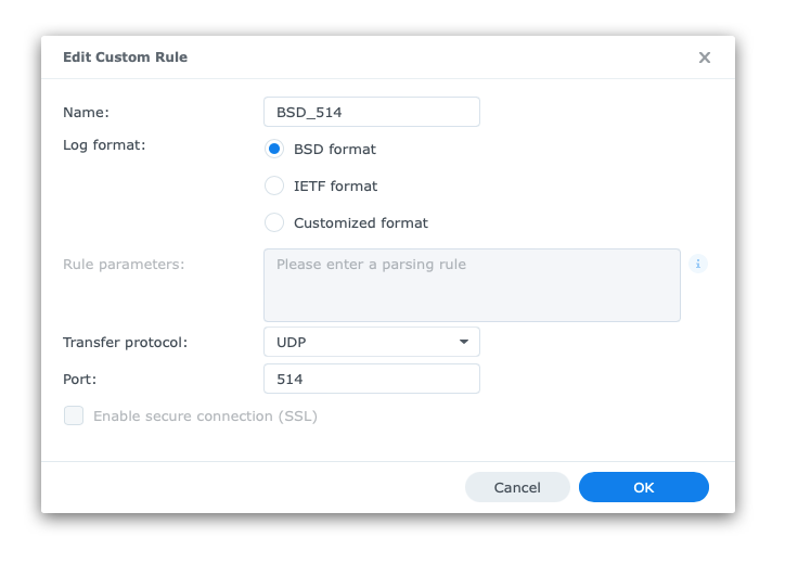

        @darcey You need to send your logs to a syslog server.
        Do you have a NAS with a syslog server, I send mine to a Synology NAS.

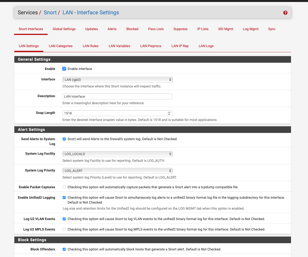

            The snort2c table is actually everything that snort has blocked, you'd be better logging every Snort block.
