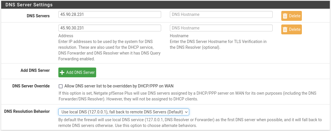

          example, just for manually entering anonymous dns server say from nextdns, I add the two ip addresses in the DNS severs fill box. but then the options below IDK to do, do I check the box or not?
          DNS Server Override
          Allow DNS server list to be overridden by DHCP/PPP on WAN If this option is set, Netgate pfSense Plus will use DNS servers assigned by a DHCP/PPP server on WAN for its own purposes (including the DNS Forwarder/DNS Resolver). However, they will not be assigned to DHCP clients.
          Do I check this box if I want my DNS to be forced thru the IP's I listed above?
          And the other option at the bottom. The documentation simply doesn't describe the choice I should want for a basic/advanced config.

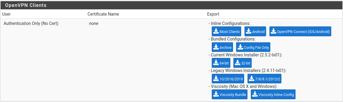

            I ran thru another setup of openvpn
            https://www.youtube.com/watch?v=E1S6sG4Dqis @5:29
            but when it comes to openvpn clients, I am running linux. There is no option for linux? I assume, I could dl the openvpn client thru my distro apt manager or flakpak ?
            https://flathub.org/apps/details/com.github.jkotra.eovpn
              I don't know this service. Consider that if this is a usual unencrypted DNS on port 53, the requests are readable on any node in the internet.
              However, with default settings the DNS server you enter here are only used by pfSense itself, but not to resolve requests from LAN devices behind.
              pfSense has the DNS resolver activated by default which request the root DNS server itself.
              But you can set it in forwarding mode or use the DNS forwarder instead. Then the DNS servers you stated here are used.
              With "DNS Resolution Behavior" you can instruct pfSense to use the resolver or the above stated servers. The options should be understandable.
              With "DNS Server Override" you can allow that the stated DNS server are overridden by the ISP. This is not what you want obviously, so don't check.
              This is only applicable with automatic WAN address configuration.
              That's now a vpn server. So you want also to set up a server to connect to your network from a remote location?
              Which export package to use for Linux depends on the client. Presumably you will use NM. This should work with the archive.
              Unpack it to a folder in your home and import it with NM. Probably you have to set the paths to ca, cert and private key manually, all to the p12 file. And additionally the TLS key in the TLS settings if you have enabled it in the server settings.
