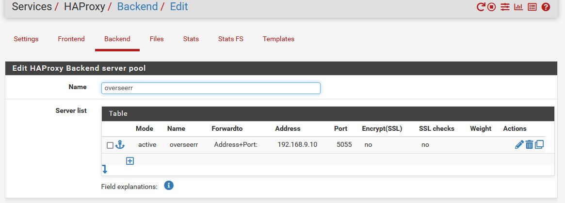

        Because your not sending it there? I run overseerr vis ombi now, what does your backend look like? Are you not using address+port?
        The ssl offload is setup on the frontend.
        And yes screenshots are easier and faster to read.
          menethoran
          @johnpoz nope, it looks fairly similar to yours (minus mine has ssl certs attached to it that its not using)

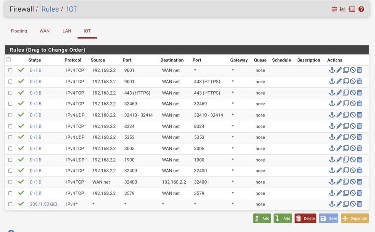

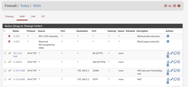

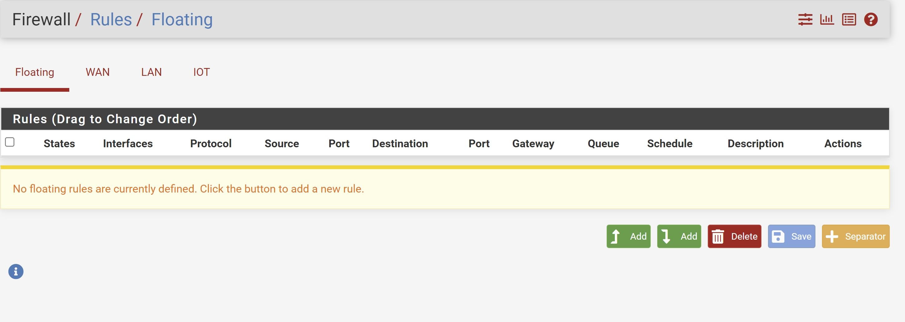

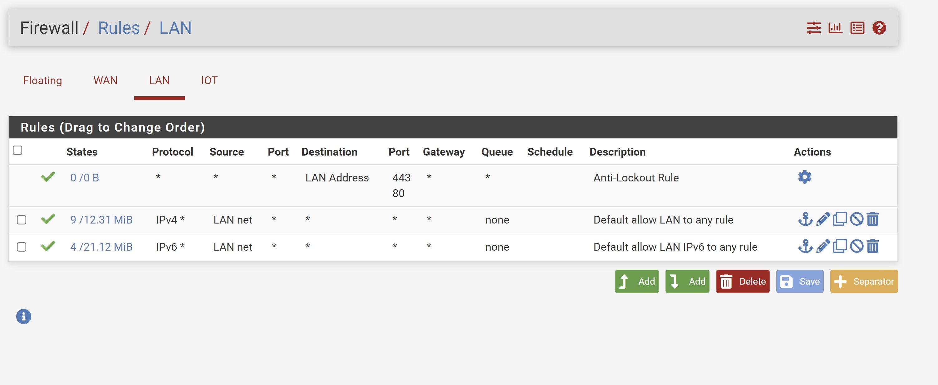

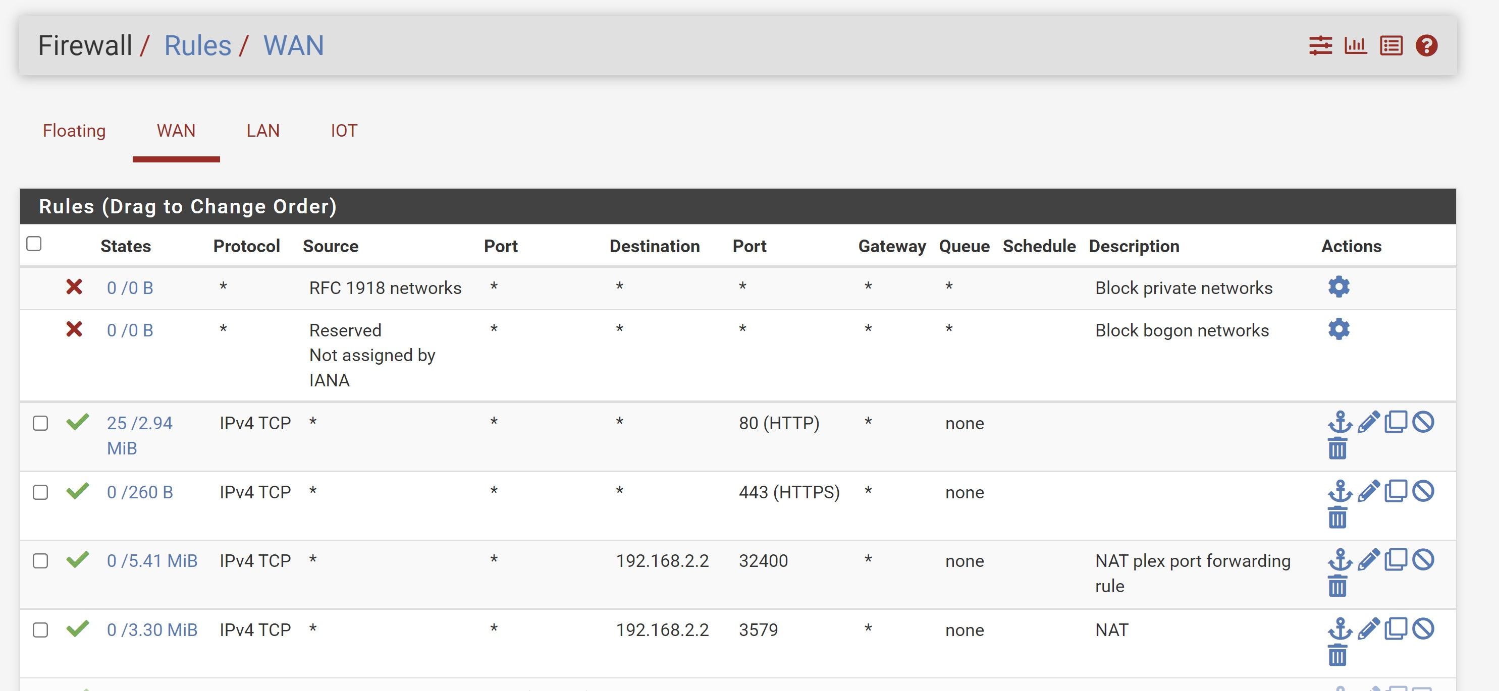

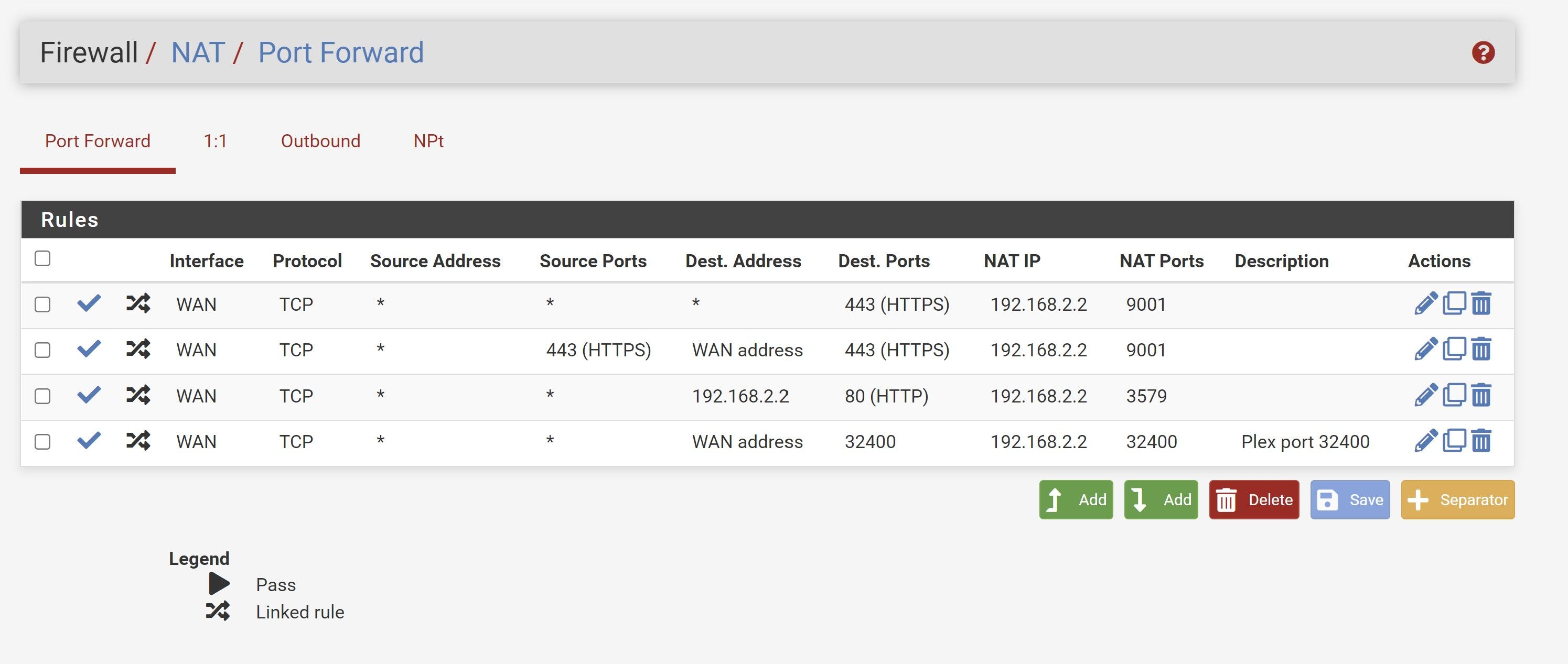

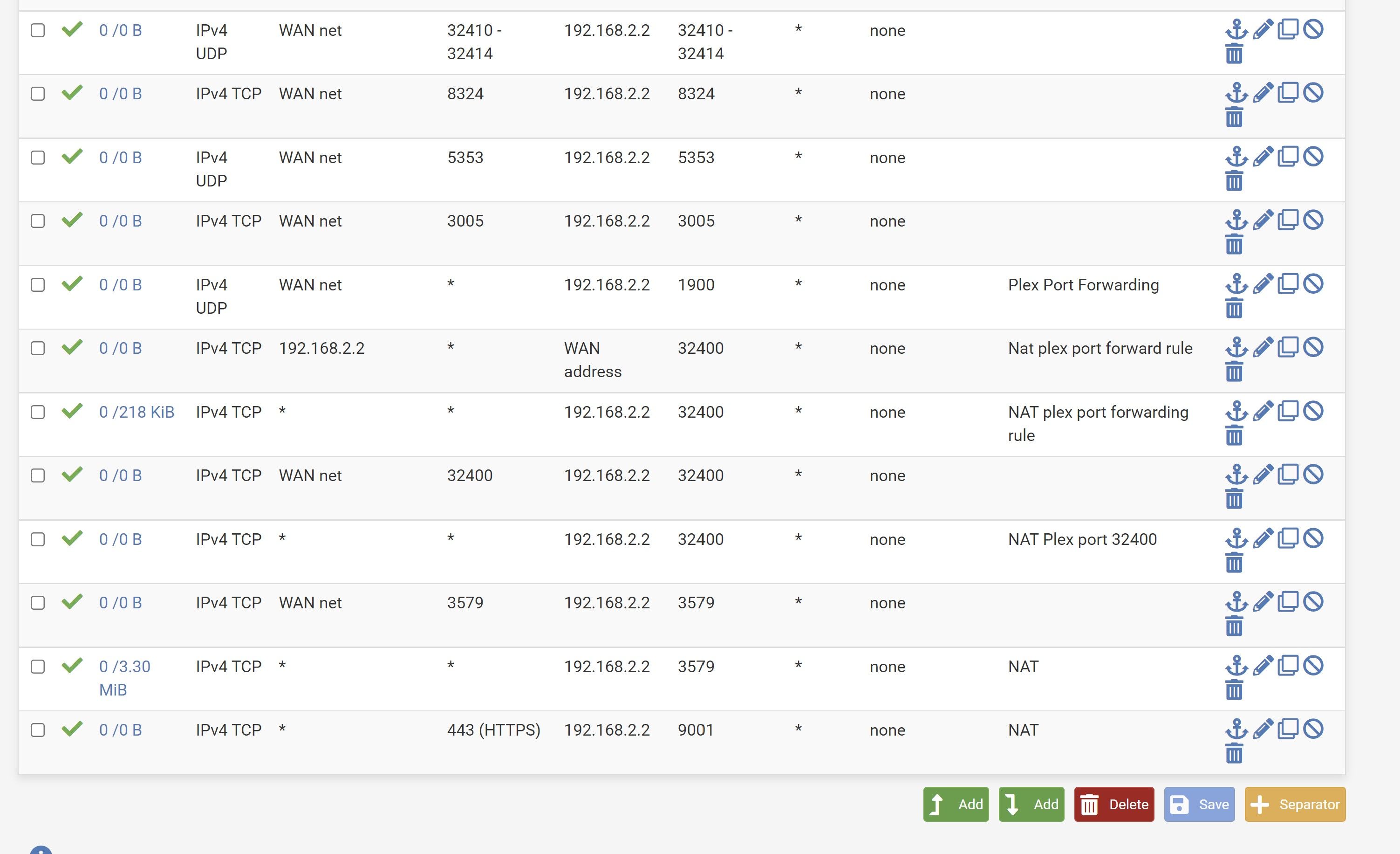

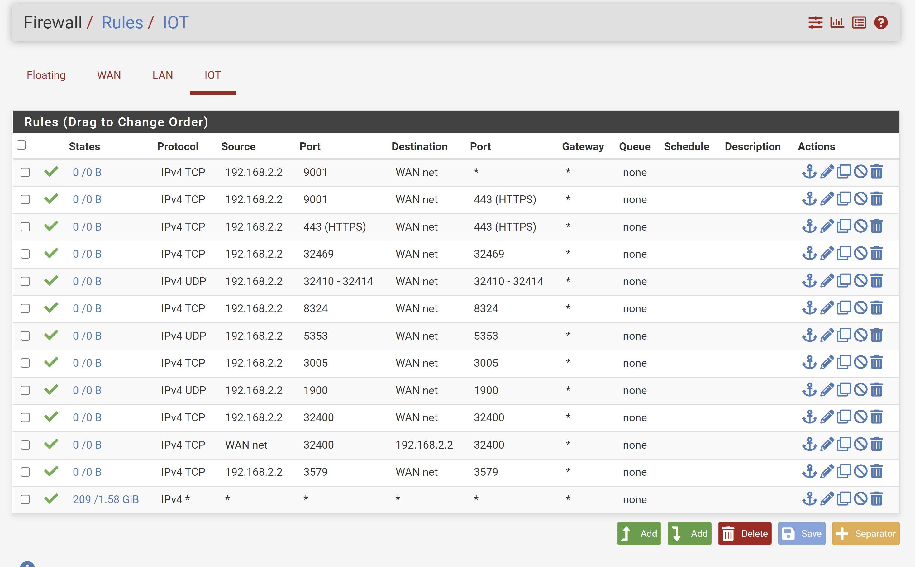

                      @menethoran lot of rules that don't make a lot of sense.
                      WAN net as a source isn't going to work, that isn't the internet - that is just your wan net.. Do you have lots of clients on your wan net? is 192.168.2.2 coming in from your wan? But then you also have it listed as destination?
                      Looks like a mess to be honest, bunch of useless rules..
                      So your allowing 443 to 192.168.2.2, where is the rule on your wan that lets the internet hit your frontend port of haproxy? Which would be 443 or 80 and 443, etc.
                      And your iot rules - how is wan net a source? I think you have a basic lack of understanding how rules are evaluated.
                      Rules are evaluated as traffic enters an interface from the network that interface is attached to.. How would an IP from whatever your wan net is be source of traffic from your iot network into the iot interface?
                      Rules are evaluated top down, first rule to trigger wins, no other rules are evaluated.
                      Wan net is NOT internet, its just the network your wan is attached too.. so like 1.2.3.0/24 or whatever your IP is on your wan and the mask...

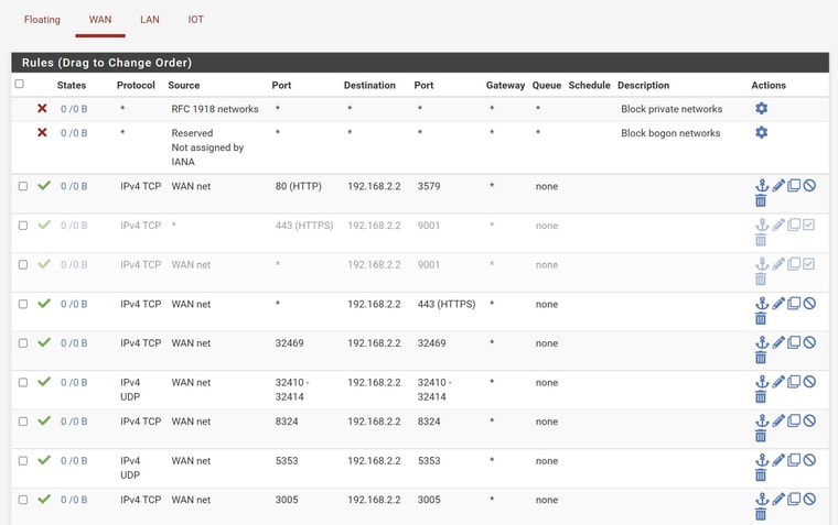

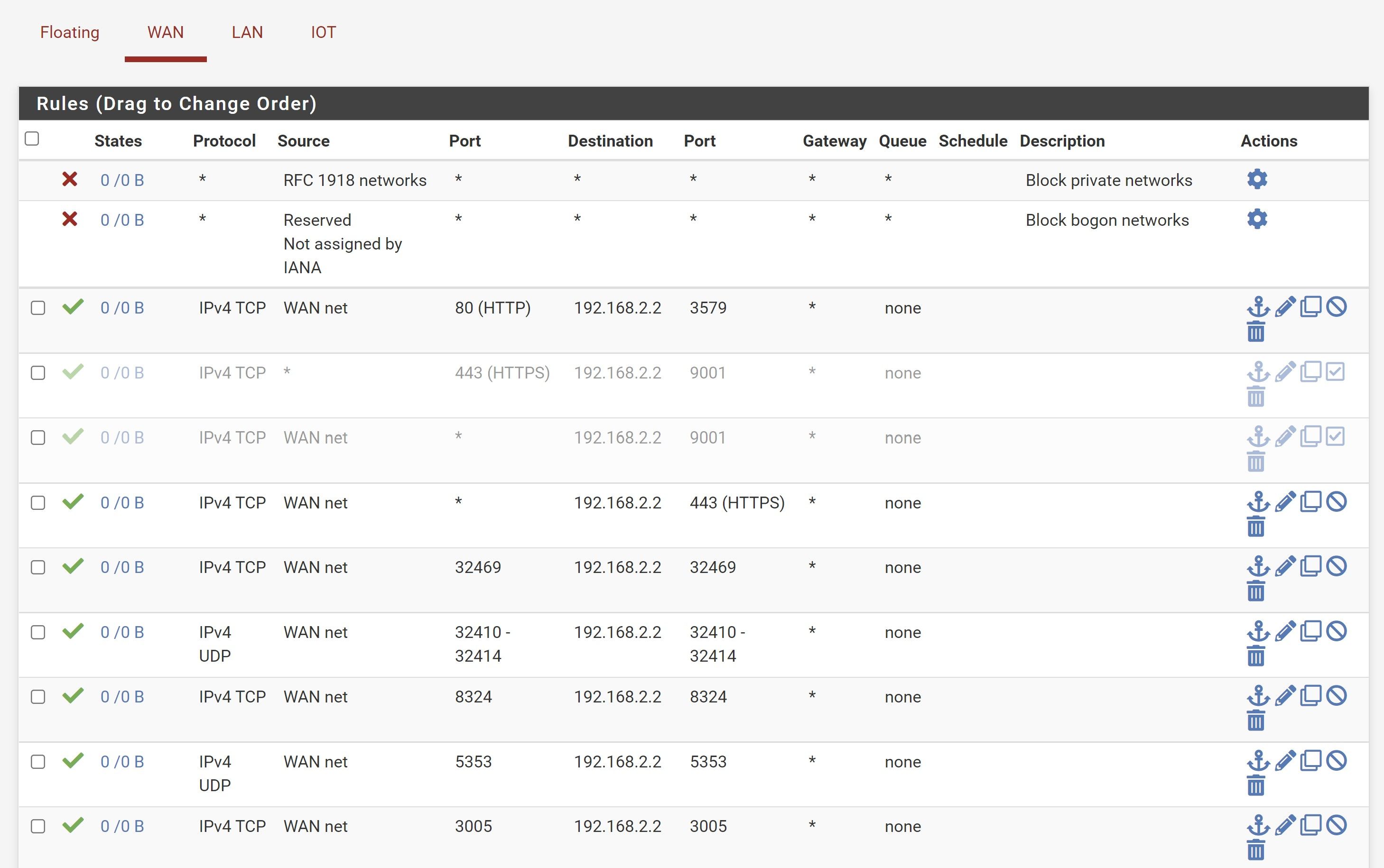

                                    Still no joy (feel free to check on your end as you know the domain to go to (cloud.domain.com is also setup and doesnt work, just leads to the login page for TrueNAS )
                                      johnpoz LAYER 8 Global Moderator @menethoran
                                      @menethoran where is your frontend setup? for haproxy, and did you remove pfsense from listening on 80 and 443?
                                      You have to setup the front end to match up to your backend that sends to port..
                                      I hit your fqdn now on 80 I just hit truenas.
                                      btw your rules should be wan address for destination.
                                      If I hit your ombi fqdn on https: It tries to send me to 192.168.2.2:9001 So your ha proxy is clearly not setup correctly. But that looks more like a redirection vs proxy... Lets see your port forward setup..

                                        @johnpoz i think thats because i have all https requests going to nextcloud (on 9001)...
                                          @menethoran and again useless rules. How would the source port be 443? that would never be the case.
                                          And how would the dest be 192.168.2.2 and natted to 192.168.2.2 to 3579, remove that rule as well.

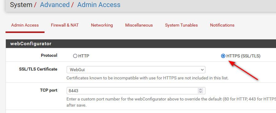

                                            @johnpoz when you ask "did you remove pfsense from listening on port 80 and 443" do you mean, did i change the port used to access the pfsense gui? if so, yes. (is that problematic?)
