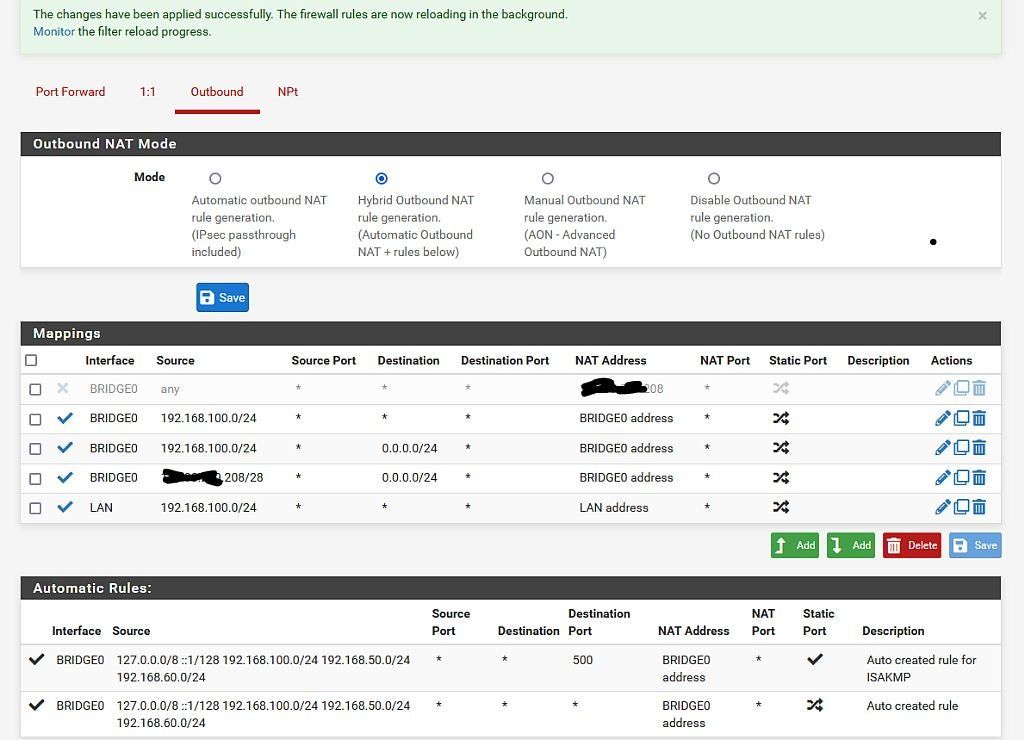

        viragomann @BlueSun
        @bluesun
        The destination 0.0.0.0/24 in the outbound NAT rule does not include 8.8.8.8, so no translation for this IP.
        Set it to any, or 0.0.0.0/0 if you like numbers.

          BlueSun @viragomann
          @viragomann Thank you. I have change the subnet to /0 but that doesn't seem to help either.

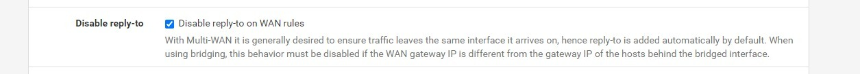

            I found the problem.
            The virtual machine can now access the internet.
