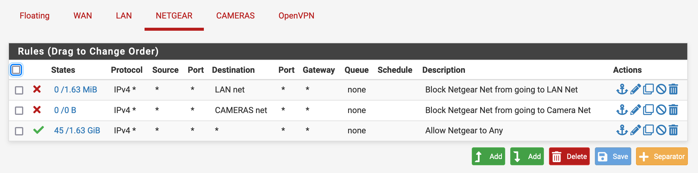

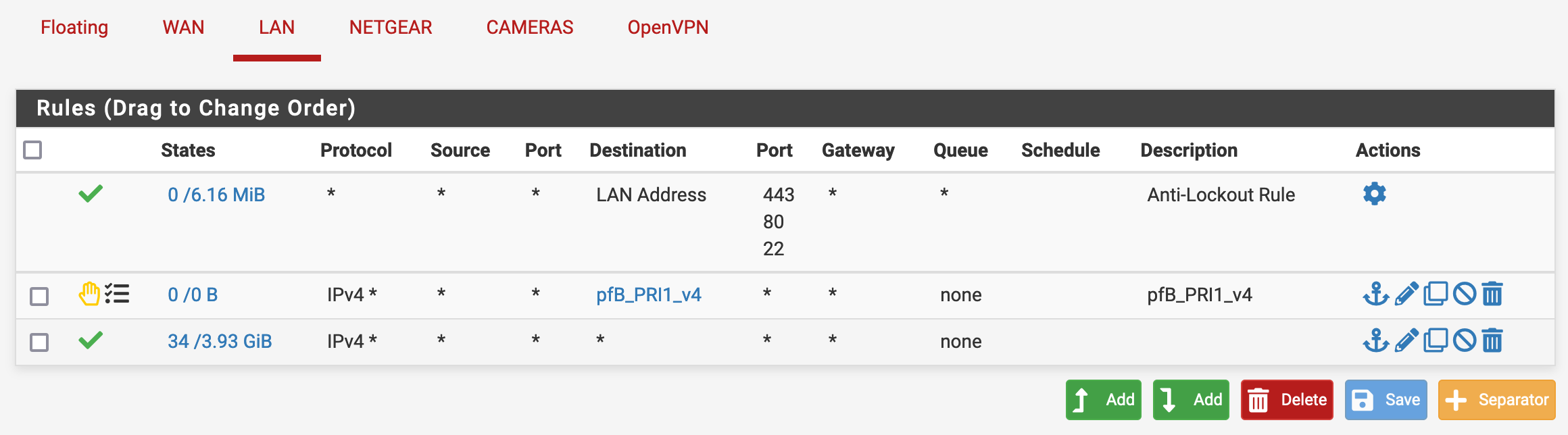

      At any rate, I have 2 separate networks. LAN 192.168.1.0/24 and NETGEAR 192.168.80.0/24. For the life of me I can't get the proper rule setting to allow a specific host from 1.0 network in to the 80.0 network. I've tried as many variations as I can think of with no luck.
      Here is what the current rules look like for both networks:

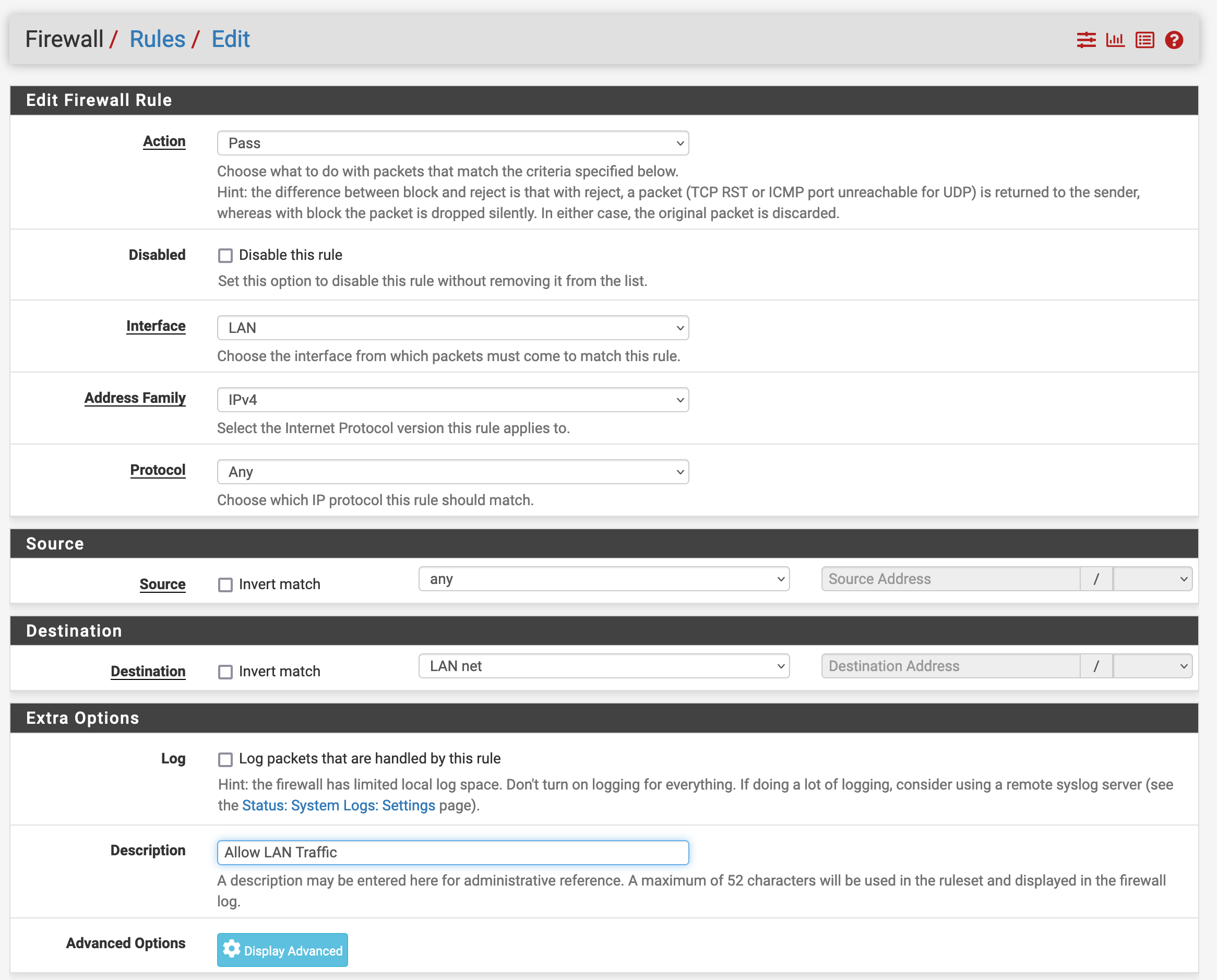

      I realize that there isn't a current rule on the NETGEAR network that shows my attempts because I deleted them in frustration. Here is something that I've tried and it doesn't matter whether I try and allow the entire LAN in or a single host, it gets blocked.

        @nosenseatall Is that Netgear a router in which the 192.168.80.0/24 is behind of ?
        • N Offline
          nosenseatall @mcury
          @mcury Yes, but I don't have it doing any routing. It is in access point mode.
            mcury Rebel Alliance @nosenseatall
            @nosenseatall Ok, so the pfsense is the default gateway of both networks.
            It should be working, the firewall rules are correct...
            Maybe Windows Firewall could be blocking ?
                            And does this netgear your using as AP have a gateway set on its LAN interface.. Most soho routers do not allow such a feature. And I have no idea what it does when your using their so called "AP MODE"... where it bridges the wan interface into the bridge. It most likely still uses its lan settings, which do you have a gateway set pointing back to pfsense?
                            Sniff on pfsense 192.168.80 interface while you ping.. Do you see the traffic go out - but no response? Then the device never got it, even though pfsense sent it.. Or it didn't know how to answer because it has no gateway, or it points to something else as its gateway.
                            The firewall for the Mac is turned off so it's not a host firewall issue.
                            Same test.. Sniff on pfsense.. Do you see it send on the ping.. What rules are what there.. What is the 192.168.1 (lan) what is the 192.168.80 (netgear)?
                            What are you pinging from lan 192.168.1.what? To what on the 192.168.80? Can you ping the 192.168.80 pfsense IP? If so then your rules are correct on the interface traffic is coming from.
                            Rules are evaluated on the interface where traffic would enter pfsense from the network attached. Top down, first rule to trigger wins, no other rules are evaluated.
                            There are no rules required on the dest network interface.
                            Do have any floating rules?
