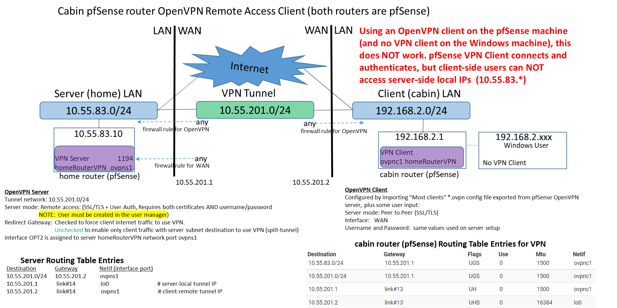

Hello pfSense folks, I have spent a lot of time trying to debug a OpenVPN issue, I think I have a good summary of the issue, and good pictures and screenshots below. Thanks in advance for help on this:
I have created a pfSense OpenVPN client at one site, which is connecting to a pfSense OpenVPN server at another site. The pfSense client is connecting, and on the client side I can ping server-side local IPs, but I am otherwise unable to access the server-side local IPs, for example I can not connect to the pfSense server-side GUI.
I created the OpenVPN client using an import of the OpenVPN configuration exported from the pfSense OpenVPN server. On the client side, if I use a windows OpenVPN client instead of the pfSense OpenVPN client, everything works fine.
I don't see any deny rules causing problems with the server-side local IPs in the pfSense client firewall logs.
Attached is a picture and routing tables for the setup that is failing:
Here are all the rules for the pfSense client:
Here are all the rules for the pFsense server:
Finally, here is a picture and routing tables for the same server connected with a windows OpenVPN client:
I figured out how to solve the original problem, and now have one remaining issue:
Solution to original problem: The client side is enabled to access server side local IPs by adding this Mapping rule on the client pfSense firewall / NAT /outbound (using Hybrid Outbound Nat rule generation):
Remaining issue: The server side can not access client side local IPs. I tried adding this Mapping rule ono the server pfSense firewall / NAT /outbound (using Hybrid Outbound Nat rule generation), but it is not solving the problem:

That enables you to access the remote site, but you lose the info about the origin clients IP. Would be better to configure the routing properly than doing masquerading. But that's on you.
Are there multiple clients connecting to this server?
If not, switch the server into site to site mode and change the tunnel mask to /30. -
@viragomann
I have two scenarios for the server side: A case where multiple clients connect to the server (all of those client cases are windows machines), and also a case where the client is a pfSense router. These are all my personal scenarios.For the former case, I've go things working as desired as described above.
For the latter case:
- With regards to the solution I posted for client-side being able to use server side local IPs, I don't have enough knowledge to comment on your points about limitations. I did use the pfSense OpenVPN configuration import, so if the routing is not set up properly it seems the pfSense import shares some responsibility.
- With regards to solving the problem for server-side not being able to use client-side IPs, I will have to try setting up site-to-site. That seems less burdensome than other solutions I can think of to try.
@wmcneil
So you have set up an access server allowing multiple clients to connect. But if you need to access a network behind the client you have to tell the server how to reach this network.From the point of a client all is clear. He connects to the server, gets the server IP pushed for the gateway and the networks which he should route to the server.
But since multiple clients connect to the single server, you have to tell the server behind which specific clients IP he can reach a specific network. This can be done by CSO on the server.However, I like more to separate access servers from site-to-site connection and set up multiple servers for this purpose.
When you set up a site-to-site server, you choose a /30 tunnel subnet and enter the networks behind client into the "Remote Networks" field to let the server know the proper route.When you want to use the access server for a site-to-site connection as well, you want to set up a "Multi-Purpose OpenVPN server" and add a CSO for the client(s) you want to reach the network behind.
