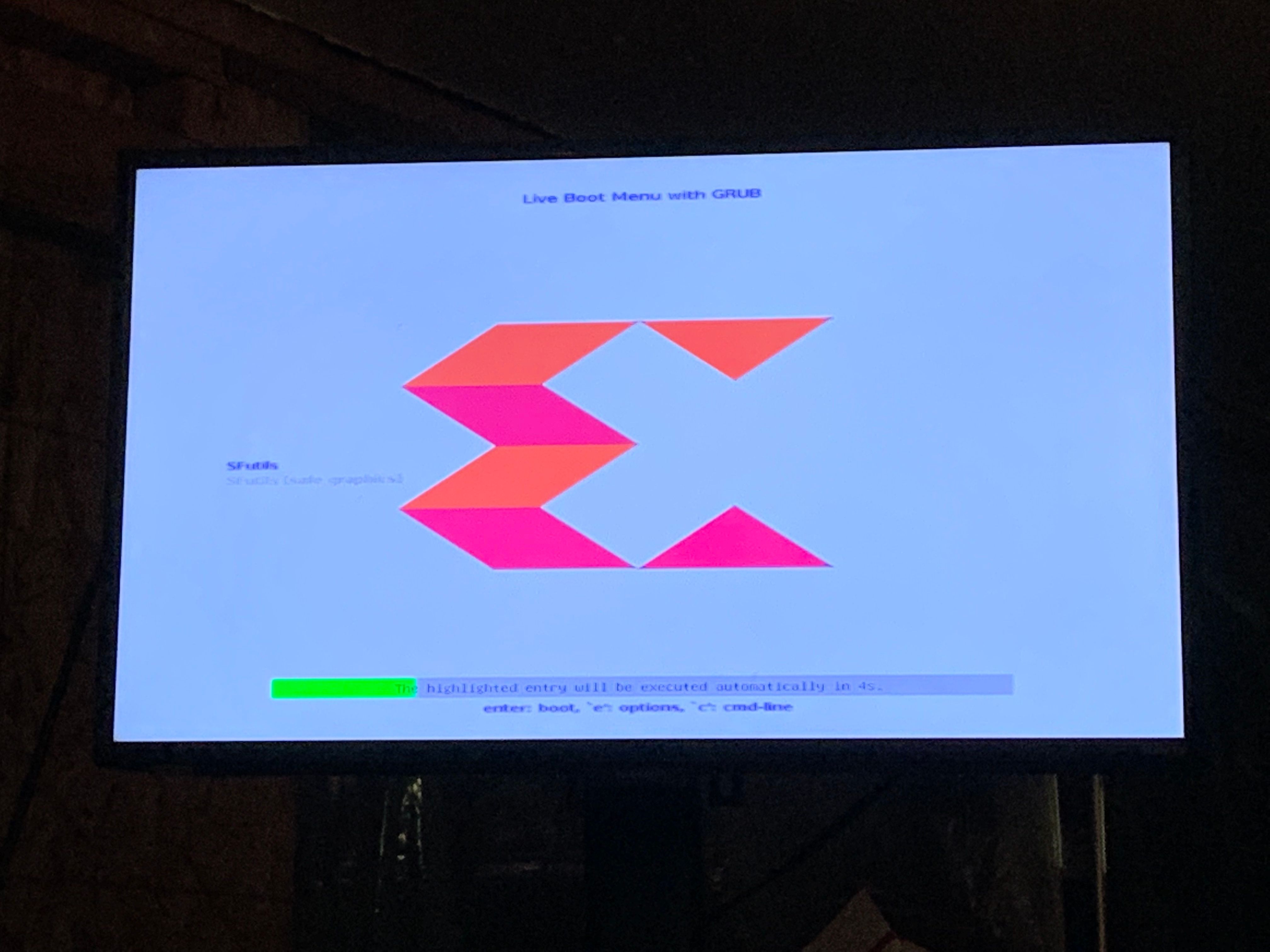

      So I built an ASUS computer from the ground up for pfSense and bought & installed a Solarflare Flareon Ultra 4 Port 10Gb SFP+ PCIe 3.0 Server Card Adapter SFN7124F to help with the speed. However, I am having an issue with how to install the drivers and firmware. I have downloaded both the single files and a Boot ISO but I don't understand how to install any of them. When I boot the ISO I get a screen as shown below but I don't know where to go from there. Any step-by-step directions help would be Greatly appreciated.

          Mmm, are you trying to update the firmware with that ISO?

                            @stephenw10 - Here is the download site I was at:
                            https://support-nic.xilinx.com/wp/drivers#
                            MacWarrior
                              MacWarrior @stephenw10
                              @stephenw10 - Looks like a new bootable just came out today.
                              MW
