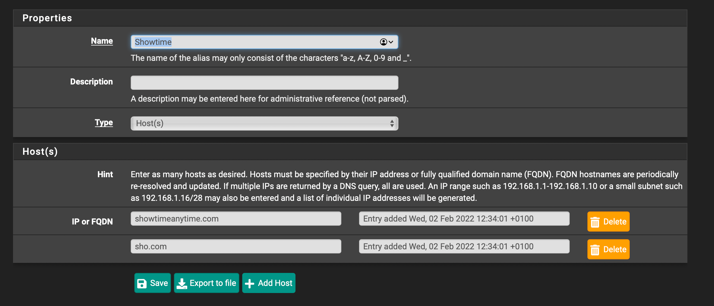

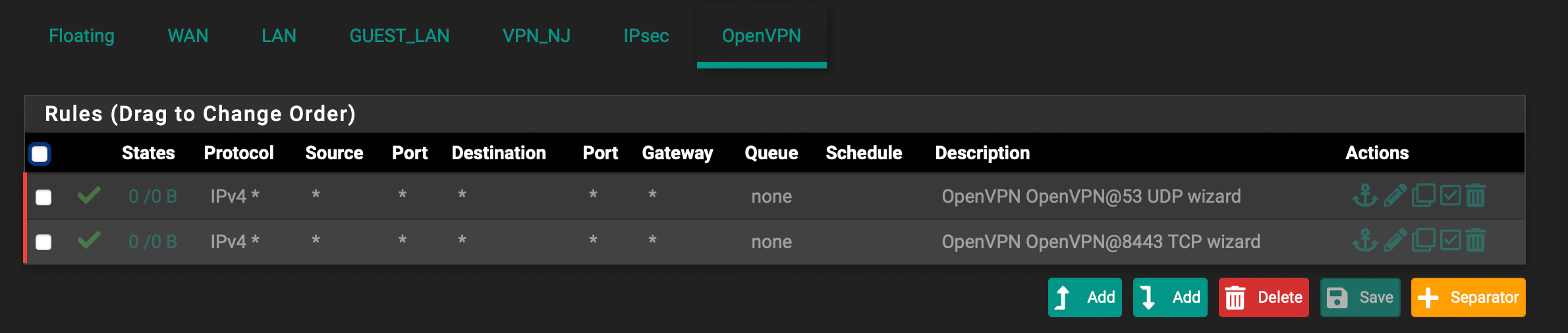

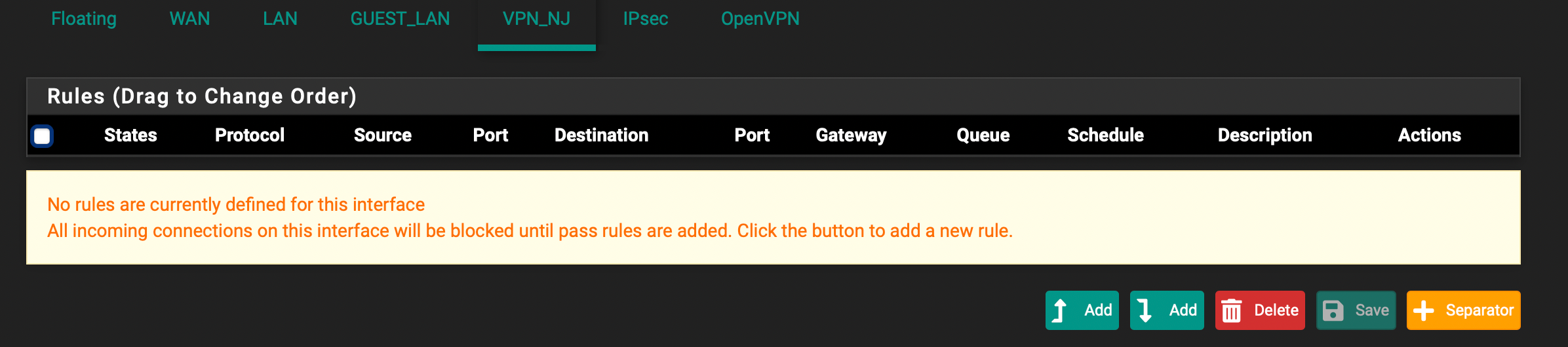

      I was initlally trying to route two hostnames (sho.com showtimeanytime.com) over the OpenVPN client connection. I have added the OpenVPN interface (let's call it VPN_NJ), could see the gateways up with IP addresses assigned. I also added a LAN rule, routing the traffic destined for those hosts from LAN to the OpenVPN gateway. The rule is above the "LAN default any" rule. I also added a NAT rule in Hybrid mode, matching RFC1918 source traffic one VPN_NJ interface.
      However, with tcpdump running on the VPN_NJ interface, I could not see any traffic reaching the interface, e.g. when attempting to telnet the remote host from a local LAN client. The configuration was as follows:

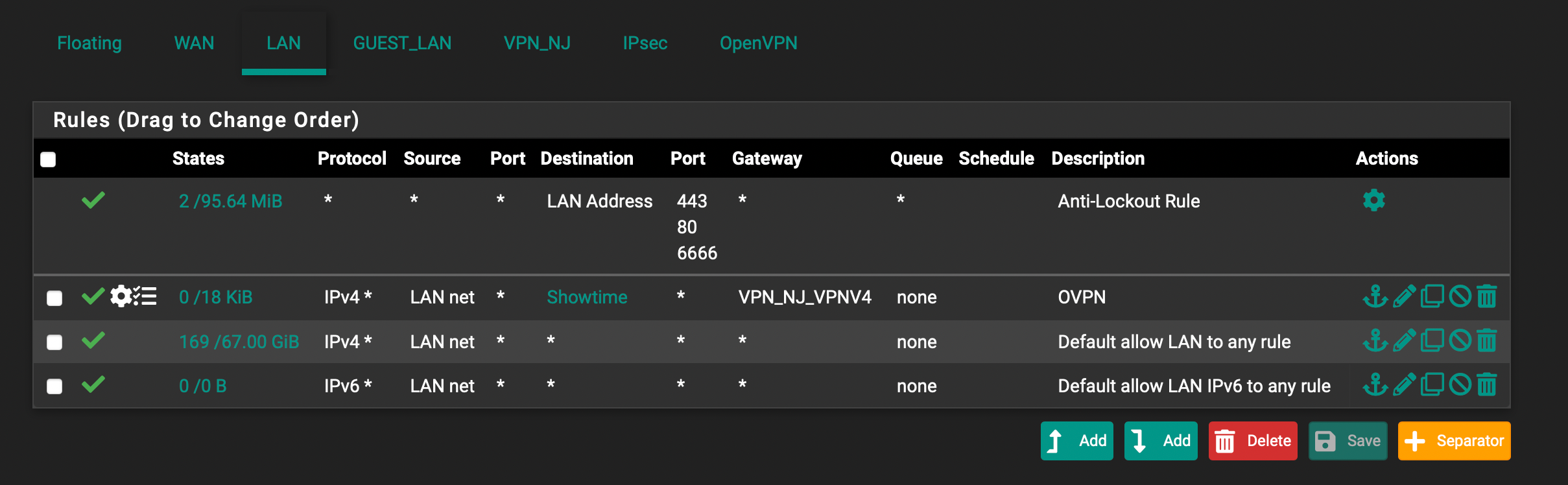

      Not being able to get this to work, I slowly reverted back to seting up a typical scenario where all my LAN traffic is routed via VPN.

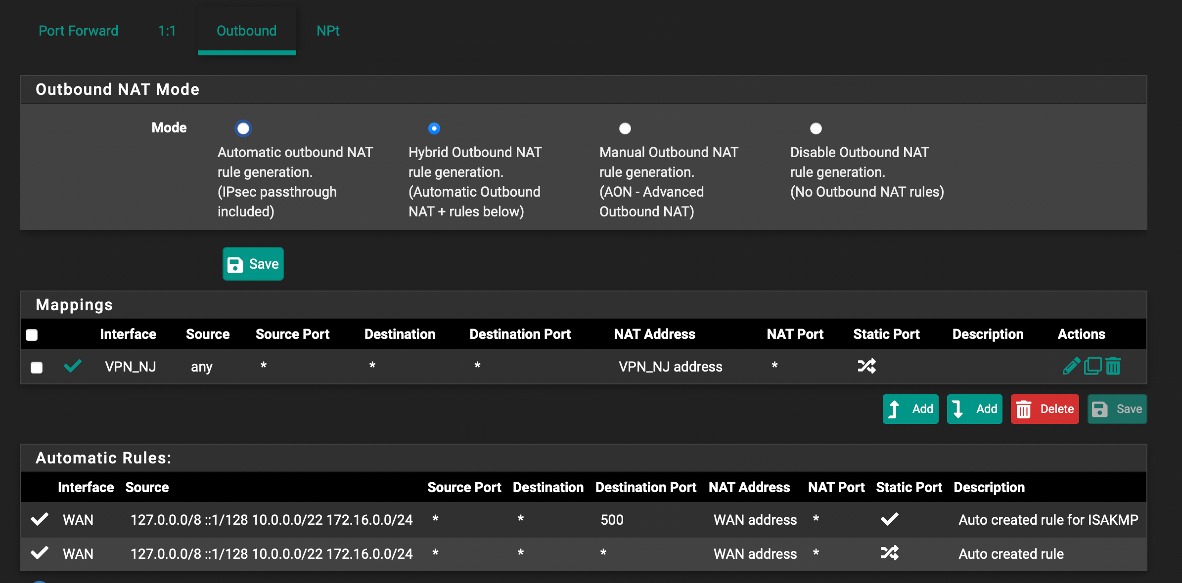

      11:49:07.564943 IP 10.90.0.6.62126 > 64.6.65.6.53: 18780+ A? app-measurement.com. (37)
      I suppose this is NAT-related.

        The NAT is working on your site as the tcpdump is showing.
        Possibly the remote site is miss-configured. What is it, a VPN provider?

          Consider that the policy routing rule directs any traffic coming in on LAN to the VPN server. Hence you are not able to access any local IP.
          I am not able to access Internet IP. LAN works fine. That is, again, with pulling in of the OpenVPN routes enabled. The traffic on the OpenVPN interface is one-direction only, which is why I concluded that something was still wrong with NAT or routing.
          This means, DNS on LAN devices will not work if they are configured to use an internal DNS server like pfSense.
          Let's forget about DNS resolution for now, not even 1.1.1.1 works. Literally nothing.
          You to add an additional firewall rule to the top of the LAN rule set to allow access to DNS or other internal IPs.

                  @kultigsptrizigfrisch
                  You have only one NAT rule that applies to any IPv4 traffic. If this one is working from pfSense itself, it should also work for networks behind.
                    I actually previously updated that rule to only apply to OpenVPN interface, so it's not that. It works from pfSense only when I have openvpn configured to set up the routes – but then I get no LAN to Internet traffic at all, although I see it on the OpenVPN interface, which is why I assume there's something broken with NAT or routing.

                    Let me try to clear one thing up once again: With the pulling of the routes disabled, and the firewall rules configured as instructed and on the screenshots above, which basically dictate to rule all the LAN traffic via the OpenVPN gateway, LAN traffic to the Internet does work – except that traffic is not routed via the OpenVPN and still goes through the main WAN connection. This is the weirdest part, since it appears to be ignoring that rule altogether, or that the gateway that pfSense sets up implicitly is somehow misconfigured. With route pulling enabled, I get the traffic from pfSense itself to route over OpenVPN, but otherwise get no traffic to the Internet on LAN clients.
                    • W Offline
                      wrobelda
                      Does anyone have any other idea on how to debug this? Essentially my Firewall LAN pass rule, configured to use OpenVPN gateway is ignored, such that the traffic is still routed through the WAN gateway. What to check here?

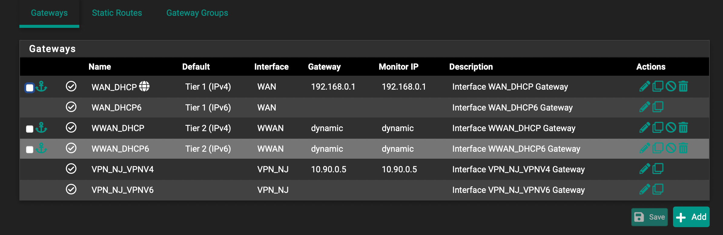

                        I realized there is a Gateway Status page in Diagnostics, and in there I see the OpenVPN gateway marked as:
                        Offline, Packetloss: 100%
                        So at this point I am assuming there's something wrong with the Gateway creation.
                        • V Offline
                          viragomann @wrobelda
                          Yeah, if the VPN gateway is offline, the packets are sent out by the default gateway.
                          You can change this behavior by checking System > Advanced > Miscellaneous > Skip rules when gateway is down.
                          Gateway offline basically means that pfSense cannot ping the monitoring IP. The default monitoring IP is the virtual VPN IP of the remote endpoint.
                          That does not necessarily mean that the VPN is not working, just the remote endpoint does not respond to ping.
                          You can set another monitoring IP, which is reachable over the VPN and is responding, or you can disable monitoring if you don't need it in System > Routing > Gateways.

                            wrobelda
                            @viragomann Thanks. Came here to report the final solution and I see you had answered with the same. The issue was that the default gateway was not responding to ICMP. Changing the monitoring IP to something else had immediately brought the Gateway up, and the routing now works as expected.
