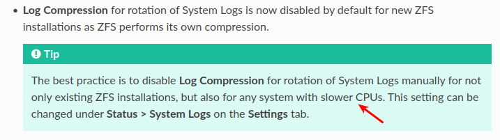

                      @bingo600 I think nattygreg meant compression. See note:
                      https://docs.netgate.com/pfsense/en/latest/releases/22-01_2-6-0.html#general
                      Upvote šŸ‘ helpful posts!

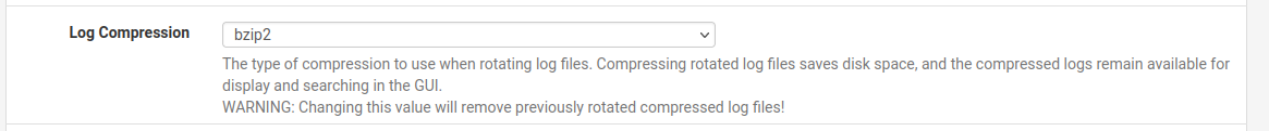

                        @steveits said in pcscd daemon is enabled after reboot:
                        I had a suspicion that he meant compression, since he mentioned bzip.
                        But he wrote encryption.
                        But according to this:
                        It is only during log rotating that the log is compressed.
                        And IMHO that would only mean extra memory usage during rotating.
                        If you are really tight on memory, it might save you some memory during the compress, but as mentioned :
                        It will be CPU Cycles during the log compression , that is the "Big winner" here.
                        I can't see the real relation to "saving/freeing memory" , in disabling log compression
