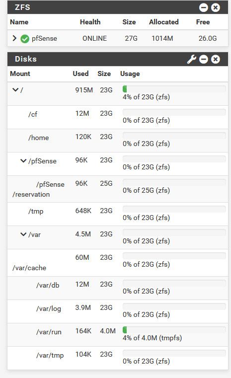

                                      [22.01-RELEASE][admin@sg4860.local.lan]/: zfs get exec
                                      NAME                  PROPERTY  VALUE  SOURCE
                                      pfSense               exec      on     default
                                      pfSense/ROOT          exec      on     default
                                      pfSense/ROOT/default  exec      on     default
                                      pfSense/cf            exec      off    local
                                      pfSense/home          exec      on     default
                                      pfSense/reservation   exec      on     default
                                      pfSense/tmp           exec      on     local
                                      pfSense/var           exec      on     default
                                      pfSense/var/cache     exec      off    local
                                      pfSense/var/db        exec      off    local
                                      pfSense/var/log       exec      off    local
                                      pfSense/var/tmp       exec      on     default
                                      They should prob setup something specific for bind so that its plugins can work. But doesn't seem to be defined.

                                          dweimer @dweimer
                                          @johnpoz Just an FYI I went back and checked through release notes back to where the ZFS option was added to installer. I don't see any reference to when the separate /cf filesystem was added I have an older install on ZFS (that is updated all the way to 2.6.0) that wasn't using Bind plugin. It doesn't have that as a separate filesystem Bind AAAA plugin worked after installing it. I was hoping to update the bug as to which versions were effected.
                                          • johnpozJ Online
                                            johnpoz LAYER 8 Global Moderator @dweimer
                                            @dweimer Yeah they changed the layout a few times for zfs. I know that the old 21.05.x layout was different than 22.01 that is for sure - there is a thread around here somewhere talking about that..
                                            I would "guess" the same sort of changes happened with 2.5.2 to 2.6..
                                            And I think the layout was different before that as well - there at least a couple of different changes to the zfs layout.. I recall I was going to do a clean install of say 21.05.2 but there was something mentioned somewhere around here that zfs was going to change again in the then 21.09 which got pushed to 22.01 so I didn't bother doing clean for 21.05.2 etc. and just upgraded since figured when 21.09 came out I would do clean for the new layout.
                                            This is a good catch for sure - and sure will make many people happy when corrected.. Prob a few people scratching their heads on this one.. Why and the F is not working - and could see how zfs was the most likely culprit.. But I still stand by my statement that is not an actual file system problem ;)
                                            You could have the same sort of problem with how UFS stuff is mounted read only for example.. Not sure if you can set exec permissions via UFS?
                                            I will have to take a look at your bug - did you list the full zfs exec set showing cf set to off? I would think they would either have to change that setting, or I assume change the zfs layout yet again? ;)
                                            I wonder if might be a good idea on the widget to list exec or not? Or option to show that in the widget?
                                            edit: I linked to this thread in your bug report. They always like to see discussion and if others are seeing the problem, etc..
