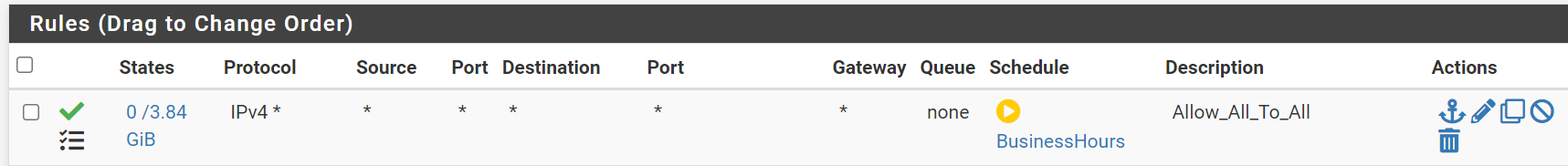

          @js50 You can use a URL alias to pull a file off a web server.
          There are time-based rules.

              @steveits - Yeah, I'm aware of the time-based rules, but for my situation I need to enable/disable rules upon demand. Thanks for the idea, though. :-)

                      @js50 Well, the first thing I would recommend is to use the schedule established in the rule.
                      In my case this has helped a lot and is a very good option.
