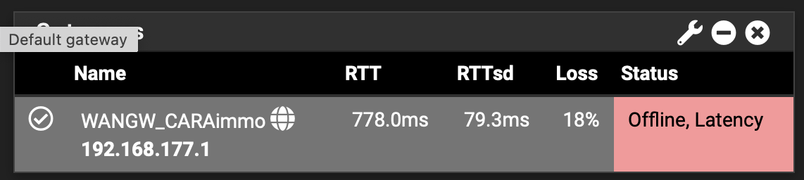

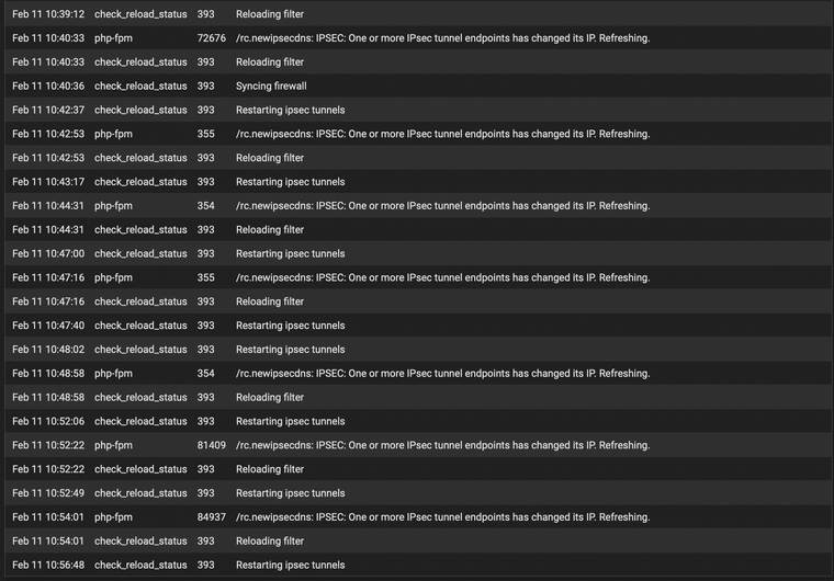

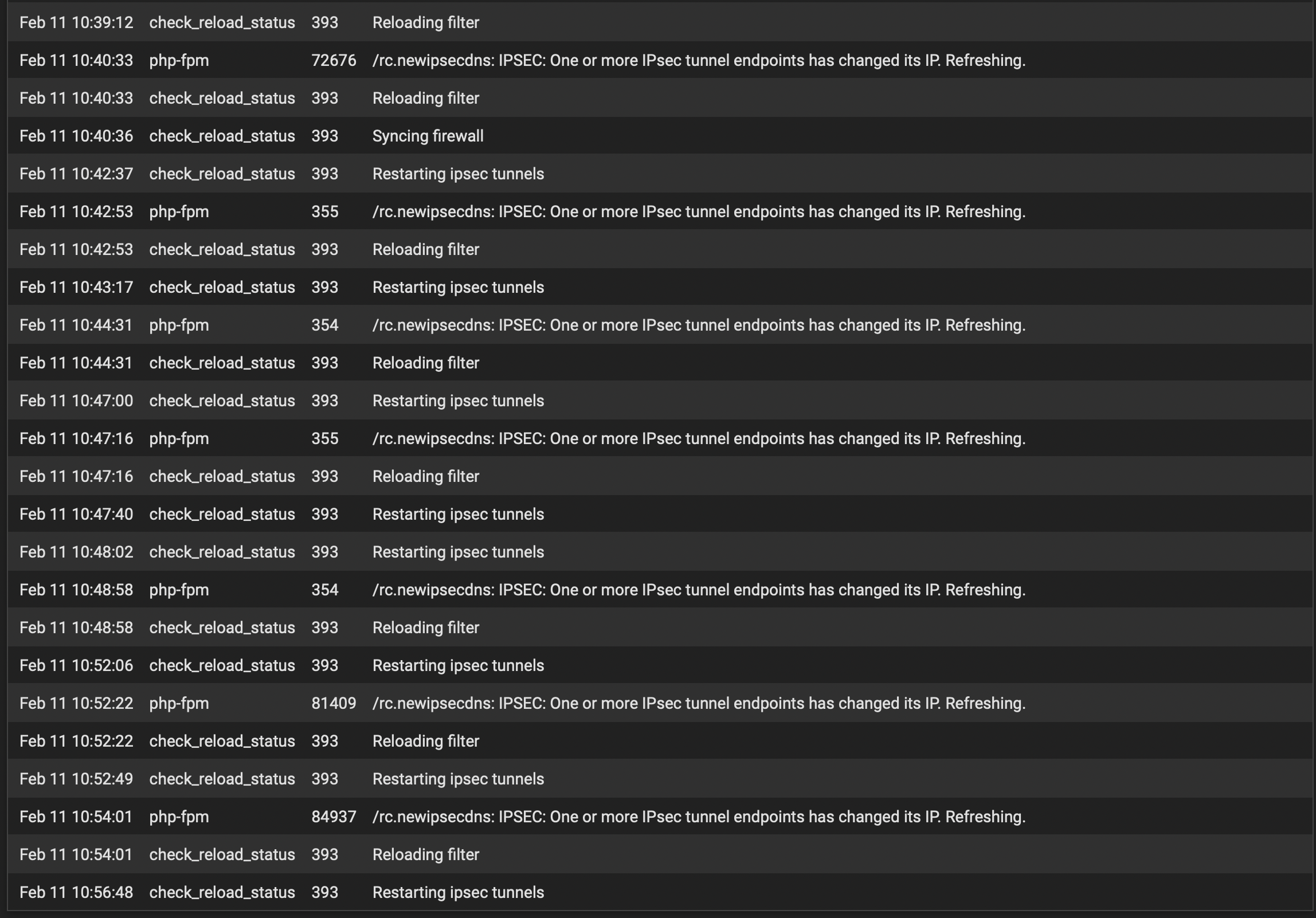

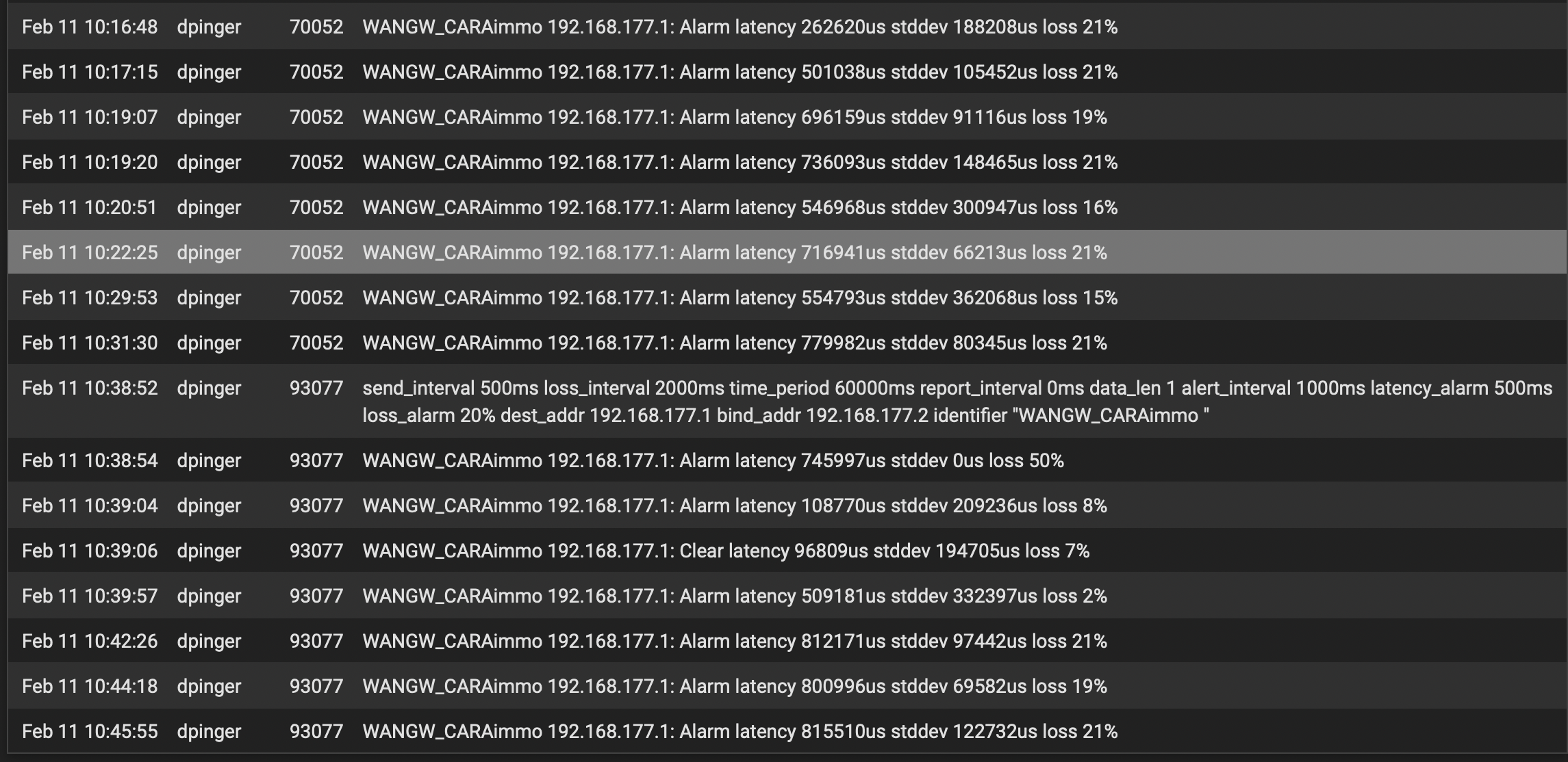

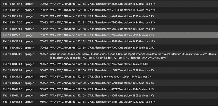

      I also attached a screenshot what the general and gateway logs look like when the gateway goes down.

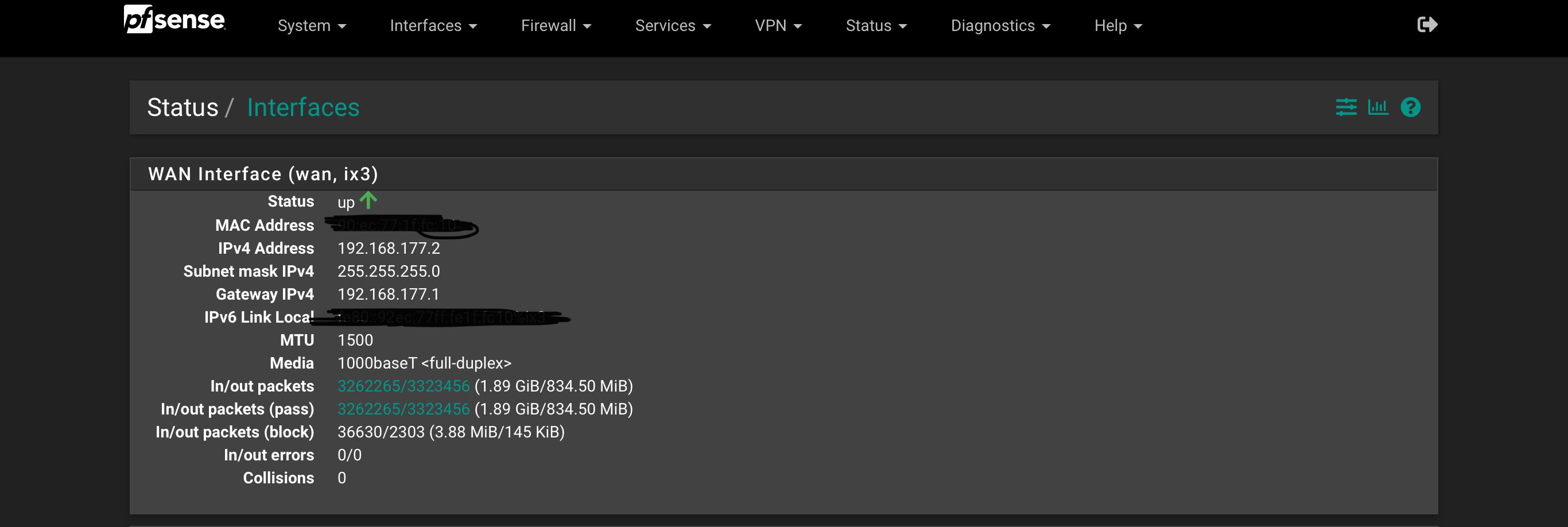

        Check out Status > interfaces to see if there are errors or collisions on WAN.

          I also attached the interfaces screenshot.

            Since the interface status doesn't show any errors or collisions, I'd also consider to replace the FritzBox for testing.
            The whole gateway monitoring happens between pfSense and FB. As you mentioned, you have already replaced the pfSense hardware and the network cable. So the last hardware part is the FritzBox.

                    So here are the logs!
                    I just want to mention, that all logs before 10.02 about 12 o‘clock are useless cause thats where I switched hardware from the ProLiant Server to the 6100. So I think you should look at the logs from this morning, cause we had about 3 packages losses today!
                    I looked through them and don‘t think that there are any public IPs or else in so should be safe to post them here!
