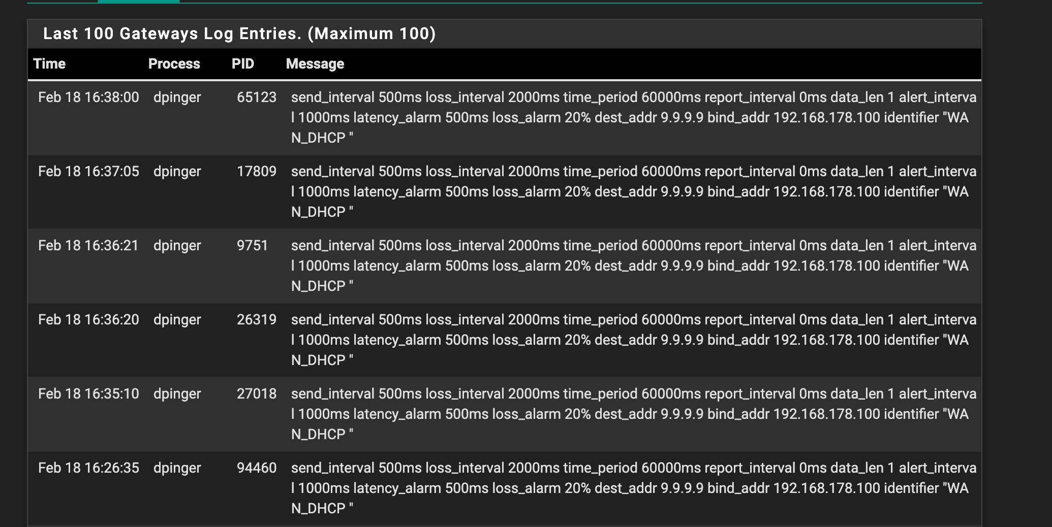

                Sorry, celebrated too early. dpinger still stops to work and I see these gateway logs. I don't quite understand why the pinger stops to work when the gateway can't be pinged. Shouldn't it keep on trying? (regardless the state of the gateway I mean?)
                I'll active service watchdog now.
                  Hmm, those logs are both dpinger starting. There are no errors on the system log in between those showing why it stopped?
