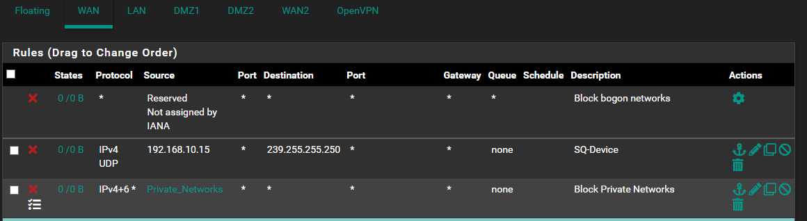

      On my private router I must necessarily connect a device that is constantly looking for other devices on the network.
      pfSense detects this and reports it in the firewall log.
      There is no configuration of this device that can prevent this search. On the other hand, I know this device and I don't care what it is doing.
      I just want to prevent me from filling my log with hundreds of identical entries, like this with ports always different:
      Feb 18 12:05:59	WAN	192.168.10.15:59095	239.255.255.250:1900	UDP
      Feb 18 12:05:59	WAN	192.168.10.15:54933	239.255.255.250:1900	UDP
      Feb 18 12:05:59	WAN	192.168.10.15:60203	239.255.255.250:1900	UDP
      Feb 18 12:05:59	WAN	192.168.10.15:45411	239.255.255.250:1900	UDP
      I have tried to put several "block" rules in the WAN, but the log still continues.

        johnpoz LAYER 8 Global Moderator @WhiteTiger-IT
        @whitetiger-it I would assume that is being blocked by the rfc1918 block rule. You can set that not to log.
        If its being logged by bogon or rfc1918 then those happen before any of your other rules, so you would have to either turn off those rules on this interface, or set them not to log.
        Then if being logged by the default rule, you could just place a rule on top of your rule list that doesn't log this traffic be it allow or block.

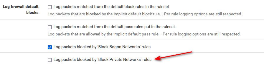

        W 1 Reply Last reply Reply Quote 1
        • W Offline
          WhiteTiger-IT @johnpoz
          @johnpoz
          Thanks for your answer.
          If I understand your suggestion correctly:
          • I have disabled the creation of the automatic rule in Interface
          • I created the rule to block the device
          • I created a rule that replaces the automatic one, adding the log of this
            @whitetiger-it yeah that works.. Or you could of just turned off logging of that rule ;)
