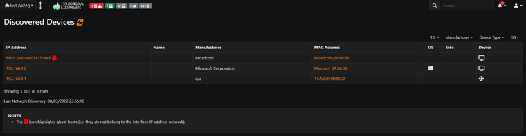

                      deanfourie
                      Ok, sure but I don't understand why I am seeing traffic with External IPS on my WAN interface,
                      This is NATed, I should only see 192.168.1.1 and 192.168.1.2?
                      Its showing as a HOST on the WAN interface.
                      Thanks
                        Mmm, that's fun!
                        That's a Huawei MAC address. I would expect that to be the 4G routers WAN interface?
                        I would not expect to see that on the LAN side. Something buggy/poorly configured there.
                        pfSense doesn't care though it will just block it.
                          deanfourie @stephenw10
                          @stephenw10 that's on pfSense WAN interface.
                          I think something suspicious is going on tbh
                            Right it's on the internal side of the 4G router, where I would not expect to see the public IP.
                              @stephenw10 exactly. Should I be worried?
                                Not excessively because pfSense will just block it anyway. It implies that the 4G router is doing something it shouldn't. Hanlon's razor dictates it's probably just buggy firmware.
                                  @stephenw10 but it's possible if the huwawei is compromised, then everything is going through it is vaulnarable to being intercepted?
                                  Thus, why I don't like it being an upstream gateway rather then being in bridged mode, it's another node sitting on my WAN interface which I cannot intensively monitor.

                                      deanfourie
                                      This was pulled from my logs today.
                                      Mar 3 09:17:33 arpwatch 94050 bogon 0.0.0.0 b4:ae:2b:2d:f0:a9
                                      Mar 3 09:17:34 arpwatch 94050 bogon 0.0.0.0 b4:ae:2b:2d:f0:a9
                                      Mar 3 09:17:35 arpwatch 94050 bogon 0.0.0.0 b4:ae:2b:2d:f0:a9
                                      They are everywhere
                                      Mar 3 14:17:34 arpwatch 94050 bogon 0.0.0.0 b4:ae:2b:2d:f0:a9
                                      Mar 3 14:17:35 arpwatch 94050 bogon 0.0.0.0 b4:ae:2b:2d:f0:a9
                                      Mar 3 14:18:00 sshguard 69810 Exiting on signal.
                                      Mar 3 15:11:05 arpwatch 94050 bogon 0.0.0.0 78:24:af:36:1a:08
                                      Mar 3 15:11:06 arpwatch 94050 bogon 0.0.0.0 78:24:af:36:1a:08
                                      Mar 3 15:11:07 arpwatch 94050 bogon 0.0.0.0 78:24:af:36:1a:08
                                      Mar 3 15:11:08 arpwatch 94050 bogon 0.0.0.0 78:24:af:36:1a:08
                                      and the list goes on
                                      Also, I cannot change the LAN subnet mask? What is up with this router? I've never seen that before.
                                        deanfourie
                                          deanfourie
                                          Ok, so this is starting to look a little bit strange. In ntopng I have devices that are appearing as ghost hosts, and this moves around between devices. This is not a simple network misconfiguration on a basic /24 network.
                                          Now I'm seeing every time a host connects to the network, there is a ARP entry for that hosts MAC address to ip 0.0.0.0. These constantly change between hosts.
                                          This looks very suspect to me.
                                            Those are known MAC addresses though? Looks like hosts connecting and broadcasting for DHCP servers to me. Which would be totally normal.
