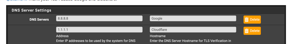

          Ashkaan @akuma1x
          @akuma1x Thank you! Yes, I added Google and Cloudflare.
          alt text
          I've tried both the Resolver and Forwarder and have the same issue. I factory reset pretty early on it with the same result. My first run with PFSense was almost completely default and I had the same issue. I'm totally baffled by this.
