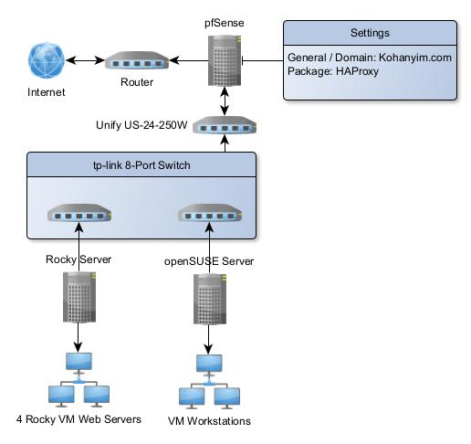

@smalldragoon this is what my infrastructure looks like:
and I have 4 Certs, 3 Single's and a wildcard, kohanyim.com, www.kohanyim.com and two others. These Certs are used to encrypt my network and my 4 public web servers. It took me a while to figure out how to separate and point both kohanyim sites to there own server without trying to figure out how to get Shared Frontend to work (never did), but after listening to How To Setup ACME, Let's Encrypt, and HAProxy HTTPS offloading on pfsense several times I finally got it.
For me to get this to was:
- Need your default SSL Offloading / Certificate, I use the Wildcard Cert and make sure "Add ACL for certificate Subject Alternative Names" is checked.
- add SSL Offloading / Additional certificates, the Single Cert. NOTE: This is what I needed to get this to work!
The video explains why this portion is important and I hope this helps.
