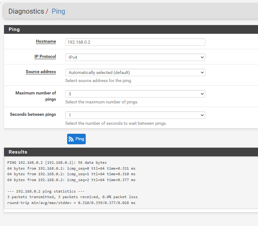

      im trying to make a Net2Net Bridge using 2 Pfsenses connected over WAN using Openvpn and TAP Connection.
      Im using this Manual
      https://docs.netgate.com/pfsense/en/latest/recipes/openvpn-bridged.html
      Both Sides have 192.168.0.0/24
      Pfsense in Netz A has 192.168.0.1
      Pfsense in Netz B hats192.168.0.2
      Im able to ping both Pfsenses from each other but have no access to the other Devices within the same subnet (192.168.0.0/24
      Example:
      So - the ovpen Connection betwenn both Bridge ends is Up - both Ovpen Devices are UP - i can ping each Pfsense from the ohter one over the Bridge.
      But im not able to ping any other Device on the ech other side.
      I hope anyone have a idea whats wrong or what can i do ?
