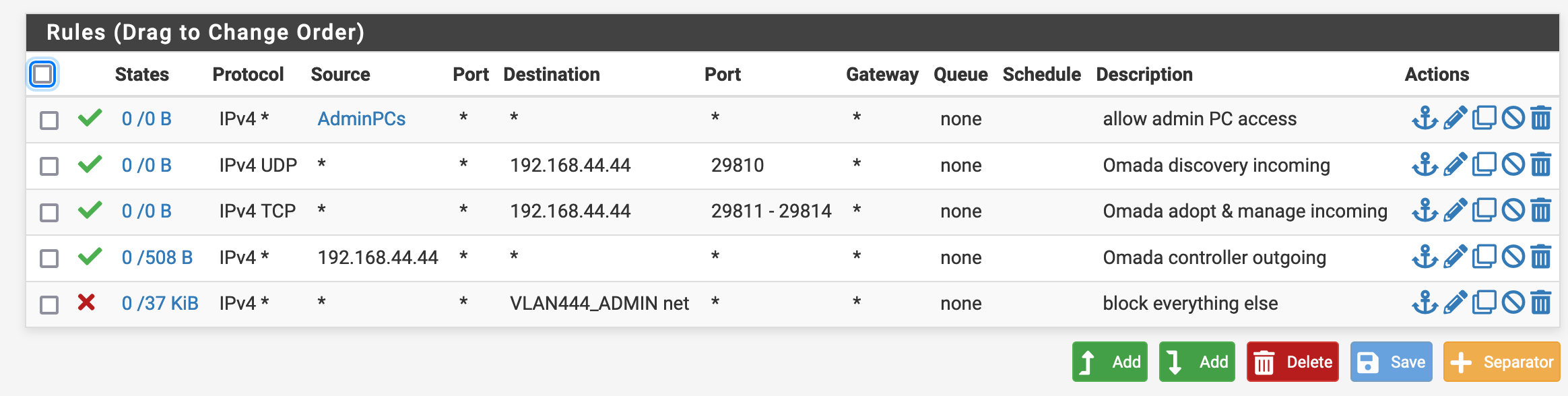

              And the firewall rules look like this:
              Here the alias AdminPCs does NOT contain 192.168.9.14

                  @johnpoz The rules provided in the screenshot are on the VLAN444 (192.168.44.0/24) interface. VLAN444 is an admin VLAN which we want to isolate per the rules screenshot, so that only a few specific things can reach in to VLAN444.
                  "if you don't want 192.168.9 to ping 192.168.44 then the rules would be on the interface 192.168.9 network is, not on the vlan444'
                  I could be wrong but that is not how I understand it. We have 12 more VLANs besides just VLAN9 (192.168.9.0/24) and we don't want anything coming into VLAN444 (except for the rules in the screenshot), nor do we want any other VLAN cross-talk for the most part. The way you state it suggests we have to add a deny outgoing to VLAN444 rule on every VLAN interface other than VLAN444. That seems like an awful lot of work. Why not use a deny rule on VLAN444 so that nothing can come into the VLAN444 network? That is one rule rather than 12, and it wouldn't need updated every time we add another VLAN.
                  "Those rules you show, 192.168.44 talking to 192.168.44 would have nothing to do with pfsense.. How would their ever be source of 192.168.44.44 unless those rules were on the 192.168.44 interface. So your rules make no sense."
                  I don't see any rules that say anything about 192.168.44 talking to 192.168.44 Can you elaborate? My reading of the rules are:
                  1. allow admin PCs (192.168.9.53-55) to talk to anything on 444
                  2. allow anything on any VLAN to talk to 192.168.44.44 on UDP port 29810
                  3. allow anything on any VLAN to talk to 192.168.44.44 on port TCP ports 29811-29814
                  4. allow 192.168.44.44 to reach out to any VLAN or internet
                  5. block anything else from reaching in to VLAN444
                  Is there an error in that interpretation of the rules?
                    The rules you posted you show destination to 44.44 Is that pfsense IP? On this vlan - why would you not then use the vlan ADDRESS alias... You are then on the bottom blocking all access to vlan 444, on the 444 interface.. Which pfsense has zero control over, router has nothing to do with devices on the same network talking to each other.
                    As to a lot of vlans and not wanting to set all the rules on each interface - then using floating to create your rules where you can apply to multiple interfaces. But what you have posted you clearly need to readdress your understanding of how rules are applied... And I don't think you vlans are setup and working how you think they are since in if I have vlan 44 with IP 192.168.44/24 address - how would I have source traffic of 192.168.9 entering that interface? Unless this was a transit network? Which you make no mention of, and sure wouldn't use my admin vlan as a transit..
                    Those rules need to be on the 192.168.9 interface, not 444 interface.. Again rules are evaluated as traffic enters an interface..
                    Why would I want to filter traffic after the traffic has already entered the firewall and ready to leave, you wold block traffic you don't want to allow at the interface where it would enter the firewall. If you don't want vlan X to go to Y, then that rule would go on vlan X interface. If you want Y to be able to talk to Z but not X then those rules would go on Y..
                    Or you can put rules in the floating tab.. You can even do outbound direction rules on floating.. But for ease of reading and understanding of rules I woud highly recommend you take the time to put the rules on the specific interface. Will make traffic control way easier to manage going forward if rules are directly on interfaces vs having to figure out floating tab with a bunch of rules and different interfaces rules applied to and in what direction, etc. etc.. Now if you had 100 interfaces ok - but a hand full.. It doesn't take that long to create rules, especially basic like block access to the other rfc1918 networks.. Simple alias and simple rule placed on the interfaces..
