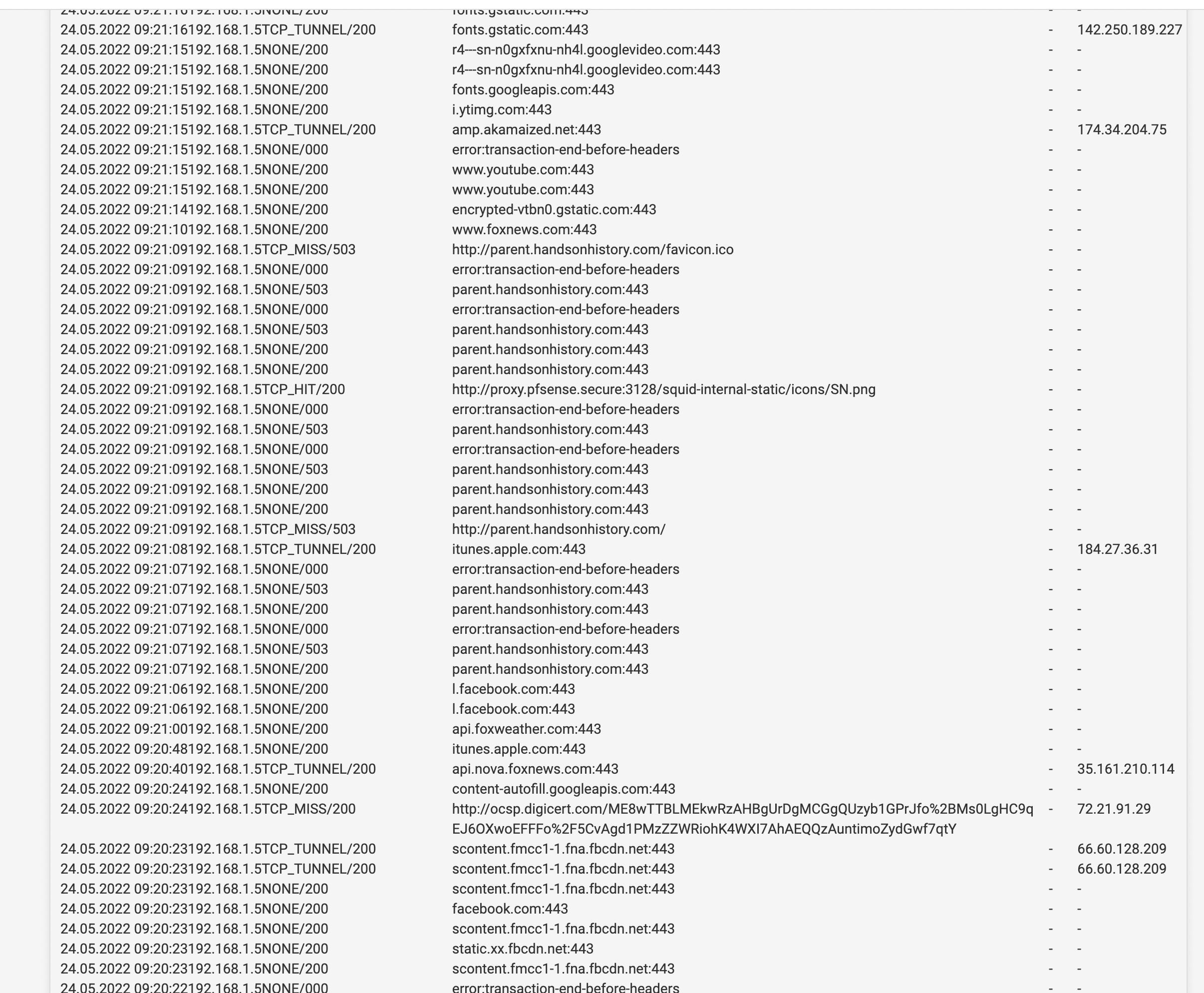

    (Image: Hits only show for HTTP currently)
    I have created and installed certificates and they seem to be working. I can see traffic generated however I see tunnel a lot in the live logs. When using the "custom option" on SSL you must configure the option in advanced. I am testing custom out. I am hoping you can shine some light on what would be the best settings in a home network, all devices have certificates except the Xbox.

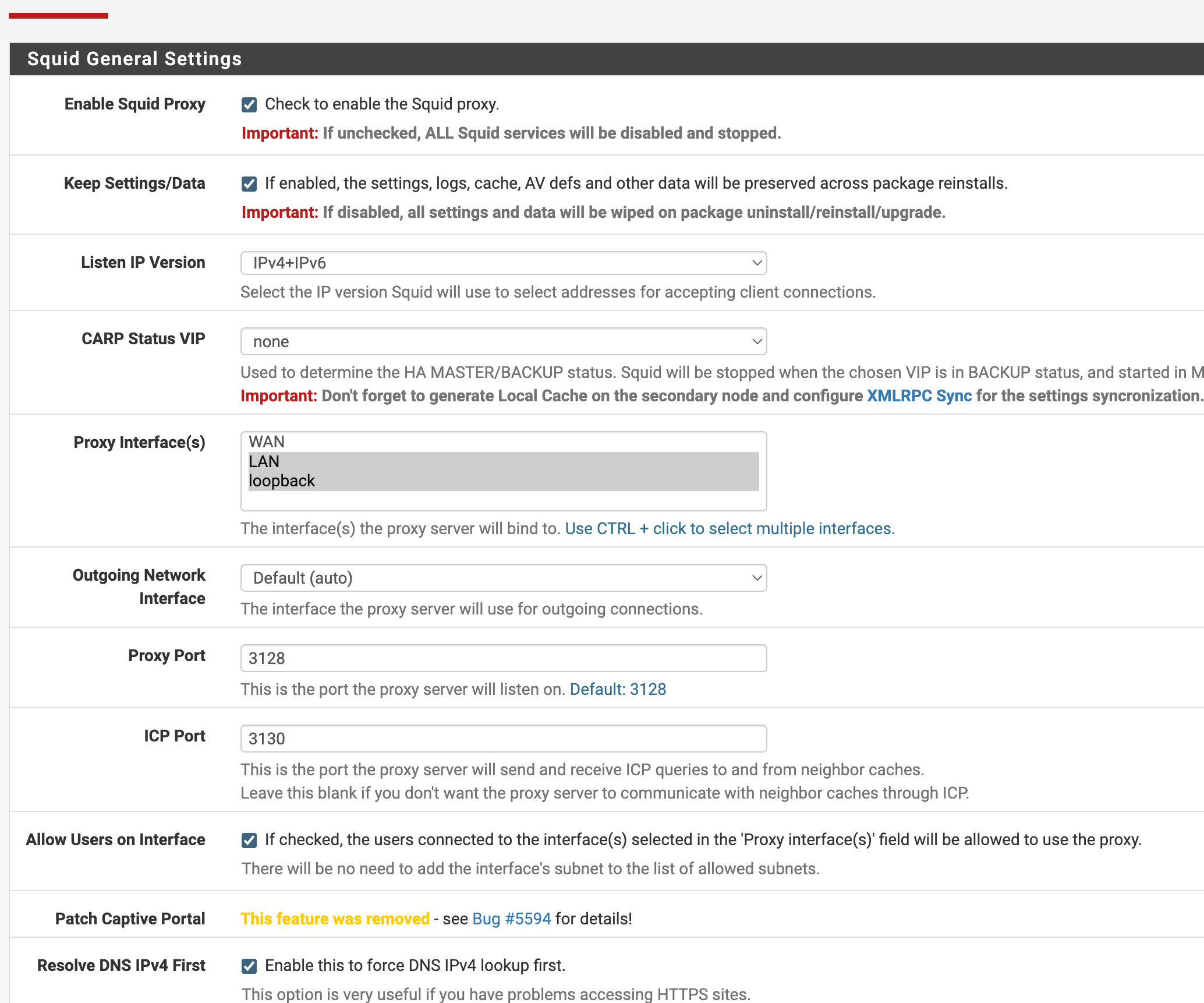

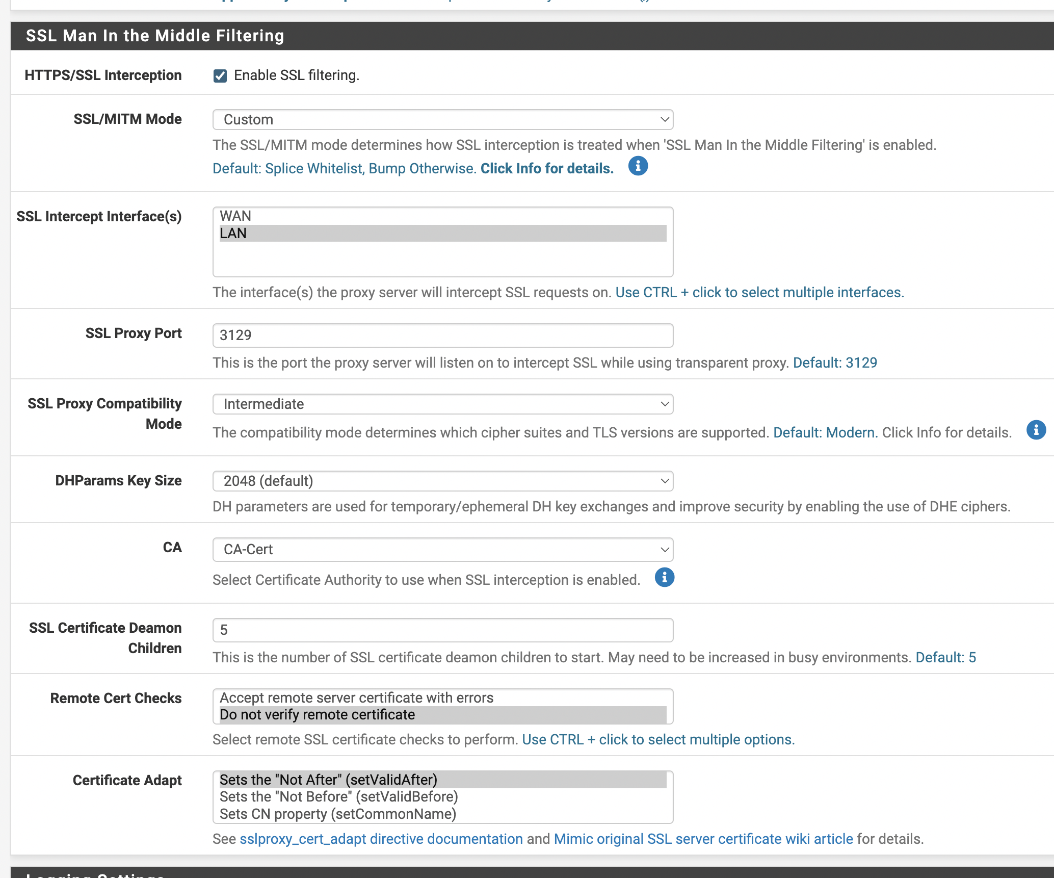

    (Image: Port 3129)
    I noticed I can not use port 3129 for anything or the internet stops when that is turned on for proxy use, however it works if I still use the 3128 listener port.
    (Image: Local settings still set to 3128)
    (Image: Port 3128)

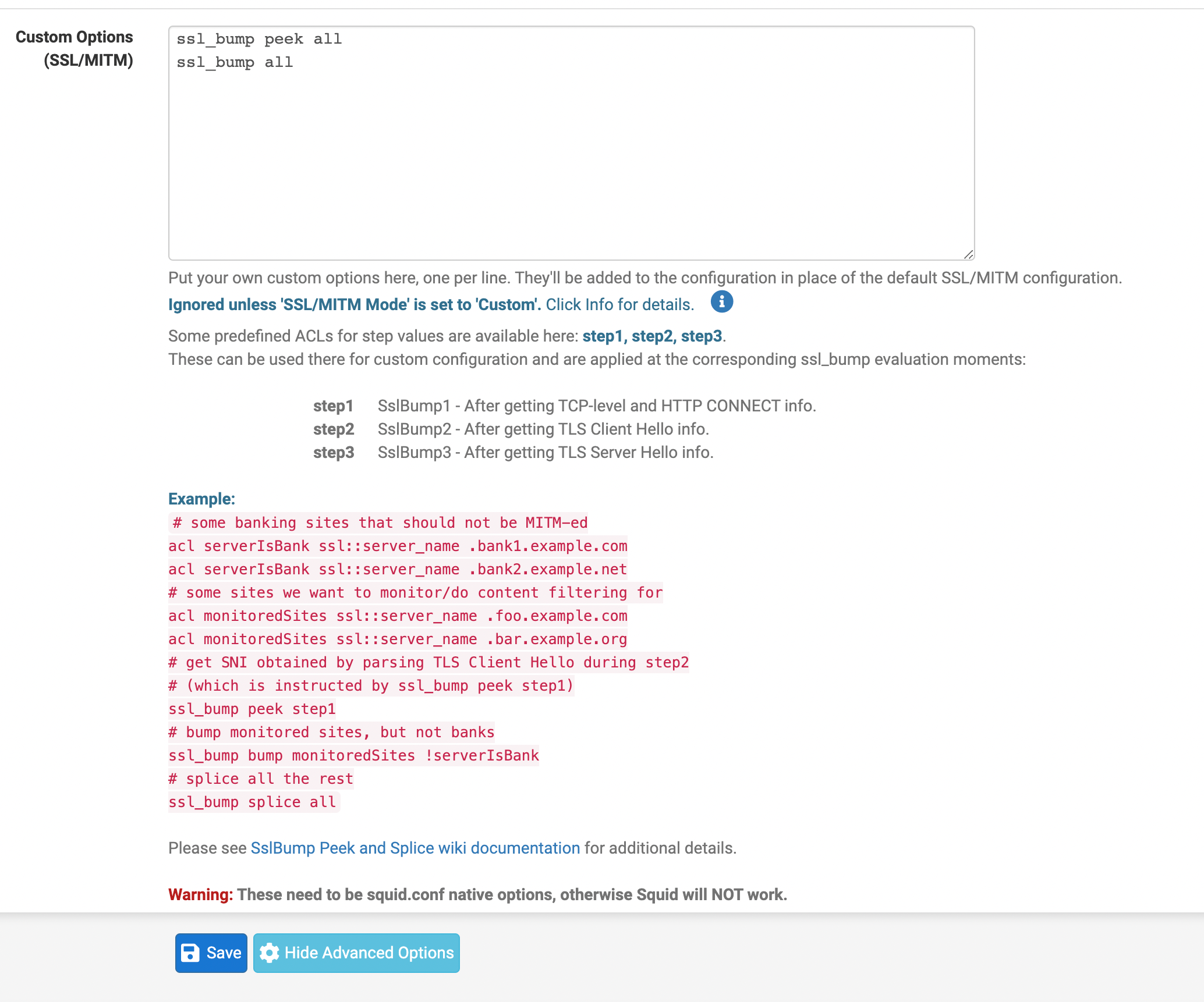

    ssl_bump peek all
    ssl_bump all
    ssl_bumb peek step1
    ssl_splice all
    ssl_bump peek all
    ssl_bump splice all

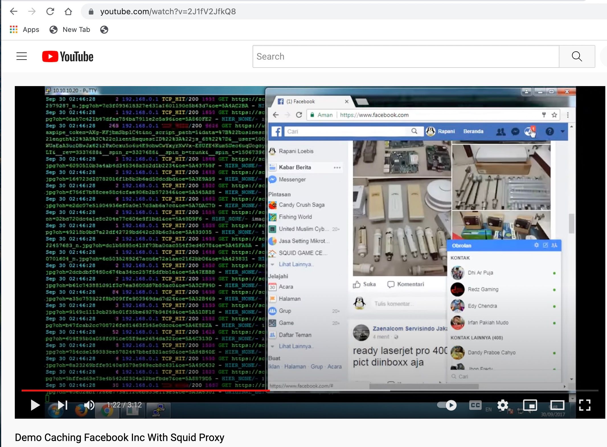

    I have noticed online that some users are able to cache HTTPS items. However I am still trying to get this to work correctly. Are they using wget?
    (Image: Youtube Squid use with many hits for HTTPS for Facebook)
    Any recommendations I use to think this was not possible however I have been seeing youtube posts of HTTPS caching working for Squid?

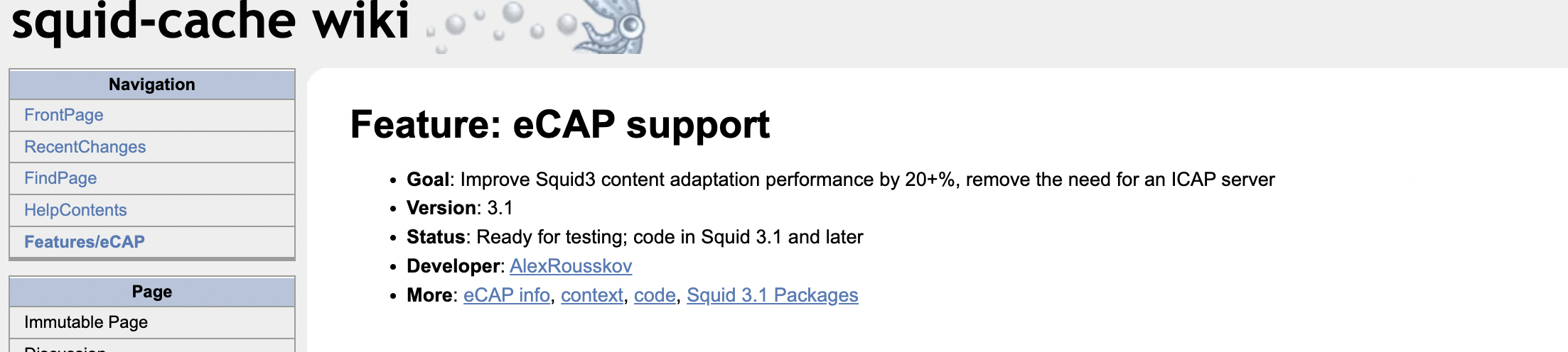

    I have also been reading about ecap use over icap for performance gains.
    (Image: Squid's Web Page on ECAP use)

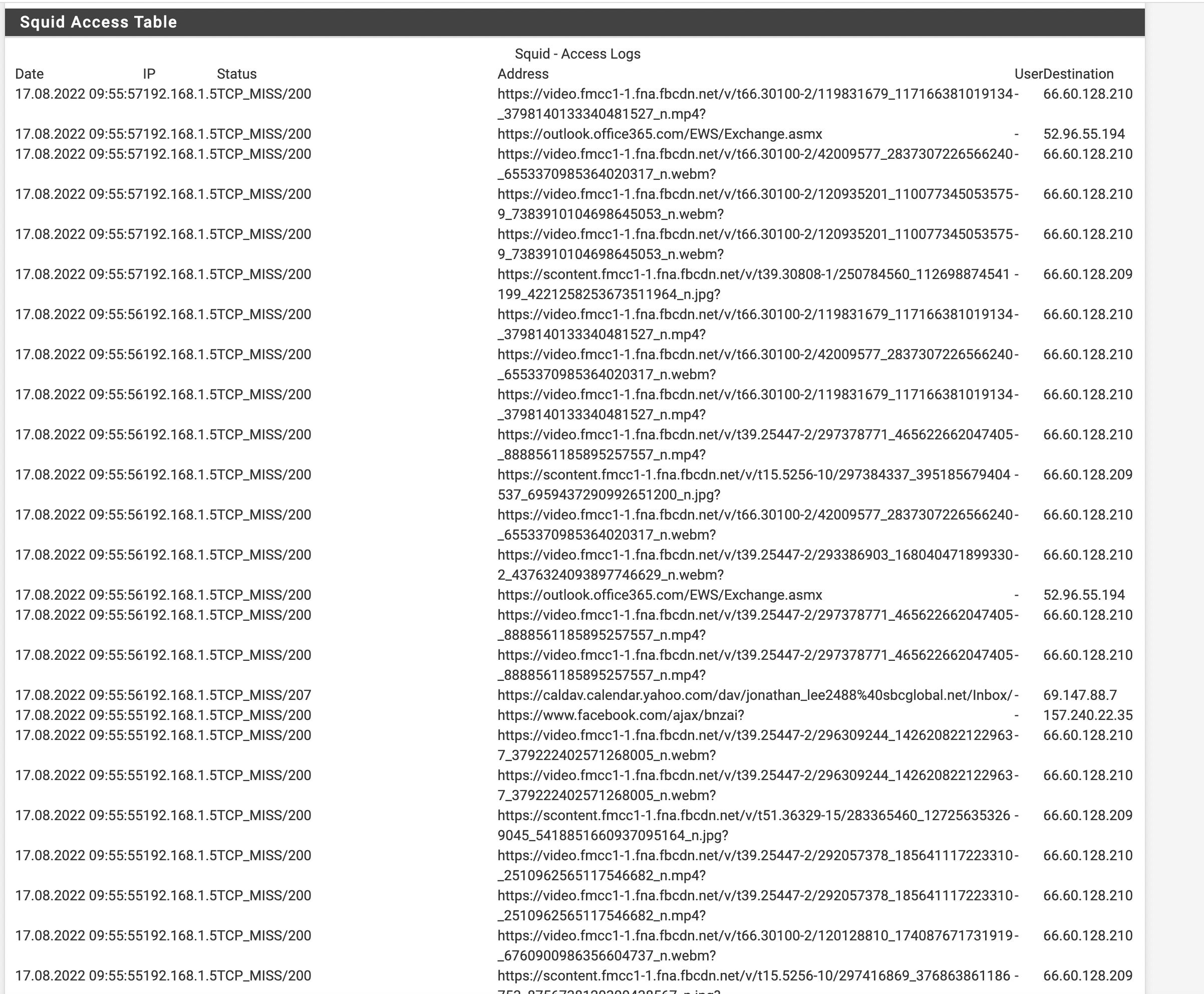

      (IMAGE: Best setting I have found so far to match above with HTTPS CACHE WARNING THIS MANY NOT WORK IN ALL AREAS, YOU MUST OWN DEVICES AND INSTALL CERTIFICATES ON THEM TO USE THIS FUNCTIONALITY THIS MIMICS ENTERPRISE FIREWALLS LIKE PALO ALTO SYSTEMS)
      This was my best setting for high cache rates with HTTPS
      The 192.168.20.11 is a device that can not install a certificate so it is marked as splice only.
