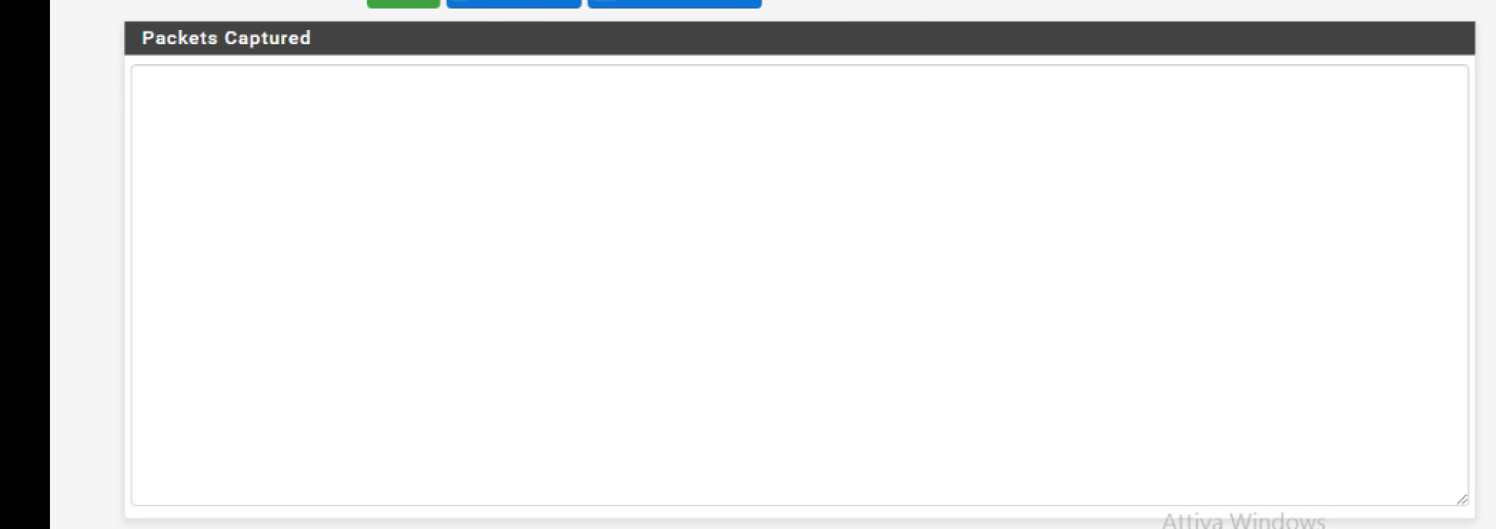

                  Sergio77 @viragomann
                  @viragomann I did the test, but my capture log is empty...Schermata 2022-06-01 alle 11.32.06.png Schermata 2022-06-01 alle 11.32.17.png Schermata 2022-06-01 alle 11.32.47.png
                  • V Offline
                    viragomann @Sergio77
                    @sergio77
                    In the host box enter the destination IP you“re pinging not a source.

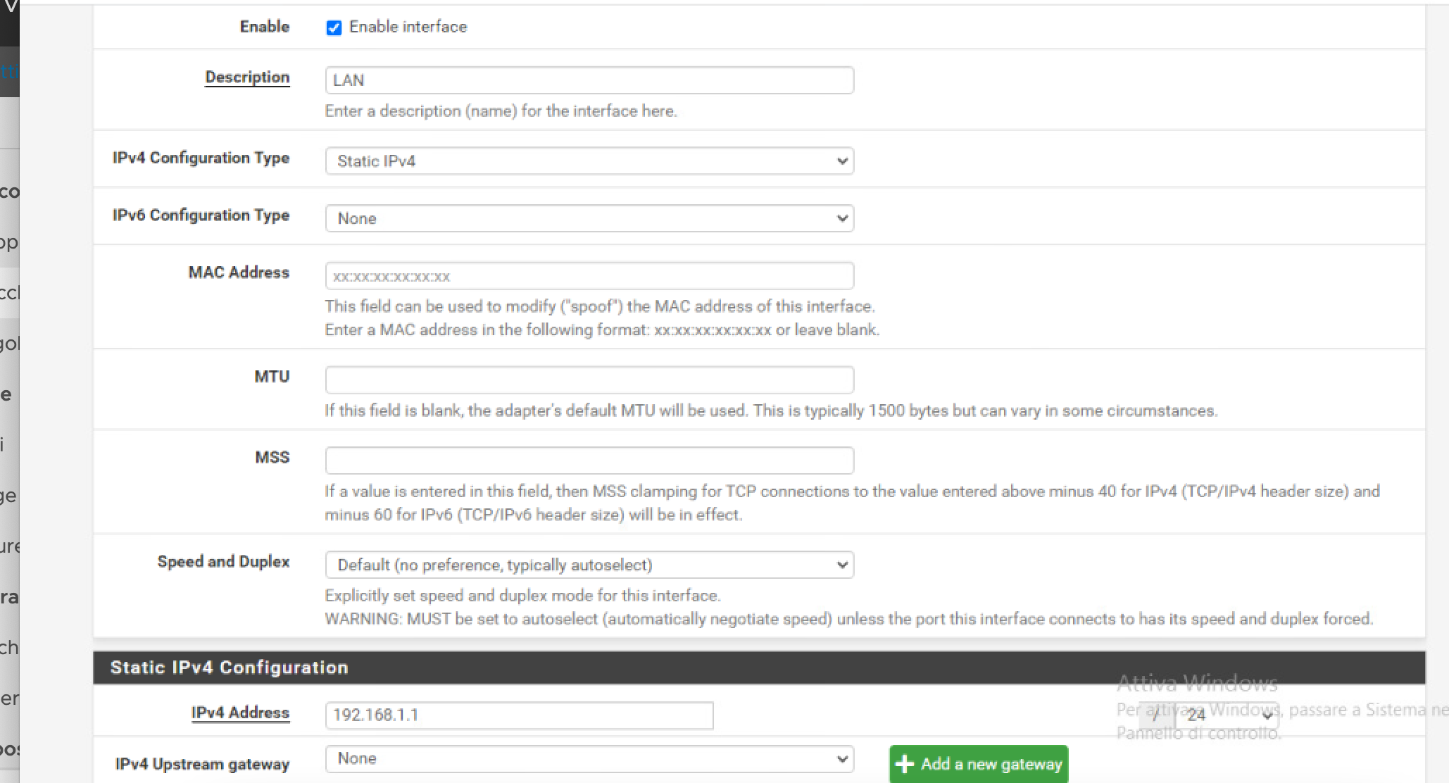

                            @sergio77
                            Did you specify an gateway IP address in the LAN interface settings? If so remove it, please.
                            S 2 Replies Last reply Reply Quote 0
