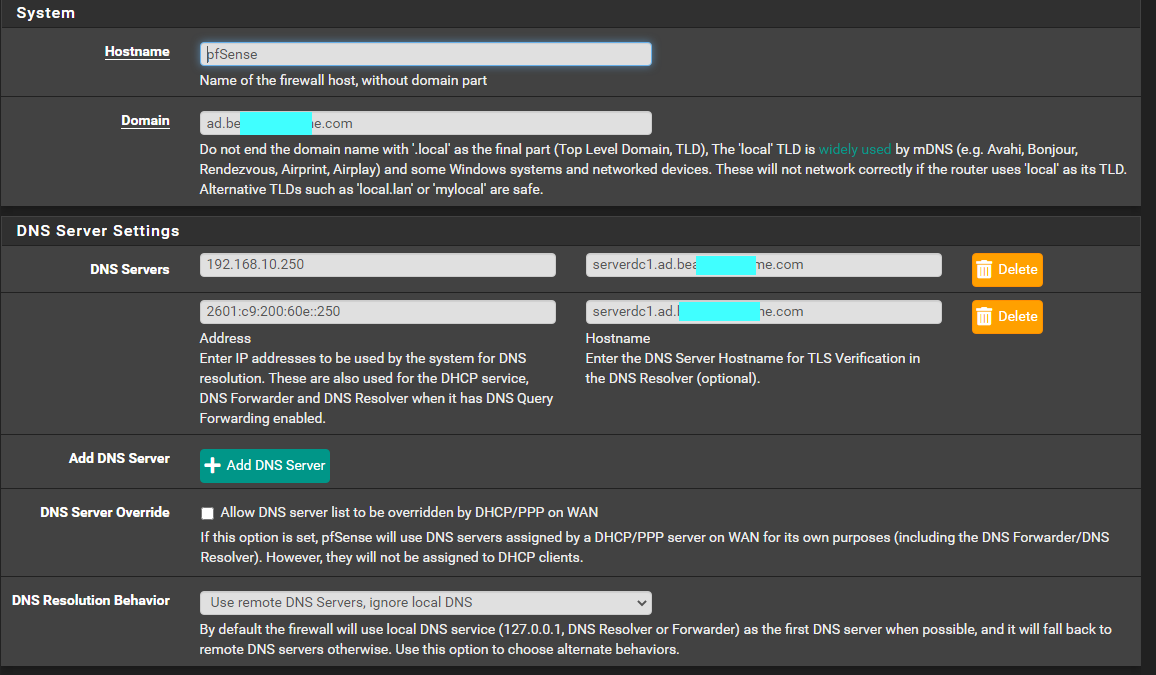

                @steveits
                OK - I went here and added these settings - seems to have improved things:

                  I helped you in your other thread. I think you misunderstood something I was trying to convey over there.
                  I had you temporarily disable DNS Resolver as part of some troubleshooting on a client (when that client seemed to be using pfSense when it should not have). I did not mean to leave DNS Resolver permanently disabled on pfSense!
                  pfSense itself always needs a DNS server defined. That server can either be the local DNS Resolver (unbound) or the older and deprecated DNS Forwarder (dnsmasq). Or you can specify some other DNS server on the DNS Settings section of GENERAL SETUP.

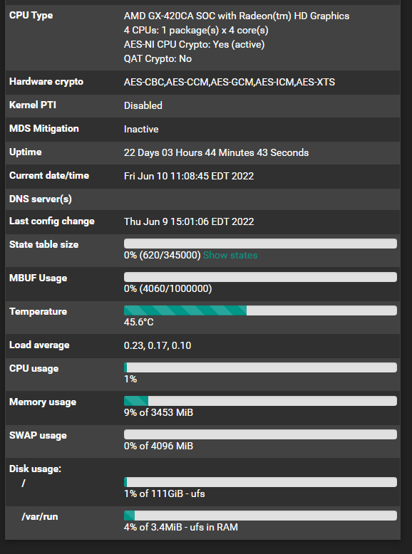

                            If you have that kind of CPU load for hours, then something would obviously be "not optimal".
                            As @SteveITS says, slow DNS lookups can present as a stalled Internet experience because everything runs on hostnames/domain names that need to be resolved. But that may not be the only issue you have. That high CPU loading bears investigation as well. Is the VM trying to do some series of updates? Is there a disk I/O bottleneck perhaps? If the VM with that CPU utilization is your AD DNS host, then name resolutions could definitely be impacted.
                            The pfSense GUI (especially the landing or home page) attempts to perform a DNS lookup when checking for the most recent version. If DNS is sluggish, ,then the display of the home page is sluggish. But not every action you take in the pfSense GUI results in a DNS lookup. In fact, most do not. So is the pfSense GUI slow everywhere no matter when menu section you are on, or is it only slow when on the "home page" dashboard?

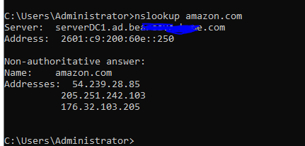

                              @bmeeks

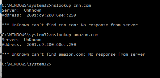

                              Yes -- When I do this from the domain controller -- it comes back within a second.

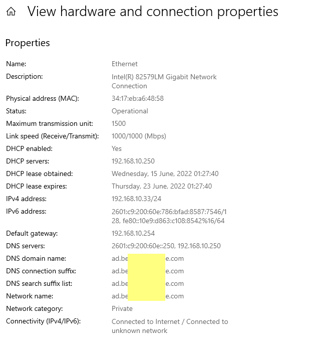

                              From the other Windows machines -- I get this:
                              They have not been joined to the domain.. but they are pulling an IP address from the DHCP on the AD DS and the network configs look correct for GW, SNM and DNS.
                              This is one of the Windows boxes (not the AD DS)
                              S bmeeksB 2 Replies Last reply Reply Quote 0
                                SteveITS Galactic Empire @bearhntr
                                @bearhntr Seems like your server isn't responding to DNS on its ::250 address, except to itself. Is its firewall blocking IPv6?
                                That shouldn't affect the pfSense GUI at all though.
                                Upvote ๐Ÿ‘ helpful posts!
                                bearhntrB 1 Reply Last reply Reply Quote 0
                                • bmeeksB Online
                                  bmeeks @bearhntr
                                  @bearhntr said in pfSense 2.5.2 - Web Console super slow:
                                  @bmeeks
                                  Isn't the subnet on the Windows client's IPv6 address incorrect? Been a while since I've used IPv6 in my domain due to being put behind CGNAT by my ISP, but the IPv6 subnet should be /64 instead of /128, I believe. An incorrect subnet mask would explain why your clients are unable to talk to the AD DNS server.
                                  S bearhntrB 2 Replies Last reply Reply Quote 1
                                    SteveITS Galactic Empire @bmeeks
                                    @bmeeks said in pfSense 2.5.2 - Web Console super slow:
                                    Yes. So, the PC can't talk to anything else over IPv6.
                                    If one configures DHCPv6 on Windows, it does that. Also Windows DHCPv6 doesn't configure a gateway, because that's not how IPv6 was designed to work. In summary, many years ago I banged my head on it for a while and decided it was pointless trying to use Windows DHCPv6, and to just let the router handle IPv6, as designed. Then set pfSense to use a domain override to forward those DNS requests to the local AD DNS as discussed.
