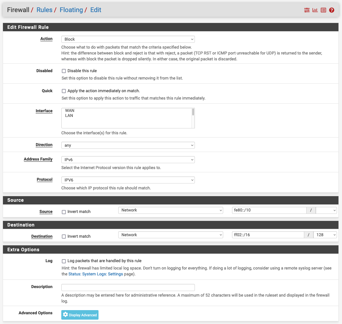

          So the workaround is to enable IPV6 traffic in the system advanced settings but then to create a top rule to block all IPV6 traffic but disable logging for that rule.
          Would the rule be like this (floating rule?)

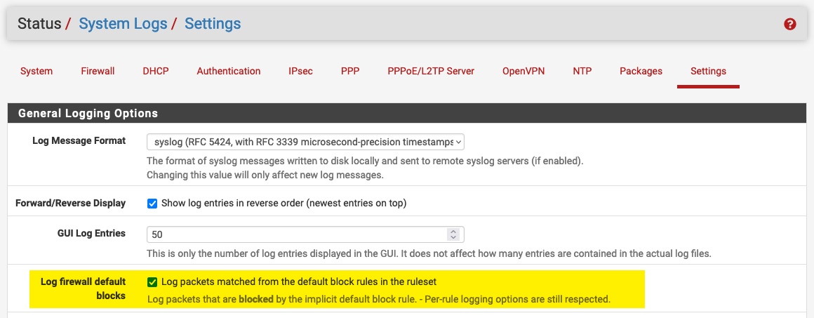

          Option2:
          For this case, the option would be to untick this one?
          That would only impact firewall logging right? not all other logs?

            @mcding yeah option 2 would just be firewall logging of the default deny rule.
            It "might" turn off that logging of the block IPv6 rule as well? I haven't looked into that - but that block all IPv6 rule is different than the default deny so I would doubt turning off default deny logging would also disable logging of the do not allow IPv6 rule that is created.
