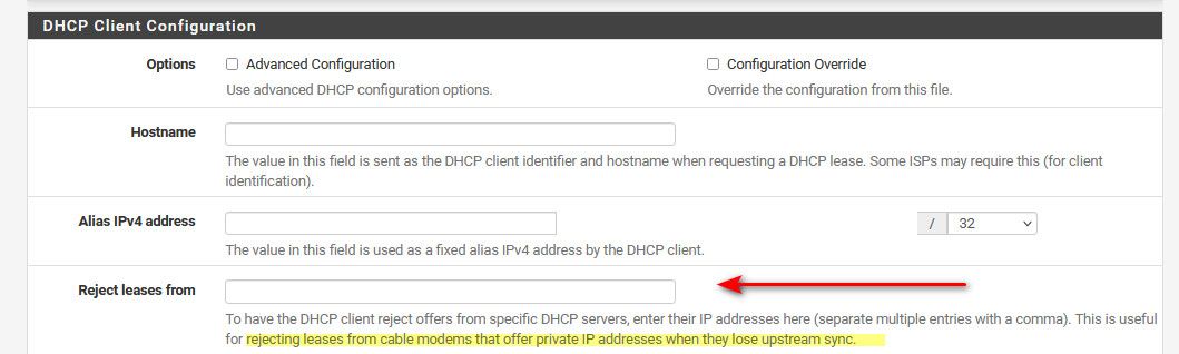

        2nd option, while personally have never ran into it - is set advanced options in wan dhcp client not to accept dhcp from 192.168.100.1 - this is common IP for cable modems for web gui, and they will hand out IPs in that range when they don't have a internet connection.

        edit: see here under reject dhcp from
        https://docs.netgate.com/pfsense/en/latest/interfaces/configure-ipv4.html#dhcp
        On your wan interface
          mrneutron @johnpoz
          @johnpoz, thank you for that reject DHCP suggestion! I will try that immediately. 👍
