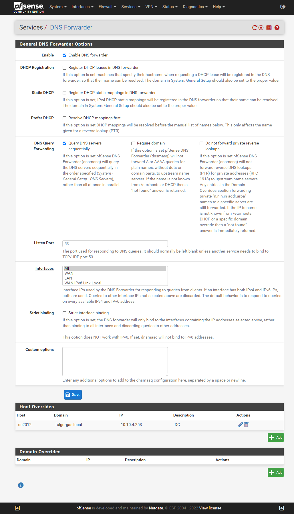

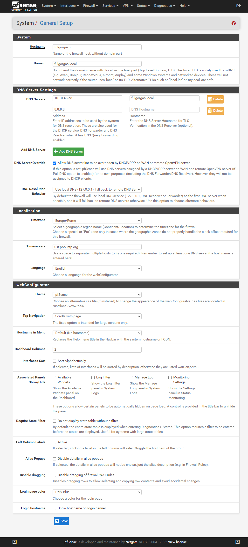

              @viragomann I tried to do the configuration preferring DNS Forwarder, but it still fails to resolve. I sent all the configuration screens of the pfsense Site B, where am I wrong?
              SedeB_10.10.2.254_system.php.png SedeB_10.10.2.254_services_unbound.php.png SedeB_10.10.2.254_services_dnsmasq.php.png

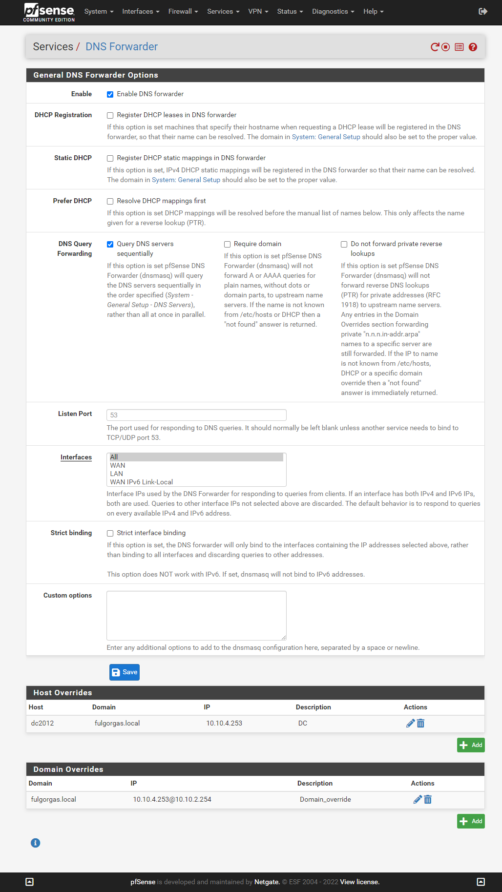

                  vettalex @viragomann
                  @viragomann Hi, I solved! Your advice got me reasoning. I send you the configuration done:10.10.2.254_services_dnsmasq.php.png
