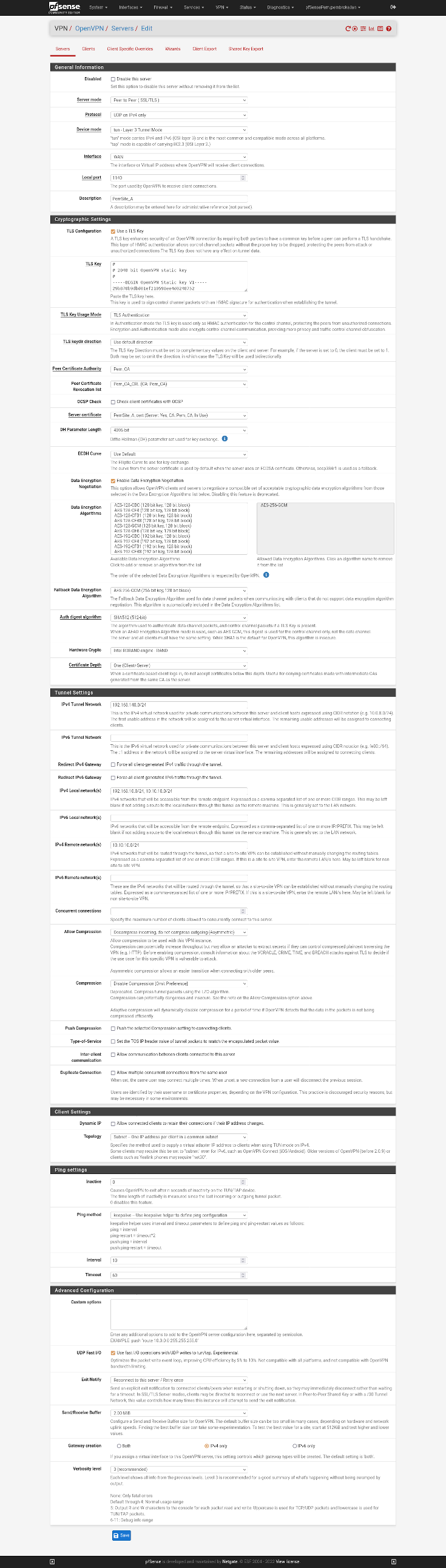

      My vpn server setup looks like this:

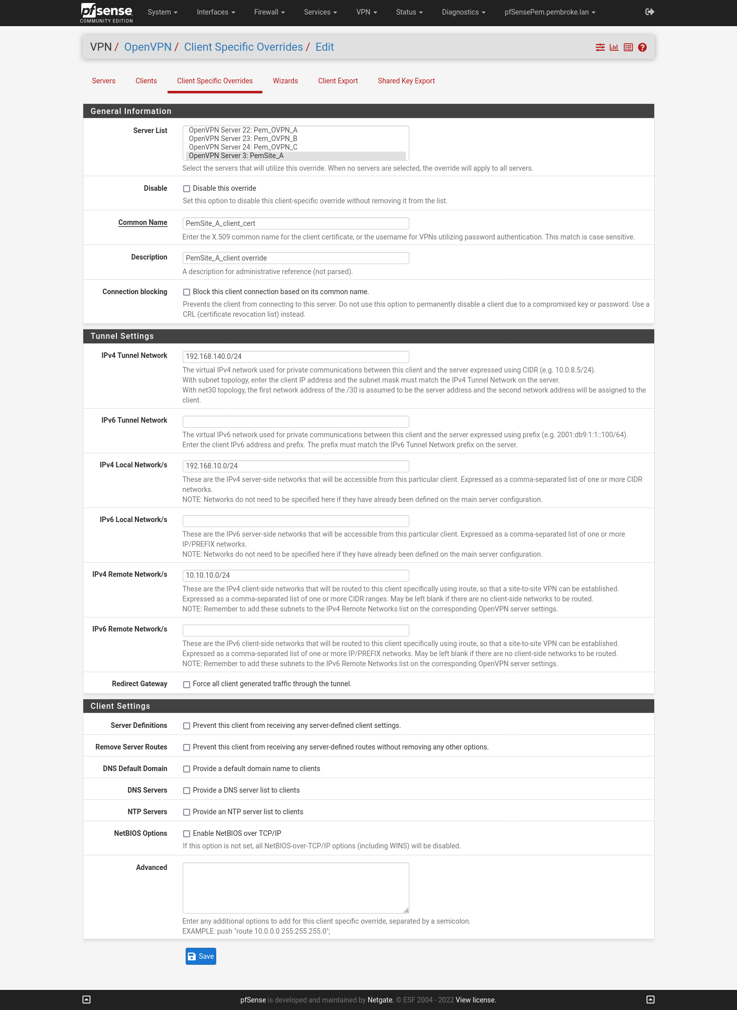

      My Create Client-Specific Overrides look like this:

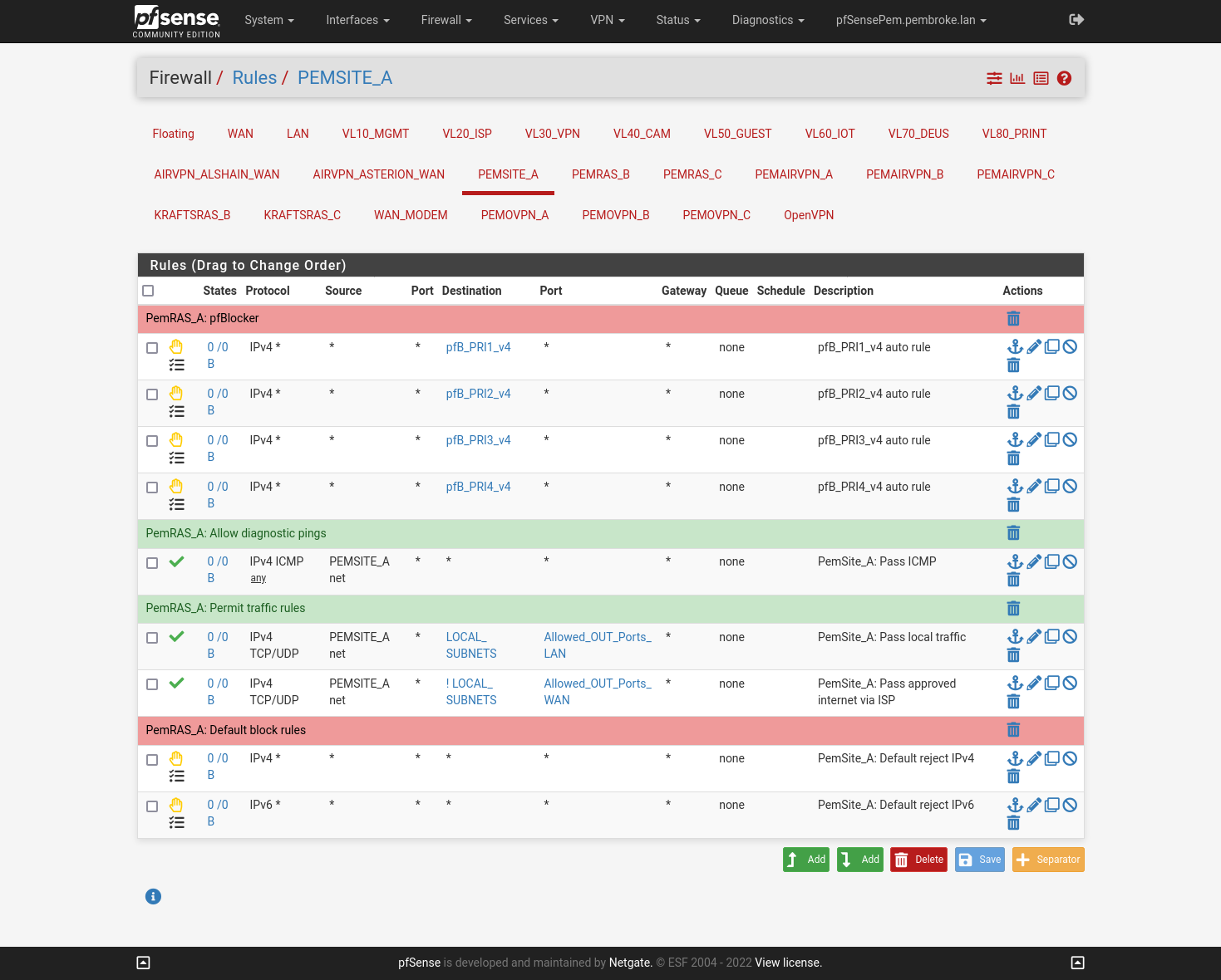

      My firewall rules for the interface look like this, in the alias all subnets I use are included:

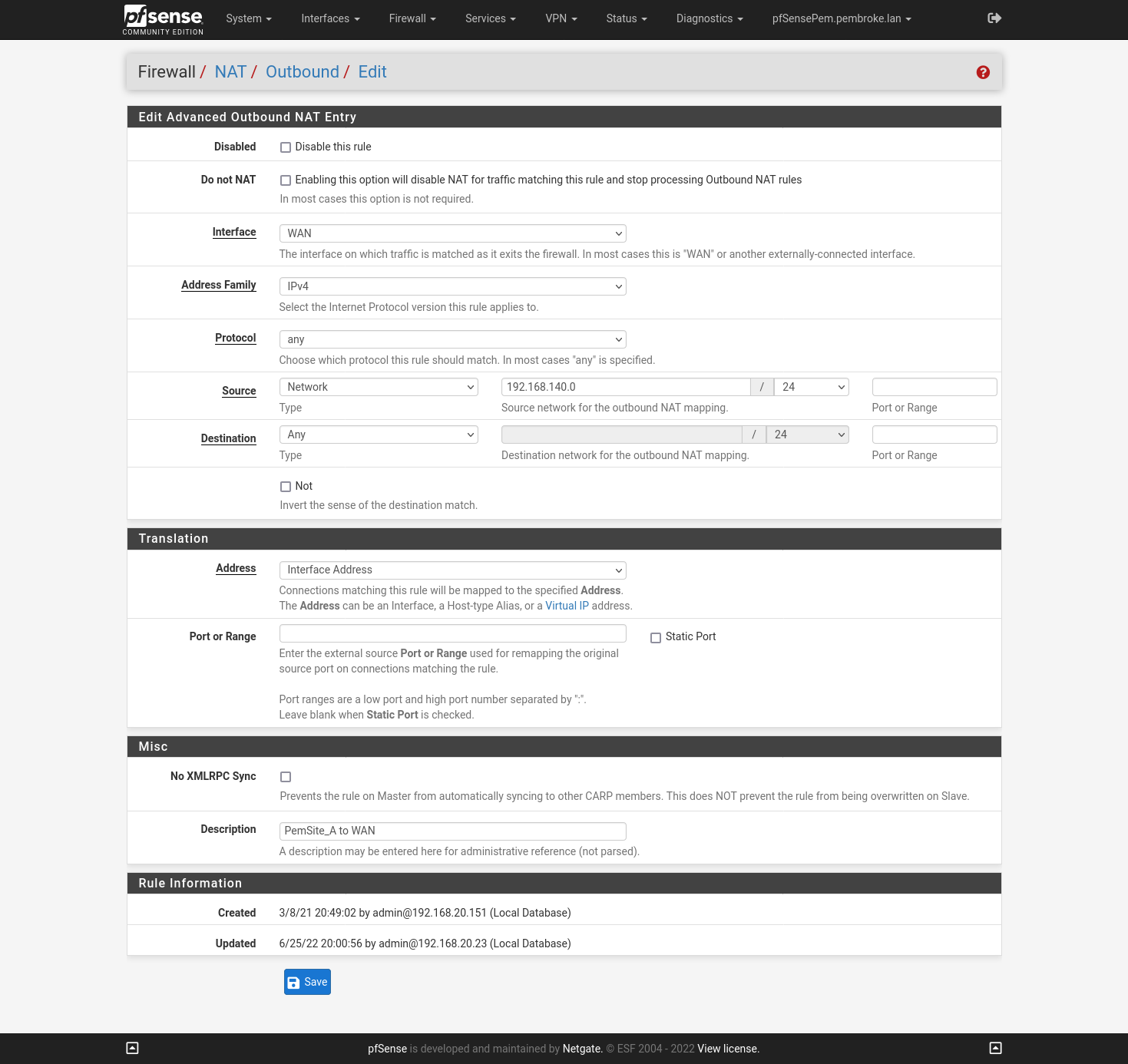

      My outbound NAT rule:

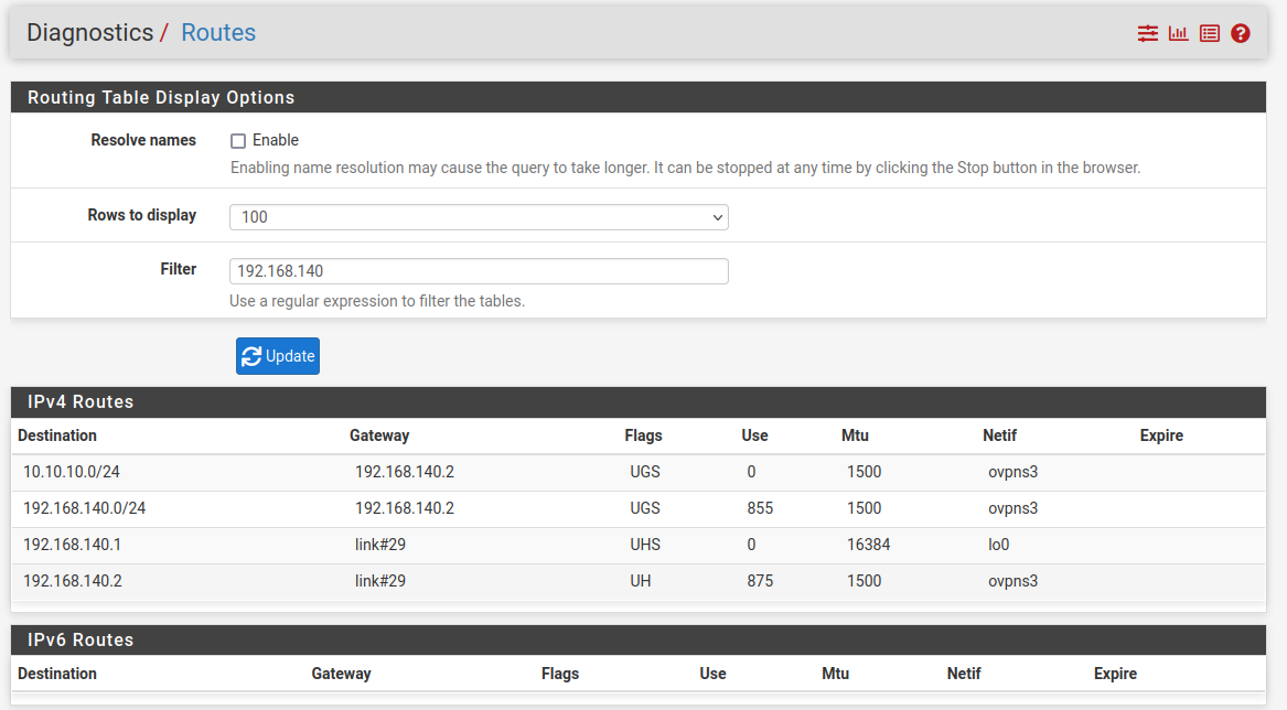

      Can’t quite tell if the route is setup correctly:

        Is there only a single client connecting to the server or multiple?
        If it's only one you should rather use a /30 tunnel network for a site-to-site VPN. So there is no need to configure a CSO.
        neogridN 1 Reply Last reply Reply Quote 1

            viragomann @neogrid
            @neogrid
            The question is how many OpenVPN clients are connecting to the server. The devices behind the client don't matter at all.
            If you have only one OpenVPN client use a /30 tunnel and remove the CSO.
            If you have multiple clients you need a CSO for each.

                  • V
                    viragomann @neogrid
                    @neogrid
                    As mentioned, when you use a larger tunnel network, you need a CSO and the configuration gets more complicated.
                    The CSO is especially needed at server site to route the clients site LAN properly.
                    If that doesn't work check in the OpenVPN log if the CSO is applied. There are often issues due to wrong common names stated in the CSO or whatever.

                      • V
                        viragomann @neogrid
                        @neogrid
                        Checked you screens again. The only one failure I can find is the source network in the firewall rule on PEMSITE_A. The pass rules only allows access for the tunnel network, but not the clients LAN.
                        However, this is also applied now when using a /30 tunnel.
                        But maybe there are rules on the OpenVPN tab allowing access to any source.
                        Remember that the OpenVPN tab is an interface group which includes all OpenVPN instances you're running on this node. Rule on interface groups have priority over ones on the interface tab. So if there is a rule for allowing any to any (default after running the OpenVPN server setup wizard), rules on the interface tabs are ignored.
                        neogridN 1 Reply Last reply Reply Quote 0
                        • neogridN
                          neogrid @viragomann
                          @viragomann actually I use an alias with my various subnets, including the tunnel subnets, so I believe it is covered. I also use an interface for my OpenVPN servers and don't use the "general" OpenVPN tab as such. That way I have some idea what is going on by doing things manually.
