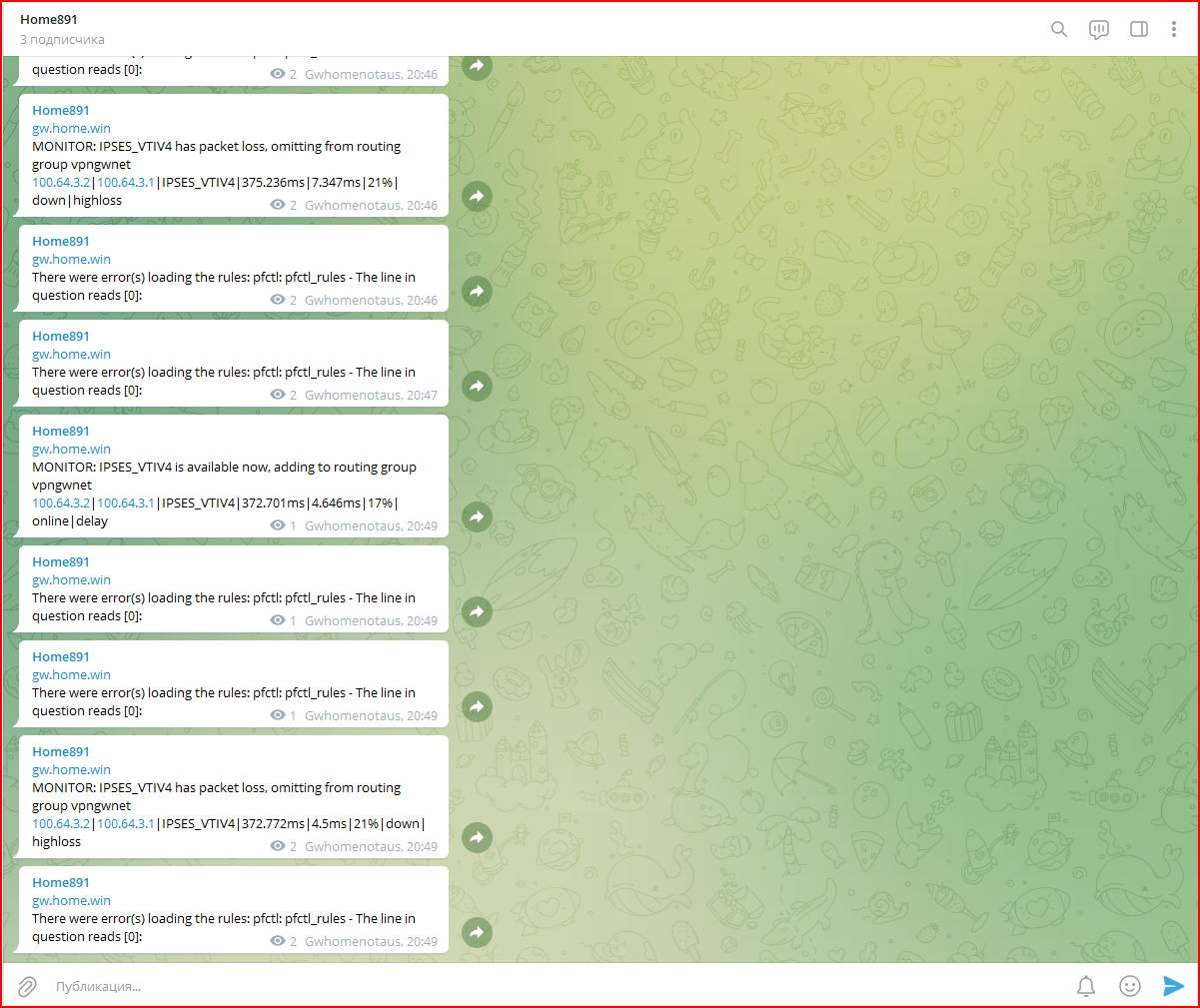

      kirrn6100
      hello everyone, my firewall just recently started spamming messages about not being able to load rules!Снимок экрана 2022-07-06 205620.png (There were error(s) loading the rules: pfctl: pfctl_rules - The line in question reads [0]:)
