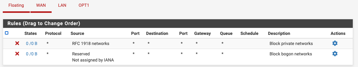

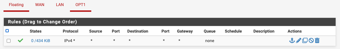

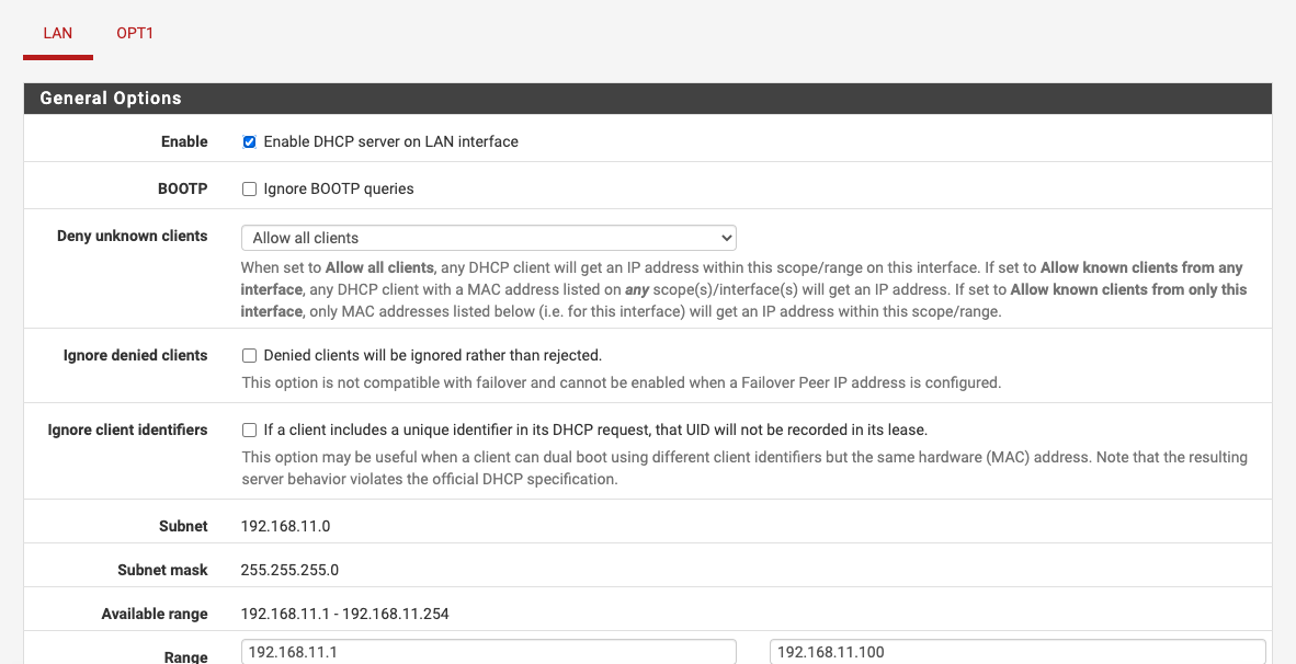

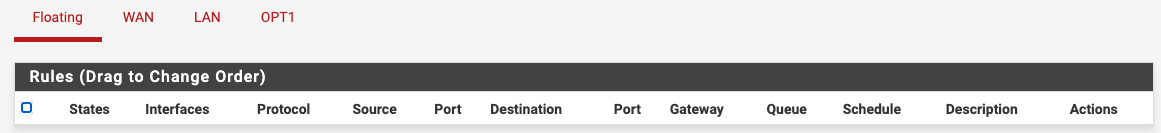

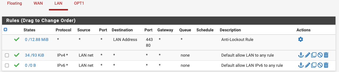

                      Posted pics above, if there is anything else please let me know as I cant seem to find the source of the error. It has been driving me nuts in fact.
                      -They are policy routing out their lan - ie forcing traffic say out a gateway or wan interface. If your going to policy route, you need a rule above where you send traffic out a gateway that allows access to your other networks.
                      {How do I see if I am making this mistake ?}
                      -Device in other network is not using pfsense as their gateway.
                      {How do you check this on Mac windows linux/Ubuntu?}
                      -And one that has been coming up a few times recently - mask has been set on client and its wrong, where the other network trying to talk to or respond too to the device is local, and therefore never sends the traffic to pfsense to be routed.
                      {Now this I really dont get, how is this troubleshot ?}

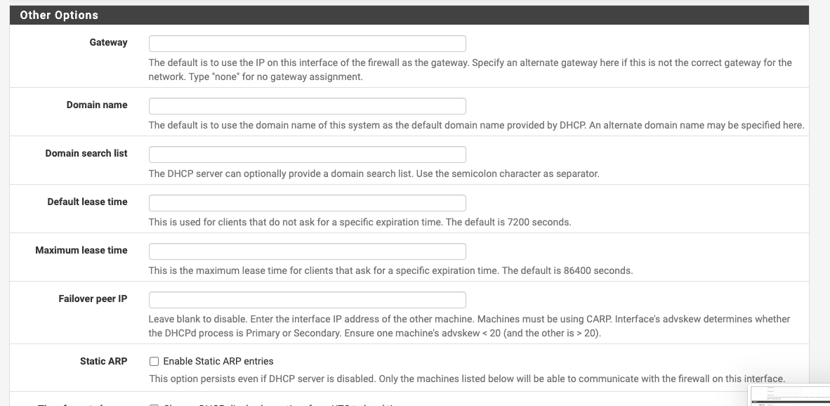

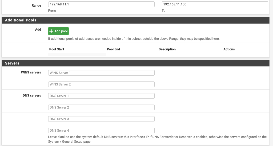

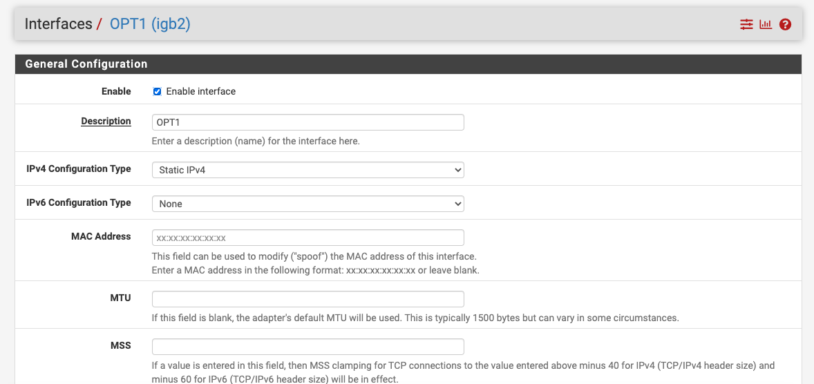

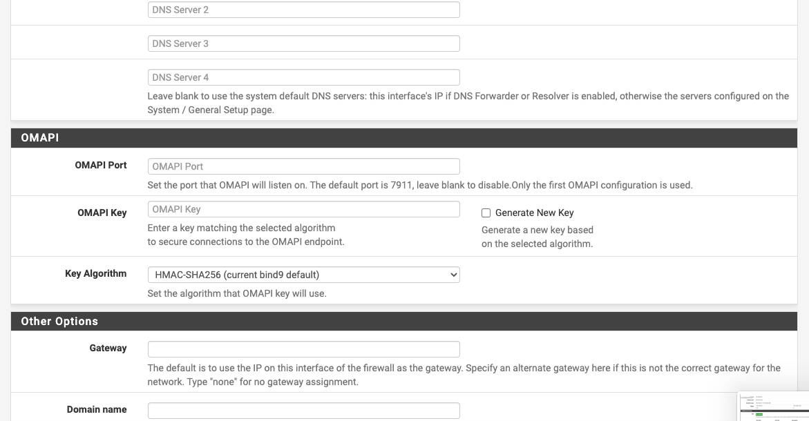

                          Sounds like I am not following the steps correctly for initial setup; gateway setup or policy routing was not something I saw in tutorials or am familiar with.
                          In my setup I used the wizard, then:
                          1. add interface for Lan + Opt1 and assign static IPv4
                          2. Add firewall "any" rules
                          3. DCHP server set ranges
                          Is there a step I am missing required to setup or configure gateways?
                          Or is it a setting on the client side that is amiss?

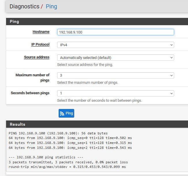

                                    edit: here you go, example from box (192.168.2.12) in one of my vlans I can ping a box in my lan.
                                    PING 192.168.9.100 (192.168.9.100) 56(84) bytes of data.
                                    64 bytes from 192.168.9.100: icmp_seq=1 ttl=127 time=1.09 ms
                                    64 bytes from 192.168.9.100: icmp_seq=2 ttl=127 time=0.795 ms
                                    I then set firewall on that 192.168.9.100 box
                                    ping 192.168.9.100
                                    ^C
                                    --- 192.168.9.100 ping statistics ---
                                    8 packets transmitted, 0 received, 100% packet loss, time 7165ms
                                    If I sniff on the lan interface while pinging from the vlan device.. You can see pfsense sending on the traffic
                                    The problem is not pfsense routing or allowing the traffic - its just that the device is not answering..
                                    Even with the firewall on the host, pfsense can ping it - because pfsense is pining from an IP on that lan interface (192.168.9.253) Which the host firewall allows ping from its own local network, but not from a remote network (192.168.2.12) in my example.
