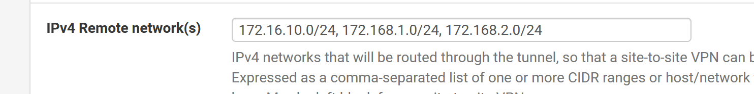

      On one network (server) we have ; 172.16.10.0/24, 172.168.1.0/24 & 172.168.2.0/24 and on the client end there is 172.100.100.0/24
      The client end remote network box looks like this :
      Until the upgrade the client could access any device on any one of the three networks on the remove (server) end.
      Now it can only access the first subnet 172.16.10.0/24

          It seems that after upgrading to 22.05 you need to specify the remote network(s) on the client side. Was not necessary before.
