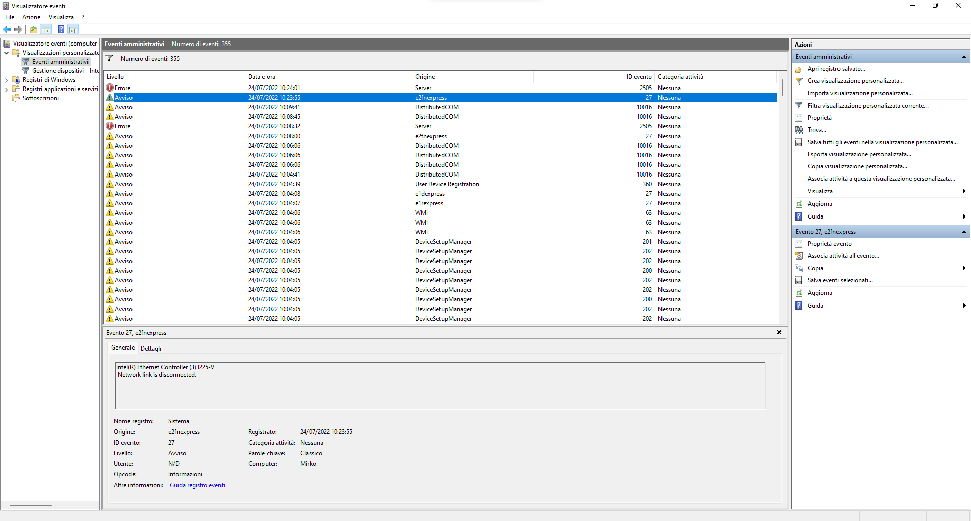

                    When it happens, a new "Collision" is added to the counter on "Interfaces" tab, and then on my Windows PC I have this error:
                    Obviously, in the 3-4 seconds that pass from disconnection to reconnection, nothing works.
