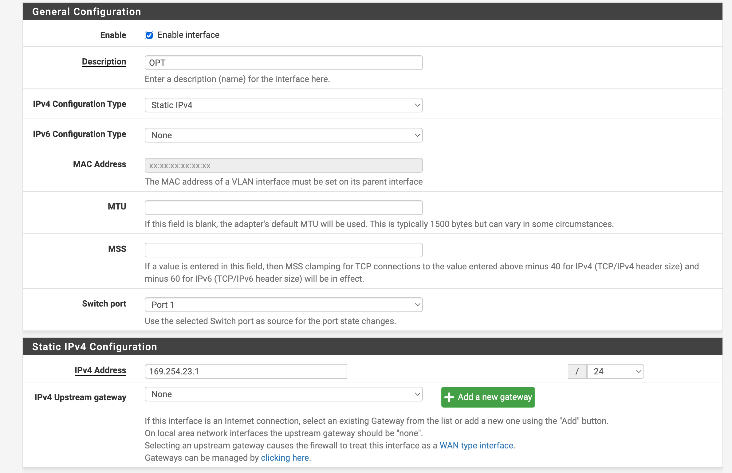

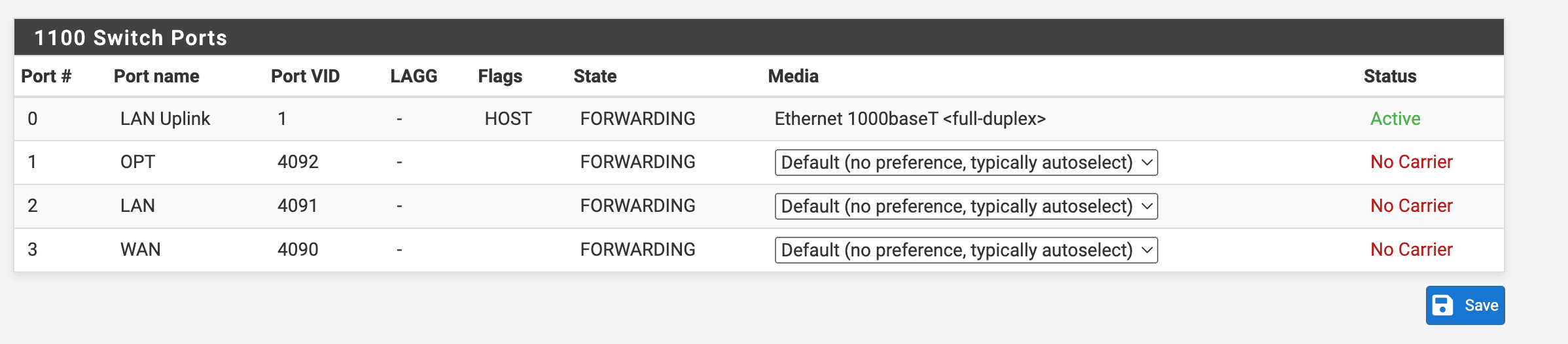

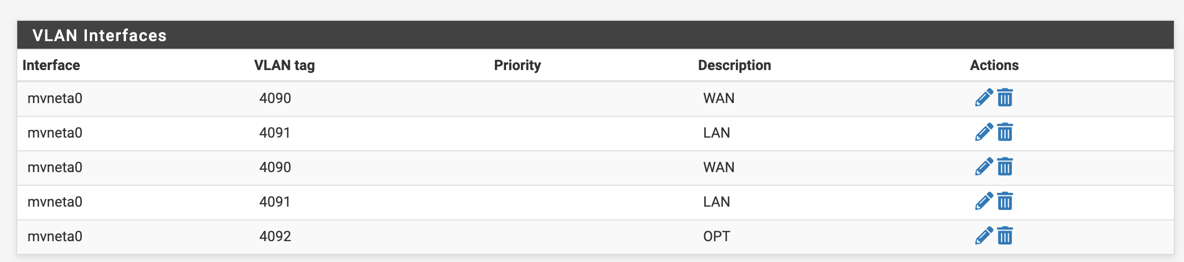

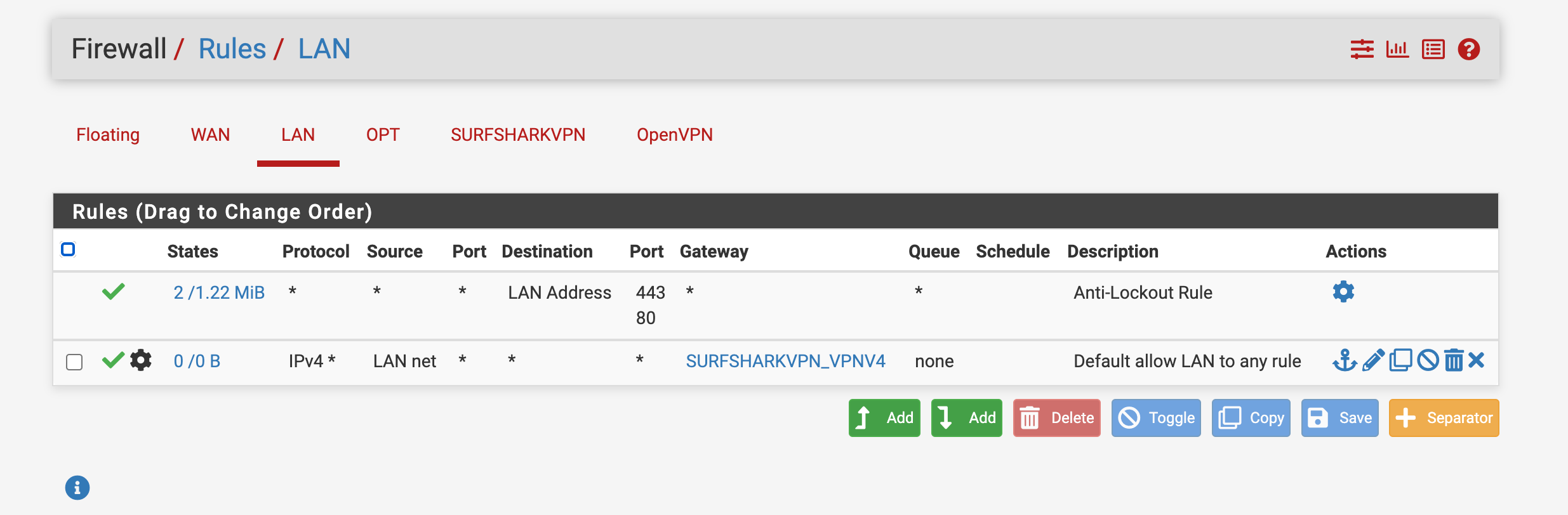

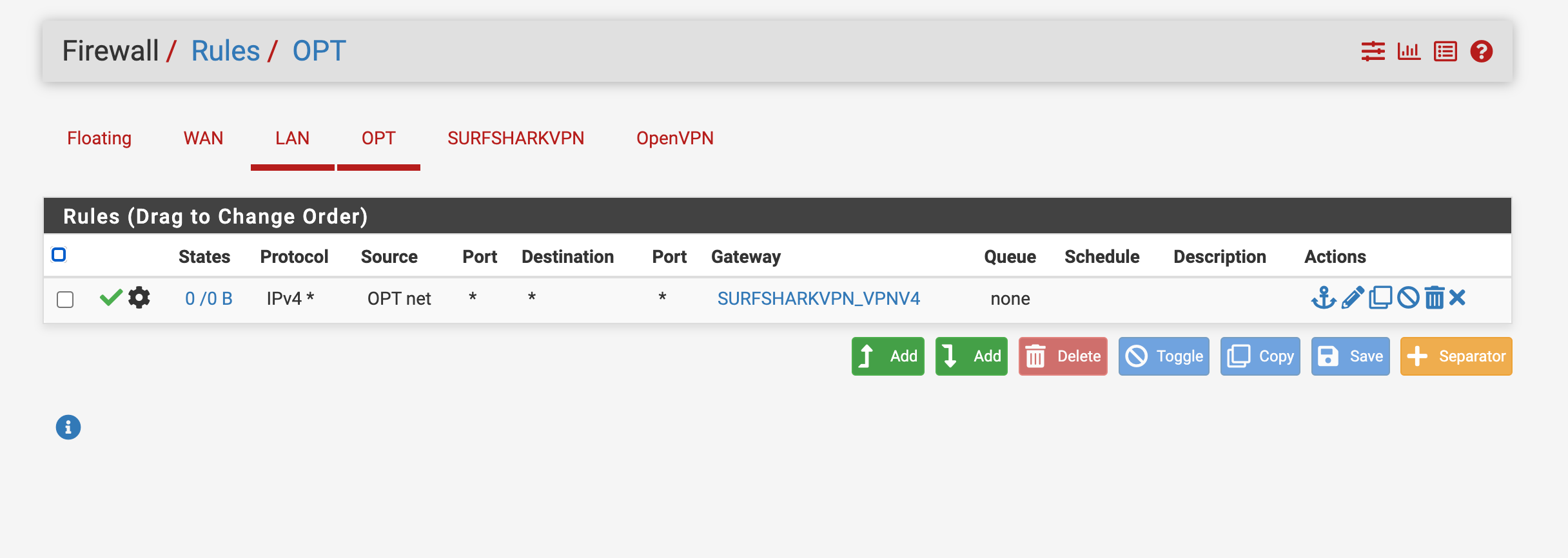

      I am trying to setup VLAN's on my PfSense and for some reason I'm still not receiving a connection to the internet. Tried a lot of different things now and couldn't figure it out after reading and learning.
      I have followed the following guide to setup my OpenVPN and if I am right it automatically created VLAN's for me.

      What makes my PC unable to connect through the internet on it's own VLAN? The OPT1 port does not get a correct lease but the LAN port functions perfectly without problems.

        Jarhead @MannenOR
        @mannenor look up APIPA.
        Those addresses aren't routable.
          MannenOR @Jarhead
          @jarhead Omg... Thanks sir ๐Ÿ™ should've checked the IP table before.. It's working correctly on the correct subnet now! You made my day sir.
