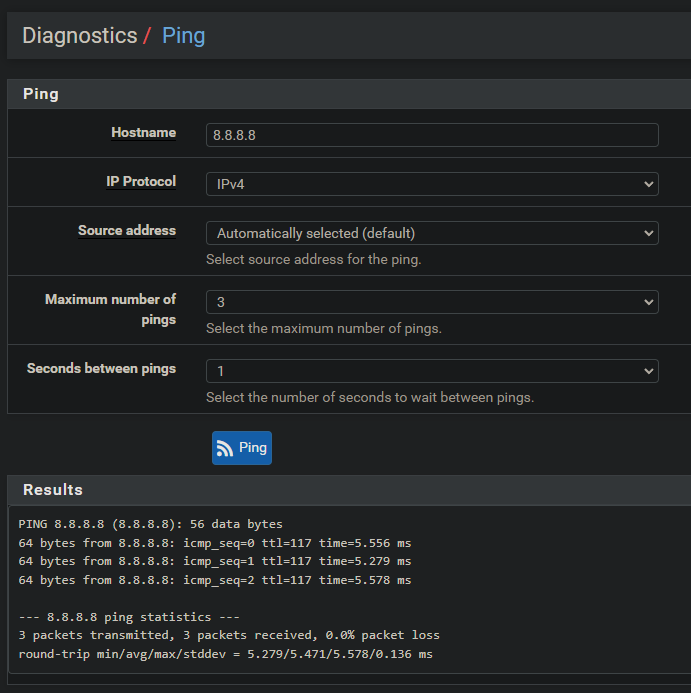

 Is your pfSense able to reach anything in the internet at all?
 For instance, when you ping 8.8.8.8, do you get a response?
 Yes. Ping works when Source address is set to Automatically selected (default), LAN, WAN, and out the NordVPN interface I created following the previous instructions I mentioned.

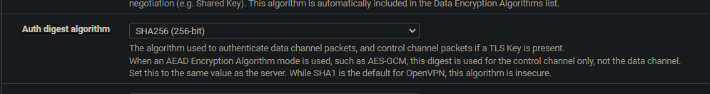

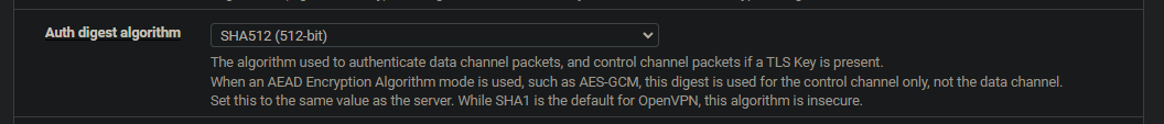

 @bob-dig So I went through the setup a third time and was taking screenshots of each step. As I was adding the OpenVPN client I noticed that I had the wrong 'Auth digest algorithm'...  I corrected this and finished the config...  Now it works...  That's what happens when you just don't pay as close enough attention to detail as you think you did. Thanks everyone for your responses and for trying to help.
 @mradell said in NordVPN using OpenVPN not connecting: That's what happens when you just don't pay as close enough attention to detail as you think you did. Happens to all of us.
