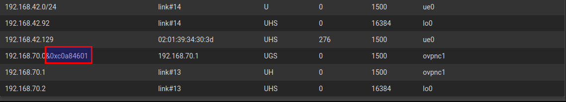

      This is a picture of the route on the server side of the VPN
      The 192.168.70.1 ping here but not the 192.168.70.2
      The ip 192.168.70.2 is the client side tunnel gateway
      like you can see the route of the networks point to 192.168.70.2 which doesnt ping
      shouldnt they be pointing to 192.168.70.1 ? would make more sens if the gateway of these subnet is actually the gateway of the server side VPN tunnel but i could be wrong

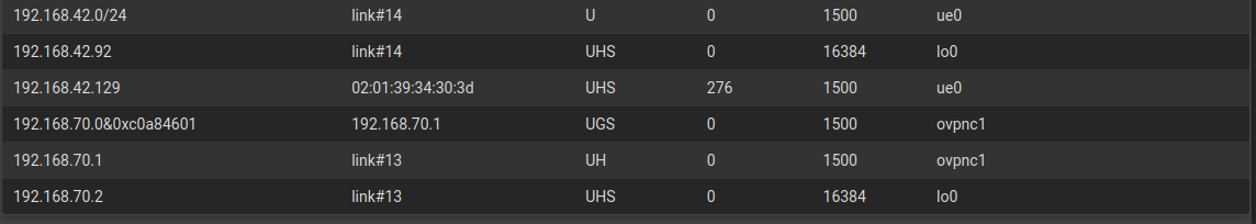

      And this is the client side vpn routing table
      192.168.42.92 being my WAN internet IP and 192.168.42.129 is the gateway
      this can be ignored so far.
      What i don't understand is that no subnet route is generated here like it should by the openvpn configuration like we see on server side so how it could be possible to 192.168.10.0/24 to actually be routed into the tunnel .
      And again 192.168.70.2 ping well here since its the local gateway on the client side but impossible to ping 192.168.70.1 from 192.168.70.2
      In this picture we can see the wanna be route for the tunnel subnet 192.168.70.0/24
      but instead OpenVPN create a broken route
      So any idea how to fix this cos the route are auto generated by the UI configuration of OpenVPN and i cant find how to rewrite or fix the routes

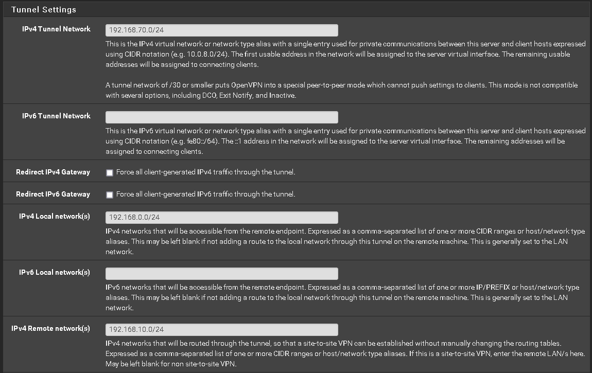

        Jarhead @Nerigal
        @nerigal First off, if it's a site to site you should be using a /30, or /31, for the tunnel. Change the tunnel address to 192.168.70.0/30.
        Then , post screenshots of your OpenVPN config.
        You probably have the local and remote networks sections populated incorrectly.

          here is my server side Tunnel config
          This is the client side Tunnel config
