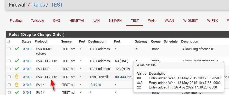

                  Sure you can, that is just an alias of the destination IP, you can set ports on that.. So it can be used as example to block access the web gui ports and ssh.
                  Also you put what you want to allow before it, then just allow the block to anything else to this firewall.
                  example this allows ping, dns and ntp to the pfense IP on that interface, and then the this firewall blocks any and all other stuff to any pfsense IP
                  Here its edited to block only access to gui ports via a simple ports alias.
                  If you want to block just ports, you would have to change from any on the rule to something with ports tcp or udp or both tcp/udp
